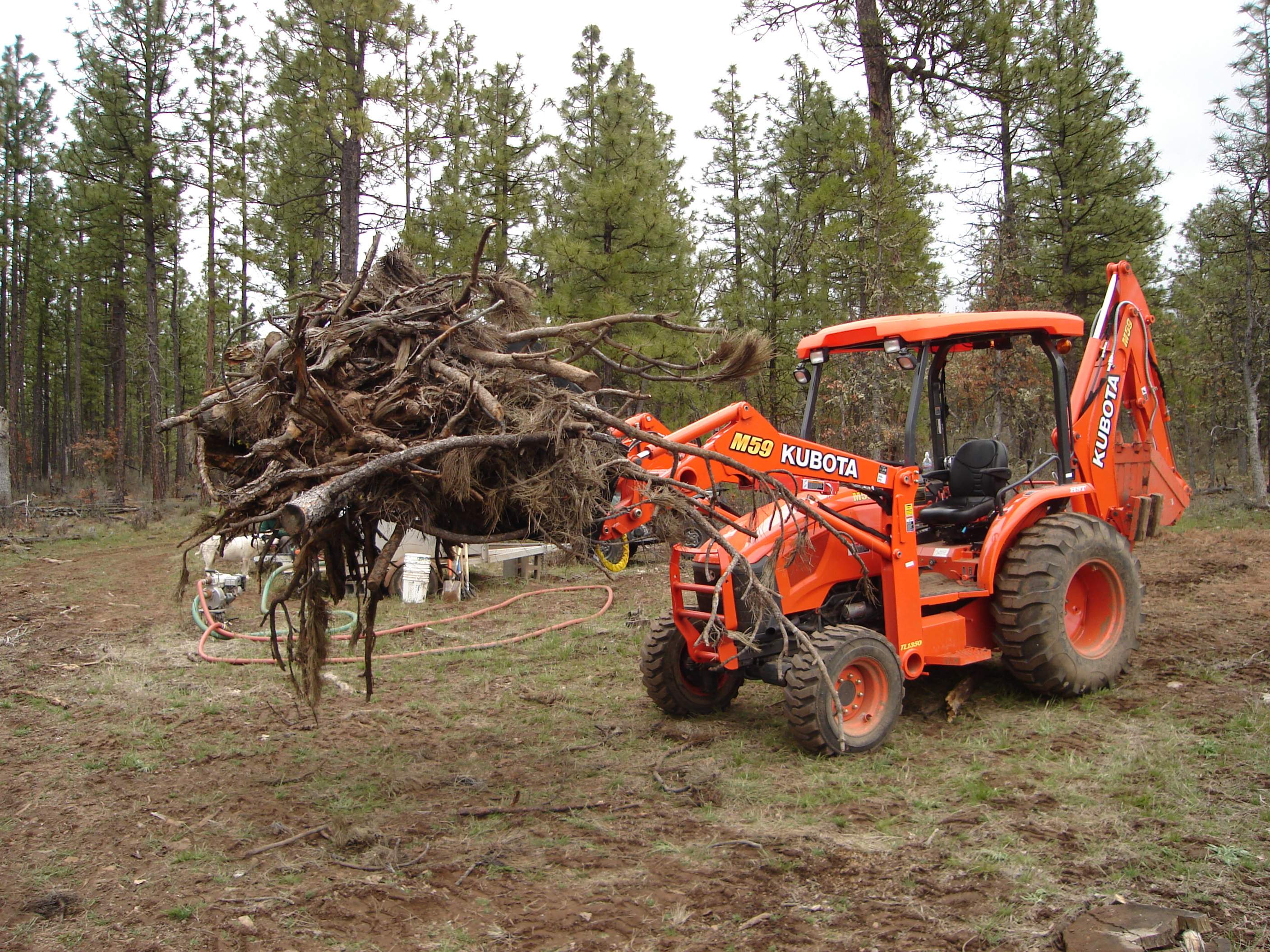

When I collect firewood I cut it into measured 8 foot logs and then transport a bunch at a time to my trailer with my loaders grapple. Once I have a load piled at the trailer, I take two good sized logs and lay them side by side and cut a shallow saw curf every 16 inches across the tops. I then lay the third on top of them and I have a very quick visual cut reference.
Advantages: fast sight acquisition; higher cutting height,easier on my back; no worry of putting my saw tip into the dirt; no apparatus sticking out of my saw.
I set up right behind the trailer and the wife can throw it in as fast as I can cut it. The 8 foot dimension makes for easy cord calculation and straight stacks.
Don't have any pics of the firewood, just the slash clean up.
