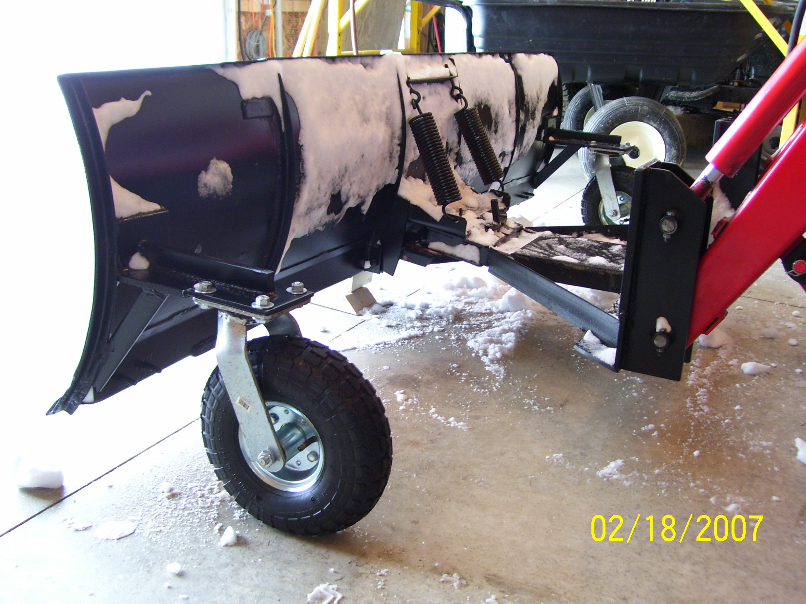

My plow has this pipe, and pneumatic casters in place of shoes.
The plow rides primarily on the casters....
Did you find these somewhere, or was it something you made? I'd like to be able to swap out my shoes and slide in casters, but haven't found any that would fit.
   / cut pipe for plow cutting edge #38
I ordered the casters online somewhere, (don't remember where), and made the mounts myself.
You can't just swap them, because the casters need a lot more room to swing around. There also needs to be sufficient clearance between the plow and the tractor when it's angled, to leave room for the caster to swing.
The last thing I did to it was change the for the plow from a rigid mount to a hinged one, just like it mounts on a plow truck. That allows the plow to float up and down some.
The loader arms stay fixed, and the plow rides on the casters.
The bucket tilt cylinders allow me to set the desired height for the blade. Because, in the mounting hinges I put a stop to control how far the plow hinges downward. That way, I can keep it above the gravel, or set it down on it. The lower limit stops work to set the height the same way the chain does, that lifts and lowers the plow on a truck.

OK, thanks. I guessed you likely must have made something up. I may have to figure out a way to do that myself....
   / cut pipe for plow cutting edge #40
In case you haven't seen what they look like on my plow:
