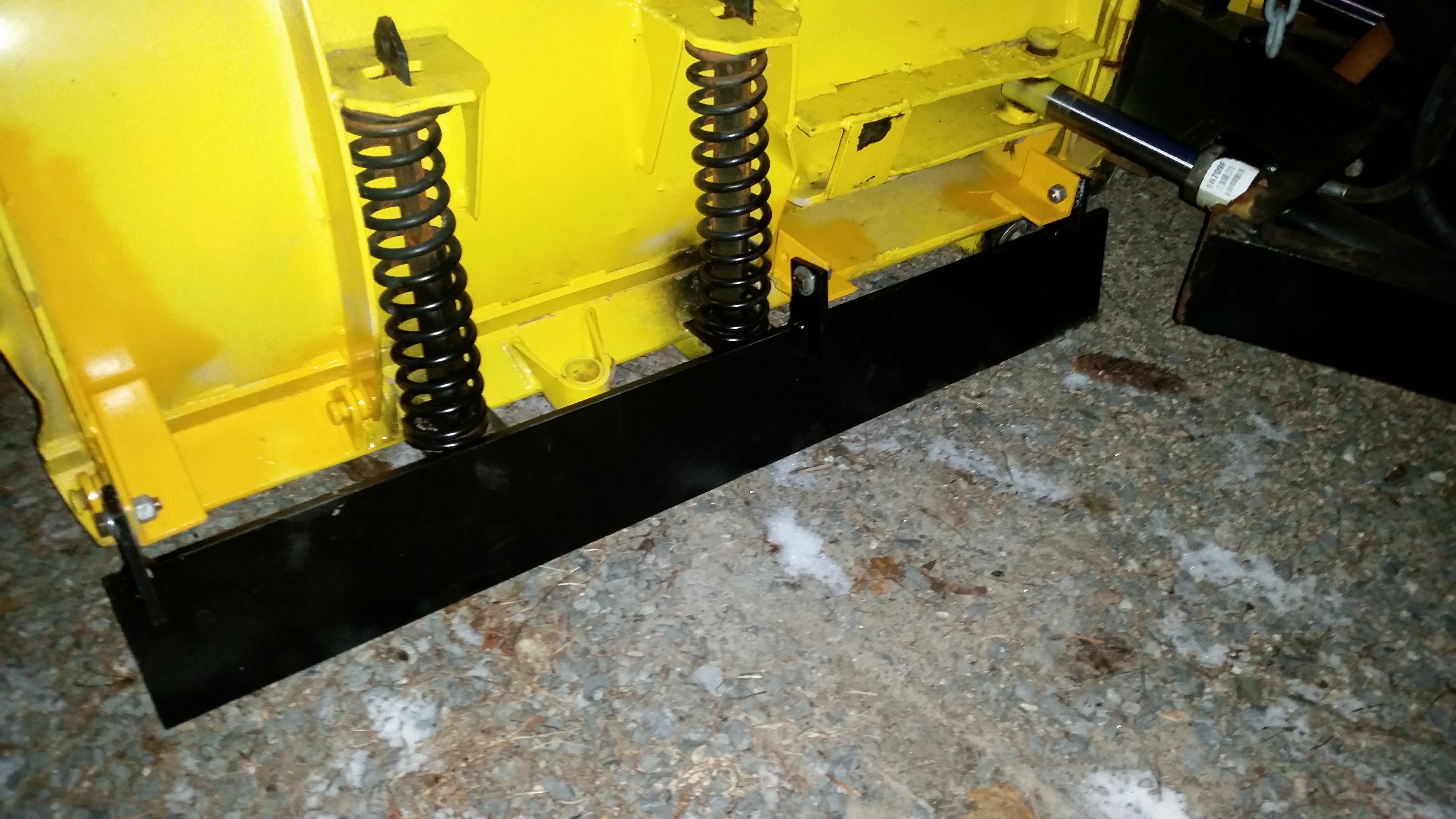

In case you haven't seen what they look like on my plow:
Thanks again. I would like to do something to have gauge wheels added on mine, so this gives me ideas. I've also searched and found some threads on here with various ways folks have done similar, including yours.
I don't have fabrication capabilities, but there is a local shop. I'll have to run some ideas past them, and I think pictures of other solutions will help...

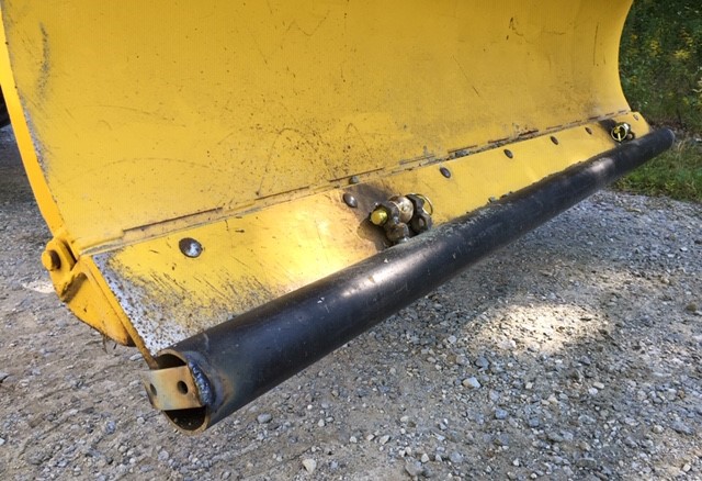

Resurrecting an old thread to show the slotted pipe I added on my 8’ Fisher Speedcast Plow. I have loose crushed gravel on my driveway and hoping this will help keep from digging in before the driveway freezes. It is a 3" pipe with a clevis style point of attachment so it is easy to remove once everything is frozen and ice covered but also easy to put back on for the late spring storms when the ground has started to thaw.

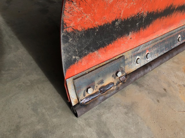

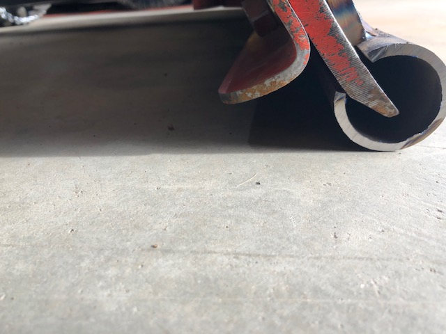

Just reviving a not too old thread. Finally got round to it. Did the pipe on the blade cutting edge thing. 1 1/2 inch sched 40 pipe, sliced out a strip to slip over the edge and bolted on. Figured that was the best way to support the pipe over it's 87 inch length. Initial testing lets me float the loader without tripping the blade. The next snow event will tell.

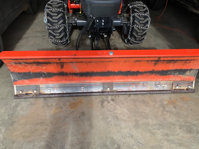

I finally added a metal tube to cutting edge on my L5240. Thought I would share some pics. Have not had a chance to try it out.
Used an old Jepson hand dry cutter - looks like a circ saw but cuts metal to slice the pipe - if you get a chance to find one of these used they are great
I have pretty thick steel for tabs - just cause that's what was laying around and about the right size. Tube was also something I found not really sure what it is.
Got a quarter mile of dirt road and a quarter mile of regrind at the house and was tearing up the horse mats I was using as rubber blades too often so decided to try metal.
