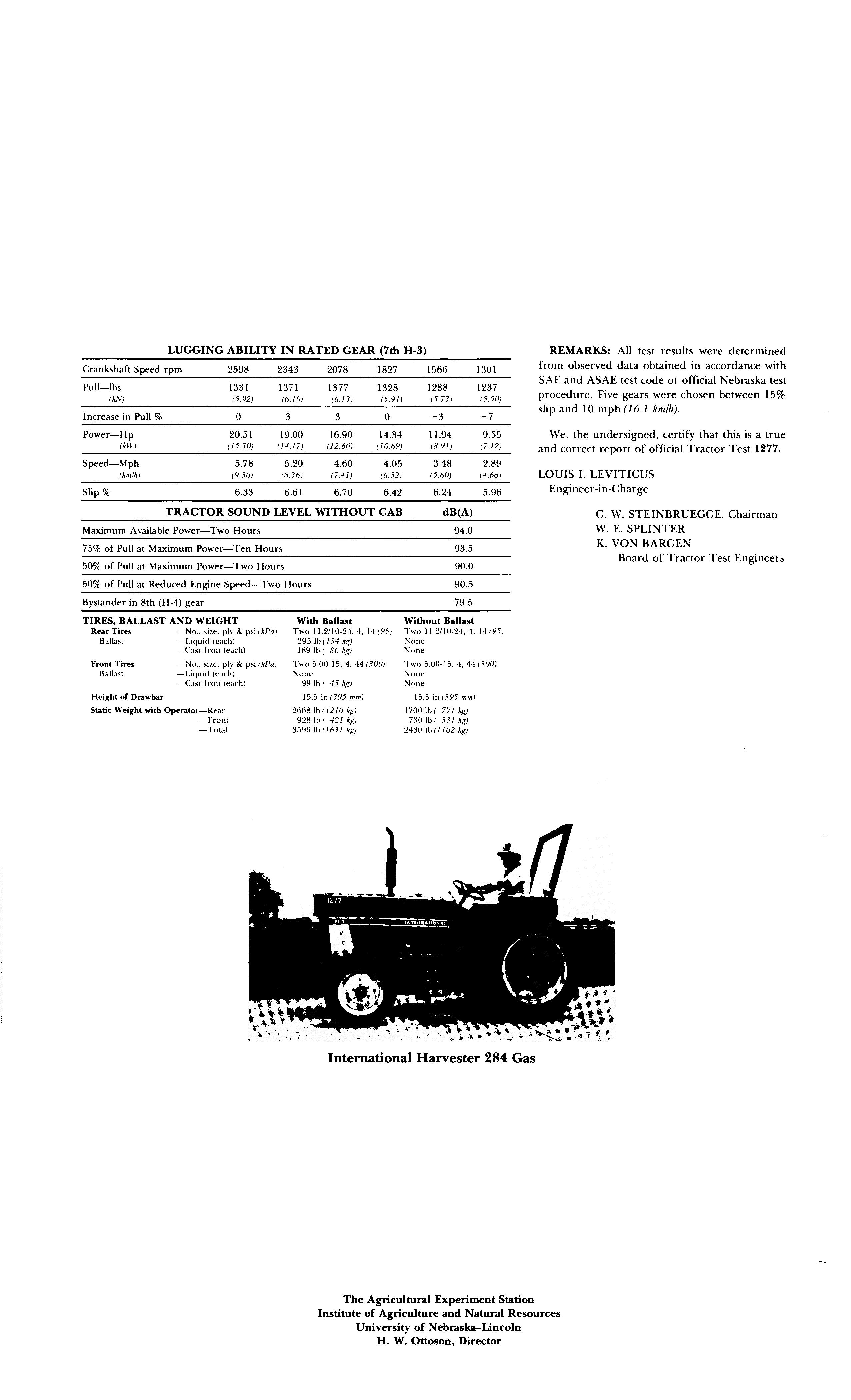

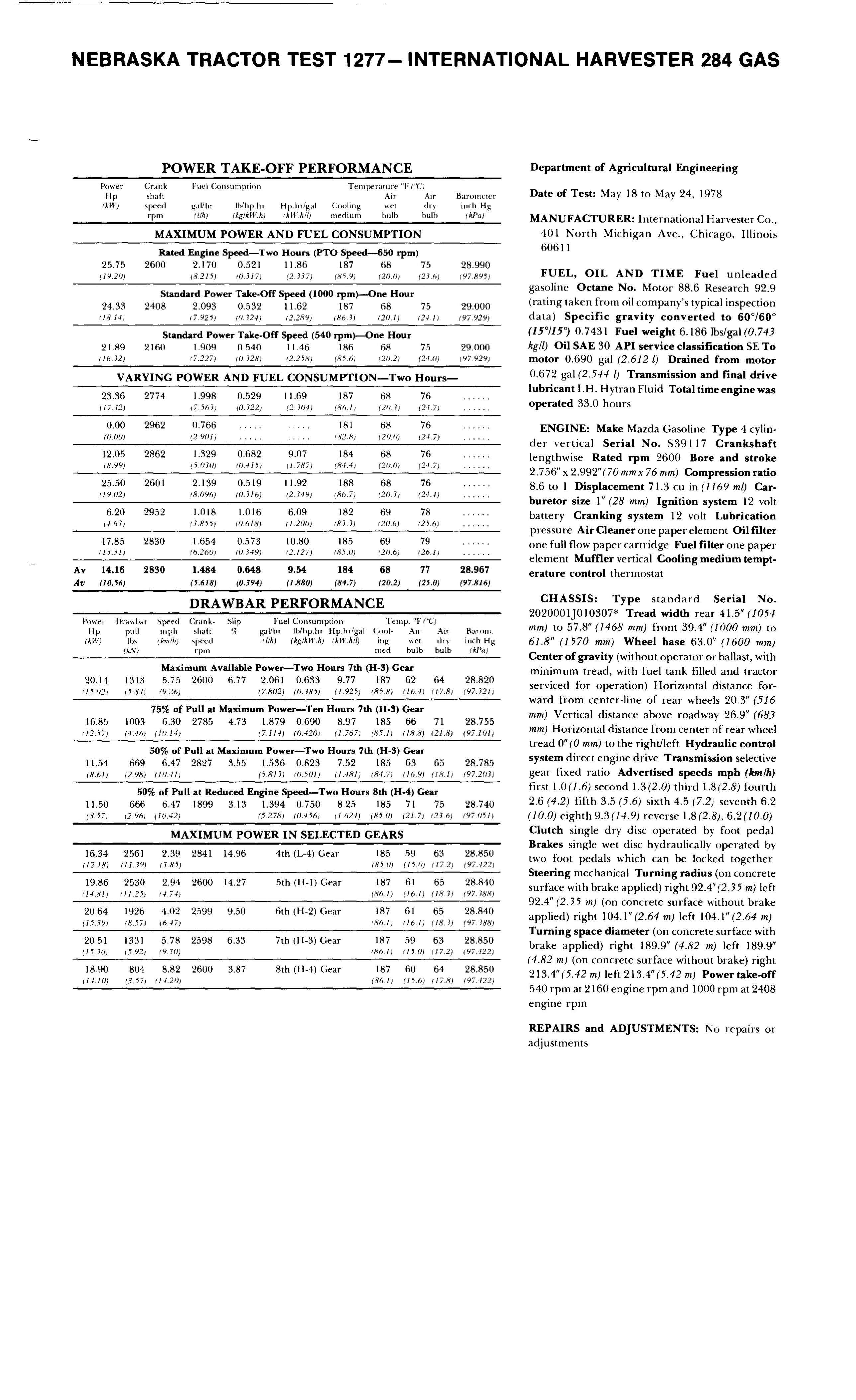

For the Nebraska tests, at least in the older ones I'm familiar with, full load is rated RPM (or peak power RPM if higher) and maximum load that can be sustained at that same RPM. Attached is the version for my IH 284. There is a section called "VARYING POWER AND FUEL CONSUMPTION" where you can see they run the machine at 0 horsepower, and 2962 RPM, for a certain fuel consumption per hour. That is how much fuel it takes simply to run the engine at nearly 3000 RPM, with no load. Just above it is a rating at 23.36 hp at 2774 RPM, so the engine is applying 44 foot-pounds of torque to a brake at that RPM (Technically it would be much higher torque applied to the brake, somewhere around 200 foot-pounds at whatever the PTO shaft speed is, but it's all the same)
Really, it is the maximum output of the engine. So if cutting in heavy grass can achieve that, it is full load. Data I find especially interesting is the horsepower-hours/gallon. It measures the efficiency of the engine at turning some amount of fuel into power. A bigger number is better in this case. It allows comparison of small, lower horsepower engines to bigger ones, because it is a measure of efficiency, not only quantitative data. I wish this information were available for newer compact and subcompact machines.
