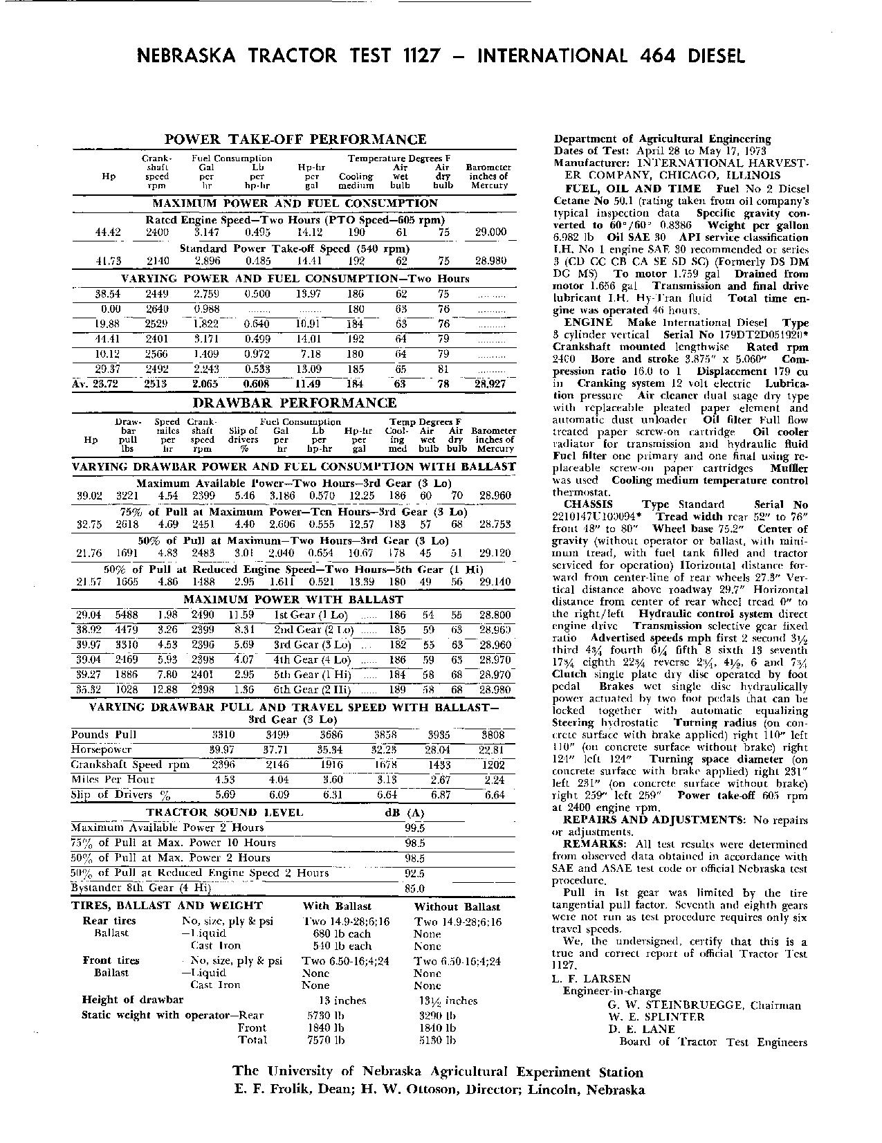

...Engines are inherently more efficient when operated closer to full throttle (less pumping losses past a partially closed throttle plate)...
The diesels in our tractors don't have a throttle plate, though. But still, generally, it will be more efficient to run a lower powered engine at high fractional power loading than a high powered one at a lower setting.
Let's say I have a load that will take about 10 horsepower to run. I have a choice of my diesel IH 464 or my gas IH 284, rated about 45 and 25 PTO horsepower respectively. The presumption would be the diesel engine would use less fuel, since it is diesel, and, with such a light load, will loaf along. The data show differently. (Attached is the 464 test; the 284 test is above)
The 464 burns 1.4 gallons per hour to make that power, and is producing 7.18 horsepower-hours per gallon. The gasoline 284 burns 1.3 gallons per hour to make little more power-12 horsepower, and makes 9.07 horsepower-hours per gallon of fuel. Running the big diesel at 44 PTO horsepower, though, burns only a little over 3 gallons per hour, more than quadrupling the power for a little over twice the fuel consumption, and it produces 14 horsepower-hours per gallon of fuel.
This shows the importance of having well-matched implements and tasks to one's machine. It would be more efficient to run a heavier load on the bigger machine than it would to let it loaf in front of an undersized one. With that said, there are many other contributing factors to overall efficiency, but in purely mechanical terms, it is generally more efficient to operate at a higher percentage of output than less.

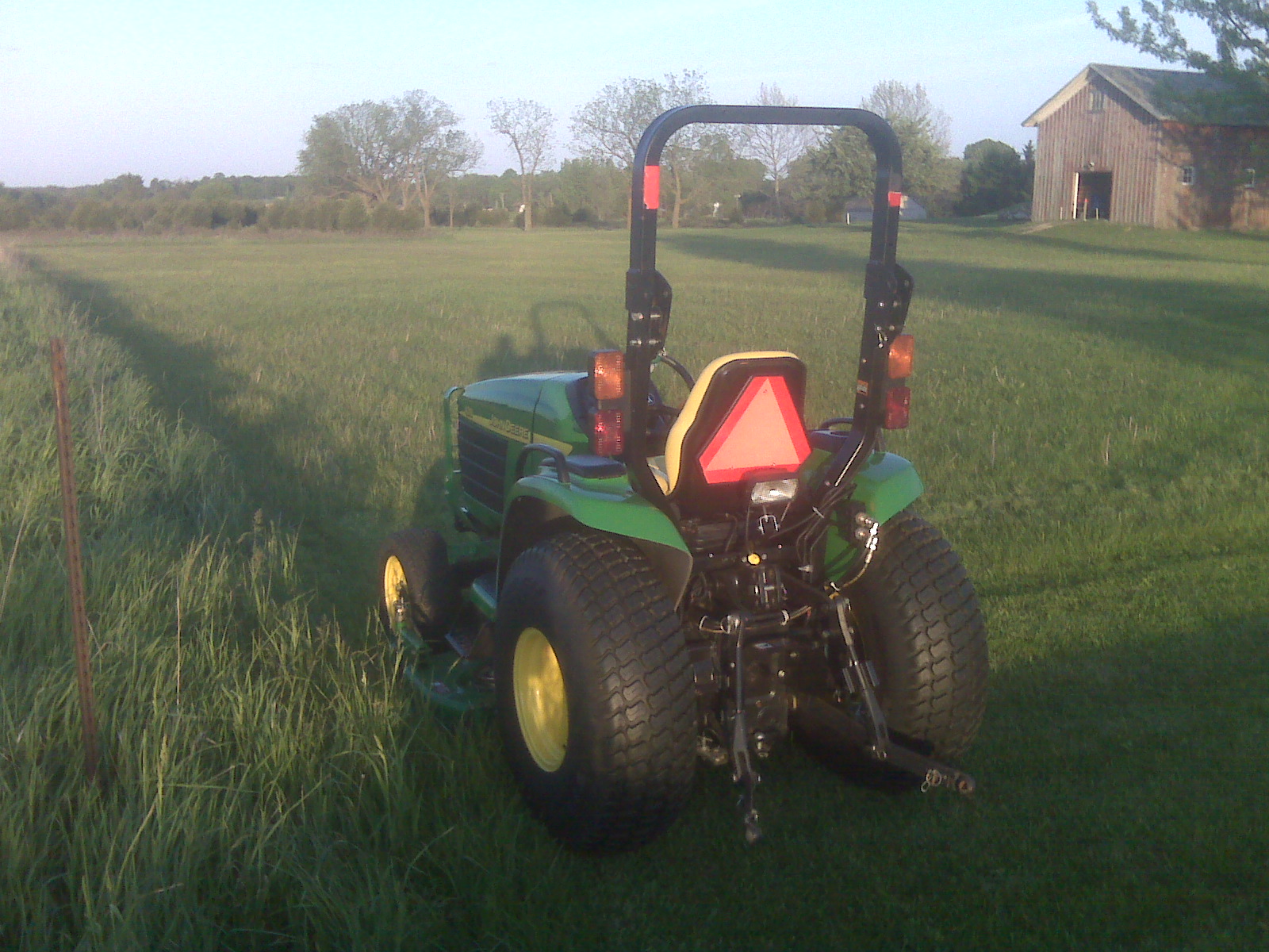

I put about 90-95 hours a year on my Deere and about 80% of that is mowing which I have calculated as burning close to .625 gph @ $4 per gallon which is about $240 a year. For the amount of work my tractor accomplishes for that much cost for fuel...heck, my NEWSPAPER costs more a day than my Deere does to operate and the paper doesn't put a big s*** eating grin on my face when I open up the barn and admire my toy...
