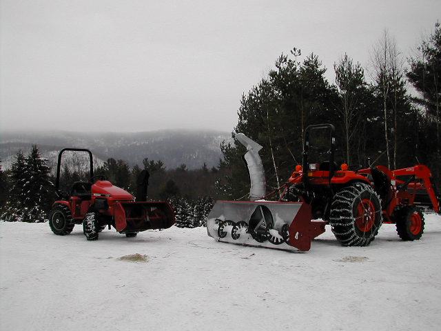

As you can see by the picture I have both front and rear blowers on my tractors.I found the RM no worse than my FM blower as far as snow blowing back in my face.I seem to get less with my RM,but no matter it all depends on which way the wind is blowing.I also wear my snowmobile jacket and pants,but I haven't tried wearing the helmet yet,although I have thought about it. /forums/images/graemlins/grin.gif

Interesting setup you have there, mgrick. If you were starting over w/ a new tractor and needed to get only one blower ...which would it be? Front or rear?
I've got a TC24D w/ FEL that I've been using to clear my driveway but that's a mightly slow process and can easily take several hours depending on the dump. I've noticed the cost difference, see that looking backward would seem to be a hassle ...but is that something that's fairly easy to get used to? My driveway is about 300' long w/ a pad at the bottom that gets cleared as well, and it's steep.
   / CUT Snowblower: Front, 3pt, or FEL mount? #20
Legion...I used the 7' RM for the first time and it didn't bother me to much,it's a little different having used the FM for the last 12 years.I've got an 800' driveway plus the front of the house and it made short work of it.I still need the smaller Honda to do around the lawn and down into the drivein basement were I keep it.The 42" blower on the Honda used to take forever to do everything and it seemed funny to use it after using the bigger 7' blower.I was lucky and got RM blower from a guy down the road from me for 400.00.So I wasn't about to pass it up.I also like having the loader on,it works good for moving the plowed in slush at the top of the driveway.But I guess you could get a rear blade if you went with a FM.Basically at this point I don't mind using a RM blower,the cost difference alone for a tractor like my Kioti made up my mind to go with a RM.
