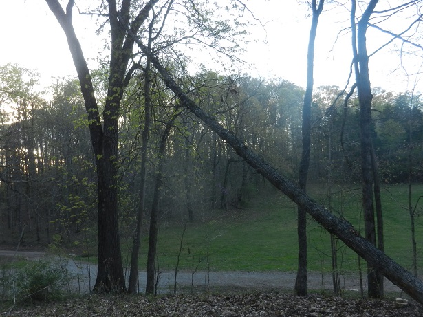

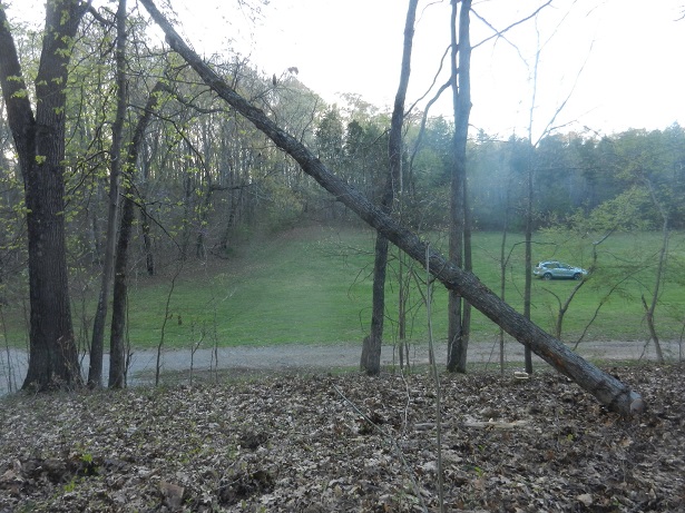

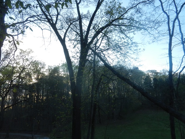

I took a couple quick pictures so you're not totally blind.
It's higher than it appears as we're on a slope and the BIG tree is at the very bottom.
Just spoke with my wife's cousin next door.... he's game to give this a whirl in the morning.
Logic (mine) is again: His smaller backhoe attached to butt of tree pulling it away from the crotch.
My (industrial) trying to hoist said tree and "crane" it out with him pulling.
Personally, I've got a decent feeling that this is going to work and will be relatively safe.
Here are some quick shots.

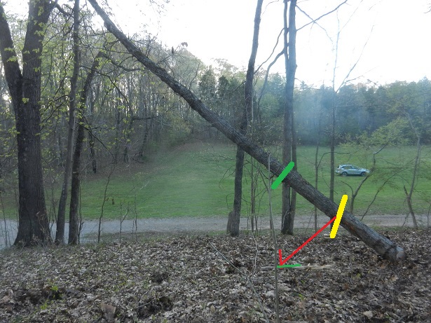

I also have trees with friends that don't let them fall. Most are < 20"DBH, their friends about 24" and up..
I usually do a gradual trim.
See pic
I first CAREFULLY cut off as much as I can easily reach on the bottom. Make sure you have clear room to run. A battery operated chainsaw helps because when you stop it you can hear cracking. So I cut a wedge on top about where I drew the yellow line. Then I undercut until it creaks and either finish it off with a yank with a chain or a top cut.
Bottom drops down to where arrow points.
If I can't pull the shortened piece then repeat procedure to take out another chunk
That usually gets it to where I can pull it with my tractor.
Best to try with 2 chainsaws in case one gets stuck.
Good luck.
