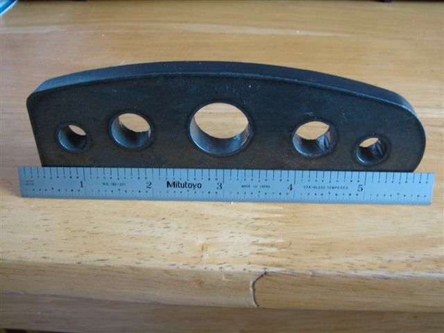

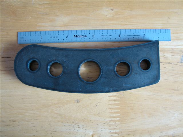

I'm also going to remember to use my old Brown and Sharp scale in any future pictures!
