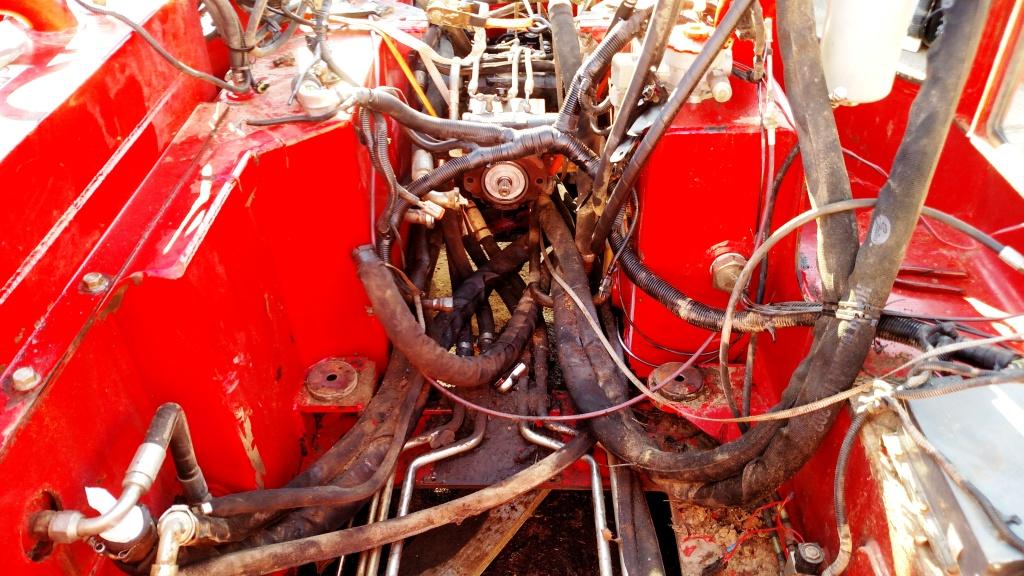

2) Take the time to remove the overhead oil cooler and cab assemblies. Getting the oil cooler & fan lines out of the way will add a little working room that will make a big difference. Old copper phone main line with multiple color coded wires are great for marking matching hose connections.

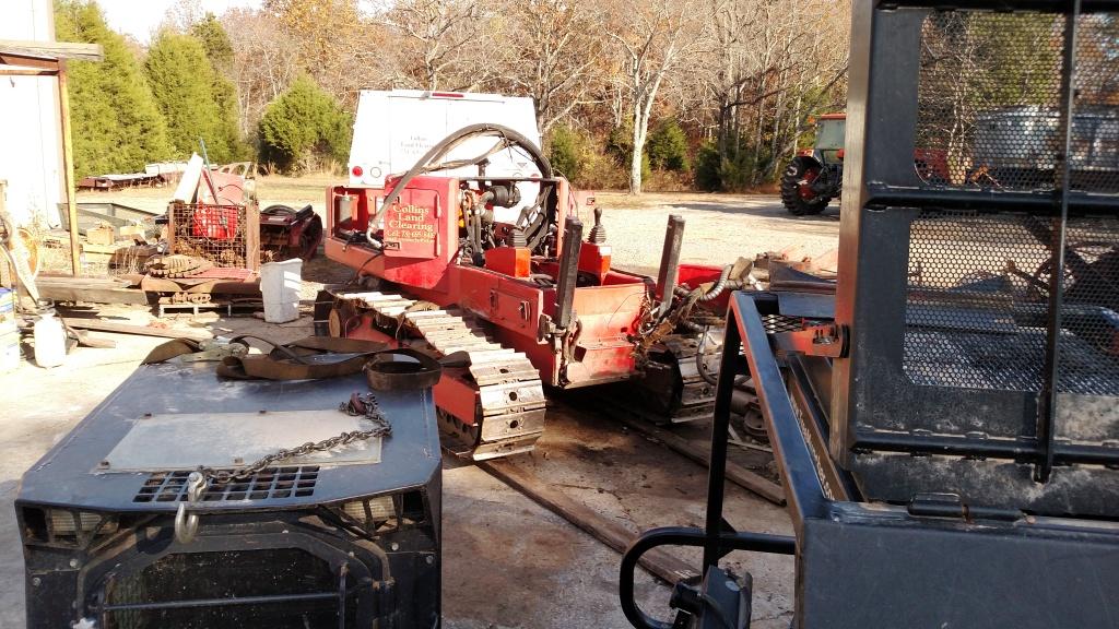

3) The engine and main mulcher pump CAN be pulled together without removing the rear sheet metal parts. The engine/pump will need to be rotated 90 degrees once high enough to facilitate removal. Crow's foot wrenches, short box end wrenches and curved distributor wrenches make some of the connectors easier to remove. I did NOT break any of the track drive lines apart - there was no need to open that system and risk contamination the way I did my engine removal. All hoses from the mulcher pump can be removed with the exception of the 2 lines going to the filter - cap and plug those 2 at the filter connections and leave connected at the pump until pump is out of the machine.

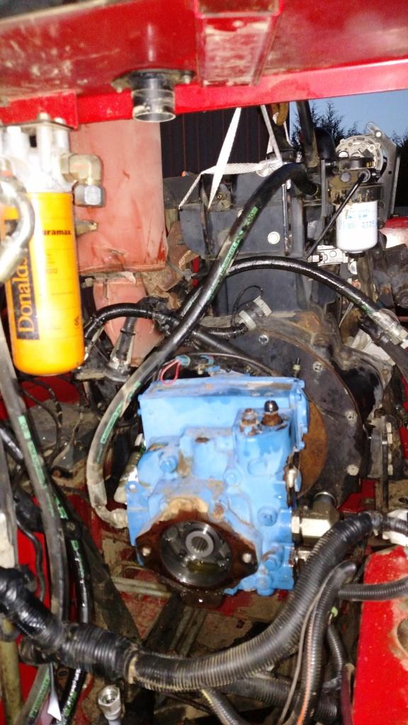

4) Be sure to support the track drive and pilot pumps before removing the mulcher pump/engine assembly. A couple of well placed ratchet straps are perfect to hold everything in place. Once enough slack is taken up on the straps, remove the two bolts holding the track drive pump to the mulcher pump and pry apart. Be sure to adjust straps to keep pumps in normal position and then remove engine/mulcher pump assembly.
