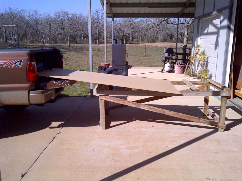

Working on site the track saw would be a good choice.
Working at home with small space again the track saw. Couple of sawhorses with 2x4 support for sheet goods set up outside
Large shop and a properly equipped & sized table saw should also do.
Short of space & funds a Skilsaw and clamped board works. ( what I've got to do )
It all depends what is needed with the space tools at hand.
