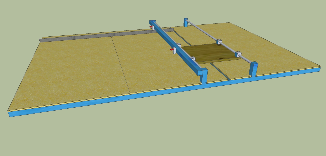

The root of the problem is that plywood comes in 4x8 sheets (or 1.2x2.4 as we call them) obviously I have to cut them and that's the problem. How to cut ply repeatably and efficiently.
What would you suggest? I am currently using a small table saw with the fence but it takes three people to handle a sheet and it's hard to get a perfect cut.
My idea is to build a table with a fence and a circular saw on ball bearings. Like pictured below.
You can see the fence at the back and the carriage where the saw would sit on the right. The red things are clamps.
What do you think ideas? suggestion?

I cut my plywood by laying it on a sawhorse table, with battens spaced appropriately for the cuts to be made, then use something on this line:
Two Essential Saw Cutting Guides | The Family Handyman
basically made from scrap pieces of mdf/plywood, then a couple of good clamps. I made my guide so that the edge is exactly 12" from the cut, so I just add 12" to what needs to be cut, clamp the guide down and I'm good to go
/ Cutting 4x8 sheets #3
I've always used a 6' level and two clamps to secure it to the plywood, then use it as a guide. I measured the distance from the center of the saw blade's width, to the edge of the skill saws aluminum base, then subtract that from whatever measurement I want (for example, 4') I lay out the line on the plywood and butt the level to the line, then double check, and cut. I get a very straight cut this way, but if doing it in mass production mode I would use a saw cutting guide, but I like your idea of the ball bearings.

They have something like this at Home Depot and Lowes. Works good for cross-cuts. If you want to rip, you turn the saw 90 degrees and push the plywood through.
But, my first thought was what Steve linked to above. From what I understand about the track saws, you can lay the track right on the cut line and it cuts flush to the track. No measuring to compensate for how far the edge of the base plate of the saw is from the blade.
/ Cutting 4x8 sheets #8
x2 on the panel saw. If you are in a "production" mode the panel saw will allow you to cut multiple sheets at the same time. Also no clamps, no bending over wide sheets to push the saw, etc.

Look for a used panel saw. It makes cutting large sheets a 1 man operation and is much safer.
I bought a used Dewalt panel saw for $400
Milwaukee panel saw
Or use this idea and make a version of your own, Homemade panel saw

Thanks for all your replies. I am looking for something more efficient then a circular saw a guide. I've considered a track saw but it's not much better. I want something that I don't have to measure every cut. I like the idea of a panel saw and that's basically what I would like to build. Any thoughts on my design?
Here is a pretty nice homemade one. I only need to be able to crosscut not rip though. I would also make mine steel frame. And mine would be running on proper ball bearings. DIY panel saw - 2ManyProjects
/ Cutting 4x8 sheets #19
Your thread got me looking around the Internet for home made panel saws. I saw that one and a few others that looked pretty good. There was also a commercial made kit with all the hardware including a polycarbonate mount for the saw.
