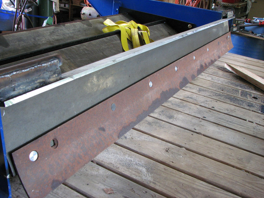

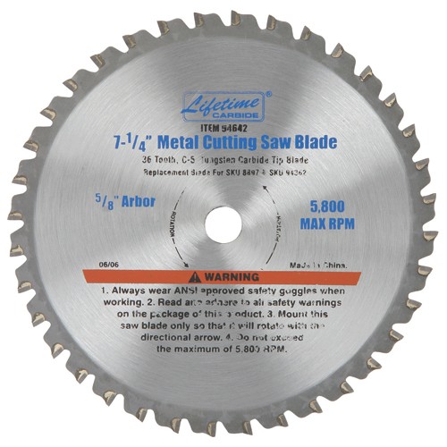

Harbor Freight has a 7-1/4" carbide tipped metal cutting blade for $20. A 20% off coupon drops the price to $16. Stay away from welds & torch cuts & you can get a lot of life from one. They say up to 1/4" thick but I have made an 8' long cut in 1/2" just cut about 18" then let the saw run 15-20 sec without a load to keep the saw from over heating then continued on. Left a very nice edge (2nd Photo). This blade is still going strong. One blade had over 60 cut through 3" channel iron before I cut through an area which had been welded on on the other side.

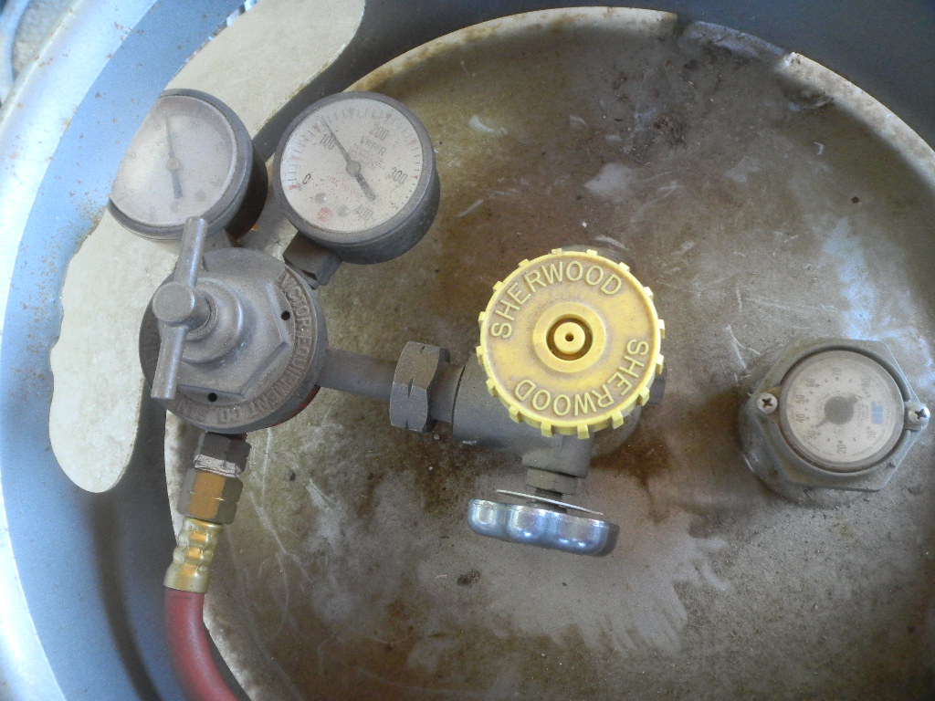

SO... Can you upgrade an oxy/acet setup to use propane? (acet hose doesn't play well with propane?) From what I've seen so far you can use an acet regulator but will a regular acet regulator attach to a regular propane tank?
I like the idea of using oxy-propane since I would only be using it for heating/cutting and not welding. Propane would be cheaper.
My Victor journeyman acetylene gauge would not fit on my 100-gallon propane tank. I had to use a smaller hobby style acetylene gauge someone gave to me.
I know it's not recommended, but I've read on Welding Web where guys have used their type R hose for years with propane, and haven't had any issues.:confused3:
