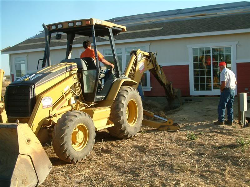

Good suggestion. My neighbor has a big wompin wheel loader. Maybe he could push sideways on the post to loosen it a little, chain the post to the bucket and pull upwards. Might work. Or maybe this approach would work with a big construction grade backhoe like this one.
Thanks for the input.

/ Cutting concrete posts #13
Flusher, with that machine shown and a good chain or sling it shouldn't even break into a sweat.:D :D :D
