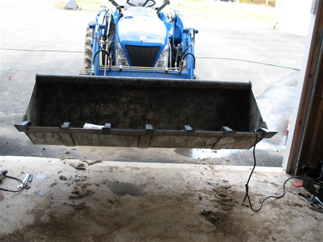

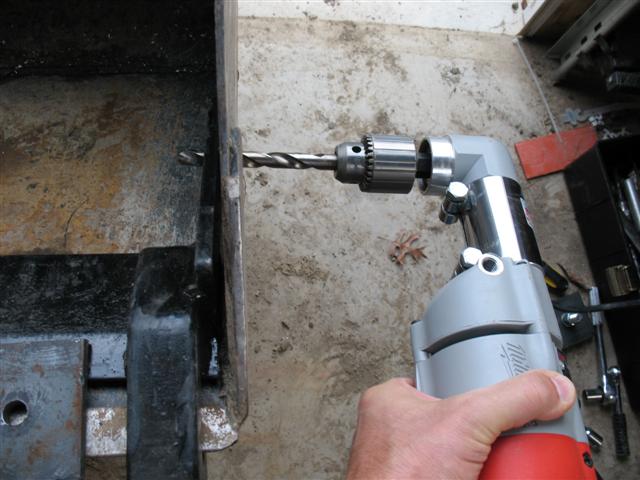

wash and clean bucket first then made holes.

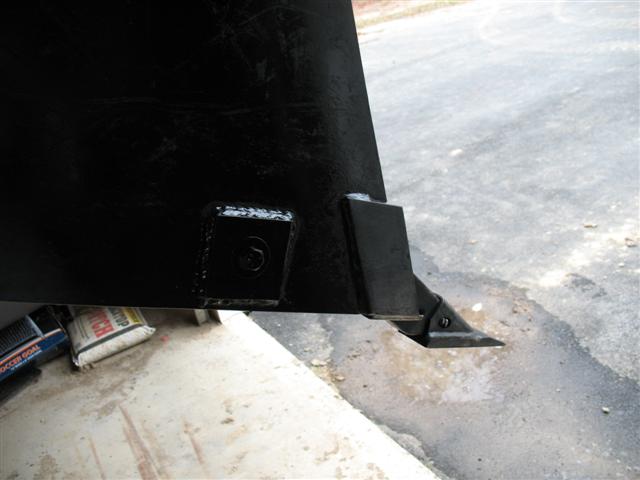

attached bolts.

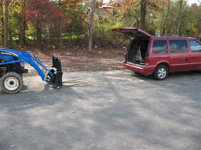

loaded to caravan

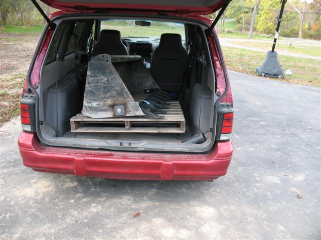

welded and back for paint

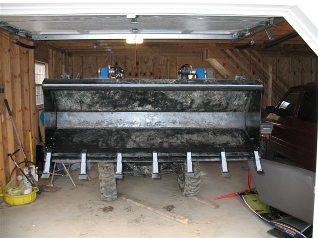

painted

Gave the tooth bar a real test and here's what I found:
removed a nice size stump.
brakes off the dirt that stuck to stump.
cuts and rips roots (makes you smile when she rips right out of the ground)
grades with ease
backfilling is not a issue.
combs out roots with ease I didn't have to hook up the york rake to clean up.
I tried cutting a path for a walkway it cuts with ease.
The teeth pick up the stump with out droping it.
The tooth bar is like a giant version of my back hoe bucket.
It's so cool to be able to dig while moving.
This is def the way to go.
The tooth bar is a must have attachment not only will it save you time, it will save your bucket -I wish I bought this with my tractor (new)
Thanks to everyone for the great advice you guys save me $400 from buying the cutting edge.
3RRL,
your installation instuctions were great thanks.
John
