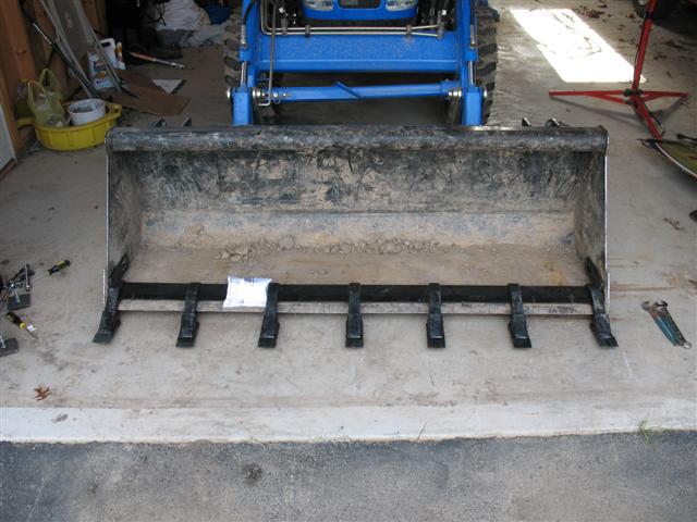

Fast shipping ordered 10/19/06 arrived 10/23/06 by UPS.
Installation was easy, I used my right angle drill to make holes.
The welding did not turn out so good --so for $20 bucks I had it done by a pro --I had to load the bucket on a pallet and I used my Q/A forks to load it to the caravan, brought it back home and painted it--it's 49 degrees so am letting the paint dry.
I'll try out later..
pictures on the way
   / cutting edge or tooth bar?
#30
dry fit.
this is how the tooth bar arrived no box just tracking sticker attached
