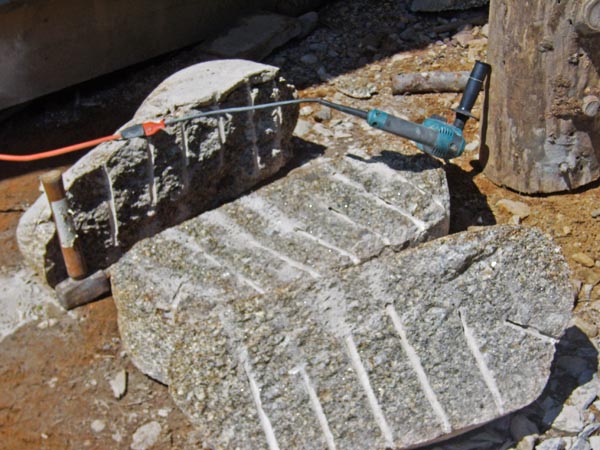

Up here I use a Makita hammer drill and angle grinder with a stone blade in for cutting the local granite boulders.:D Then wedges and feathers for splitting.:D
The rocks I've been working on have much much smaller though.

Egon, about how long does it take to split your pictured rock into the three pieces? The middle piece looks very useable. BTW - I notice you haven't worn the label off your hammer yet :D:D

I have to agree with Egon and some of the others. I have made alot of big rocks into littler rocks with an electric hammer drill and some feather and wedges. If your looking to get some usable slabs the feather & wedges work great for making a controled split. Egon's picture shows it perfectly. If you want to waste money, make alot of noise and wind up with a pile of rubble, go for the air compressor

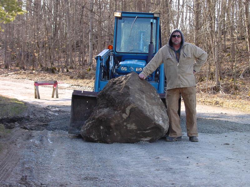

I've got some boulders I want to move around, and I guessed they were around 2 ton, so I guess I was close. This is one rose out of the ground a little more each year became a traffic hazard.
Supervising, hard to believe something that size weighs that much. Granite is 168 lbs / cubic foot. That boulder is easily 2 to 2-1/2 tons give or take a once. :)
That takes me about 1/2 of an hour I think. Never timed it. :D
Note: There are many different kinds of Granite of varying hardness. There is one type of granite here that I don't even try to split as it takes too long.:D
Just so you know folks here in Georgia...Atlanta area in the gated communities pay big bucks to landscape architects for boulders like the one you are standing with..It would probably go for about $600.00 plus delivery and installation...thought you might get a laugh out of that...Now that was up until 2 yrs. ago when this economy went south..so maybe not so any longer but ther was a time.
