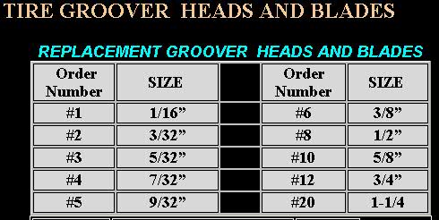

Deadman, you are killing me. I gotta have a tire cutter, will start shopping now. I found on page 7 of this thread where you show your work, and it looks great! I think you stated you used a #5 on back and a #3 on front and wished you'd used a #4 up front. My tractor is a bit larger so I might want to use a #6 in back where the lugs are like small continents. I looked up the specs on the cutter sizes. I assume that when they say the #6 cutter is 3/8" wide, that means it makes a 3/8" groove. Thanks for your enthusiasm...

I will just caution that if you use a groove size that is too big (and I'm not sure what too big is) the snow might not hold in the groove as well and this might diminish traction. With the #4 iron I noticed that groove depth should exceed groove width to hold snow well.
If I had a larger tractor with very large lugs, I would probably make multiple smaller grooves rather than one big groove. In theory this should work better. :thumbsup:

On the size of your cuts, ya, the blades are numbered and that is a standard measurement I believe. I used the smaller knife on my fronts, because i know I can always cut them larger if needed. I tried it on a junk tire I had laying around, and then measured and examined it to be sure that was the width and depth that I wanted. I cut my fronts about 3/4 the way thru the lugs depth wise. The rears are much less in comparison, because the lugs are so much beefier. I can always cut them again in a few years if its necessary.
I liked the angles on my front cuts, because that offers "side traction", and some "forward traction". I needed the side traction the most, and that has helped. I think they will be awesome in the dirt, but I won't know until mother nature melts the blanket of snow!
