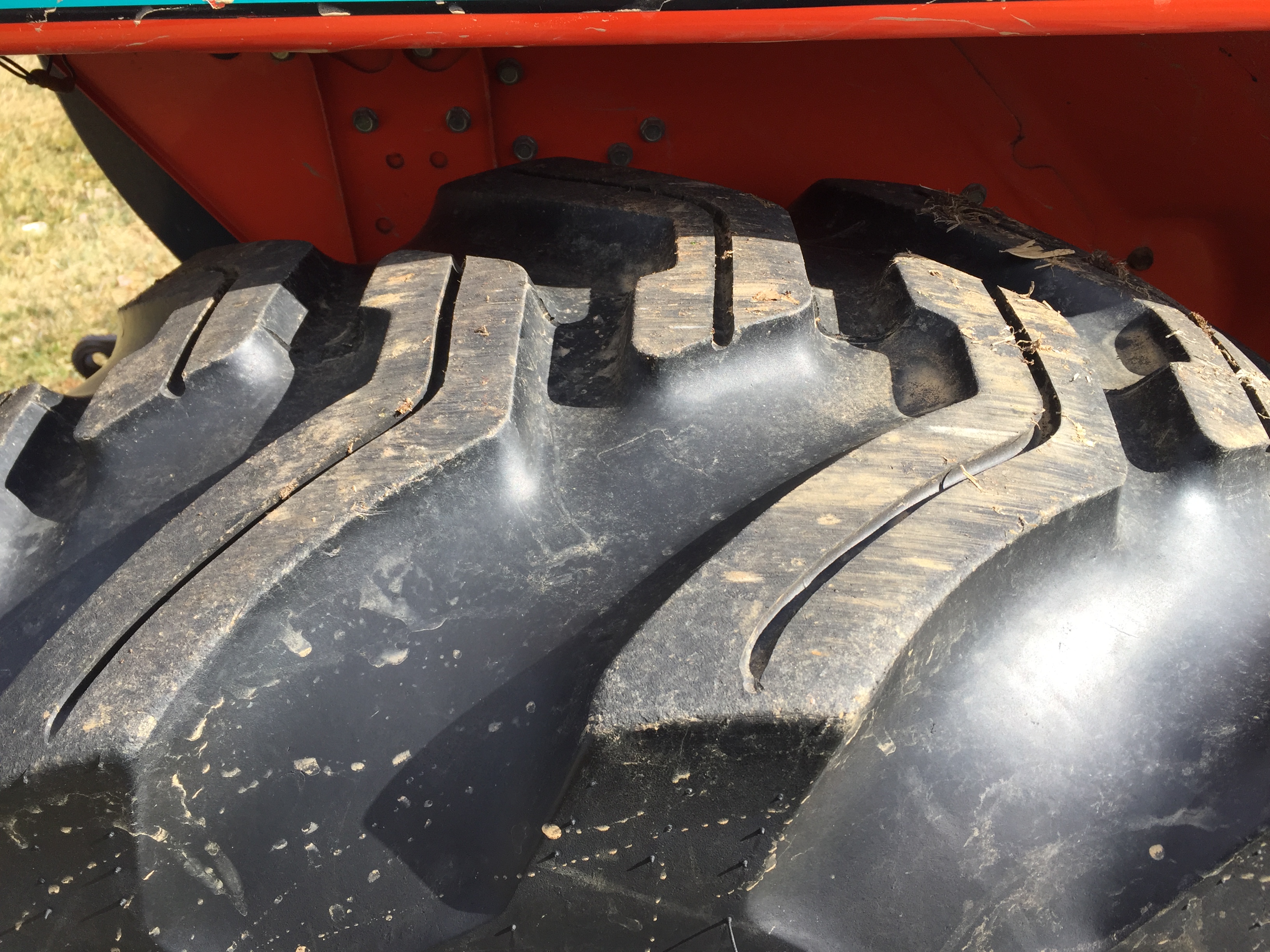

Wow! Indeed nice job Boris... you said in an earlier post you used white dots and 'mostly' freehand. Did you sometimes use a straight edge? If so, did that speed things up? Seeing yours I am encouraged to try myself if I can get my hands on a tool.
I used the dots as a guide or something to shoot for or a connect the dots . I guess what I meant by mostly is I used a framing square for measuring 3/4" in at both ends so I didn't compromise the edges. Tried to start & end with a short downward and outward slope. My thinking was it would somehow keep the strength of each tread bar. I "eyeballed" the center point after I got a feel for the groover.
I have not decided how to do the rears yet, My first thought was to use a bigger groove but now I'm thinking maybe 2 per tread the Same size as the front ones. Gonna think on it. Good luck if you give it a try, if I could do it I'm sure you guys will be fine.

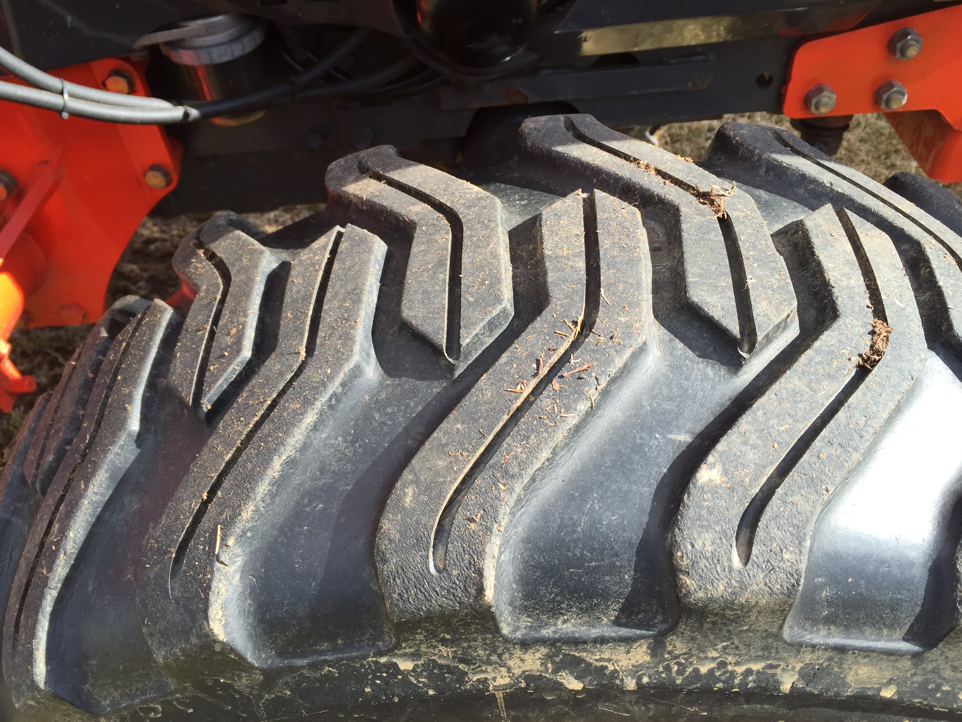

OP here. The cold weather is starting to roll in and it's snowing in parts of the Northeast. About a year ago I grooved the tires on my new tractor (well, new 2 years ago). At that time I wrote that I would post pictures once I was done but got busy etc. So finally posting pics! I did the traditional "follow the lug" pattern on the front just like on my first tractor (the one that started this thread). However, on the rear I grooved much more liberally and practically made what look like R-4 turfs because I wanted maximum traction. I didn't have a picture of just the tires on hand but in his picture with my kids you can clearly see the groove pattern on the tires.

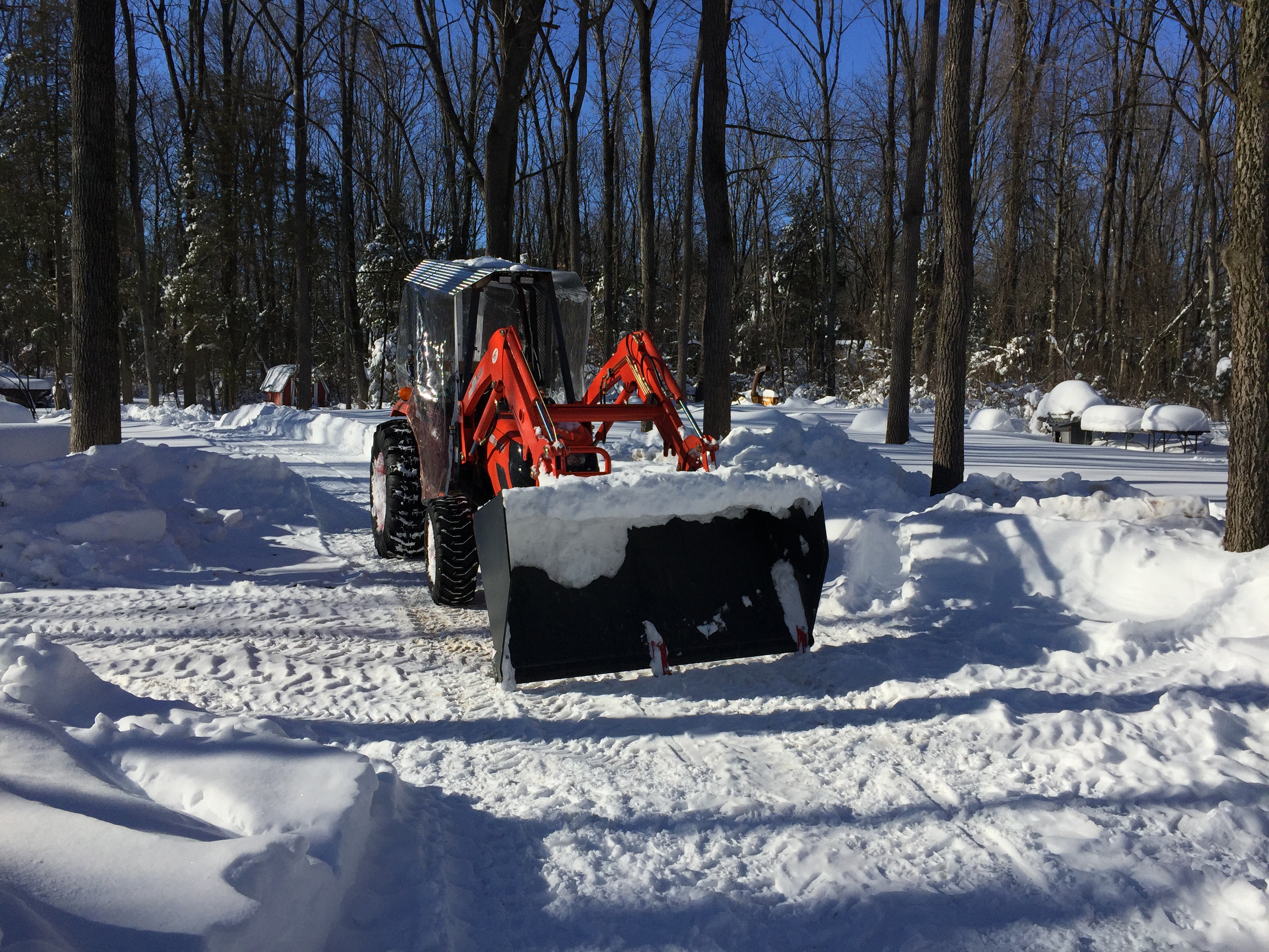

As luck would have it I did this just few months before the 30+" storm we had last winter. I never once had to think about traction. It walked right through 30+ inches with the big snow bucket gliding on Edge Tamers and pushing a wall of snow 4-5 feet high. Couldn't have been easier!
Can't wait for the snow to start again and really hoping for another big dump! The tires on the new tractor have been grooved for a year and about 100 hours with no issues.

Once upon a time I used chains whenever it got bad. After gouging a neighbors driveway and gouging my garage floor I needed to find a better solution before doing more damage. So I started looking at snow tire technology and thinking about what could be applied to my R-4s. Honestly, the improved traction was more than I had anticipated.
I had absolutely no traction issues last year with all 4 tires freshly grooved in 30 inches of snow. Even going up a steep drive ~20%+ (where I couldn't finish one year in about 12" of snow with chains [only on front] because I was spinning on the asphalt and gouging the driveway) I had no problems with my current setup with all 4 tires grooved. Traction is obviously much better when you get down to asphalt. That is not a direct comparison because I'm using an entirely different (larger) tractor now and had chains only on front on the smaller tractor previously etc. But my point is that I've been able to do everything I've tried with all 4 tires grooved - rears heavily grooved.
I think going with more grooves on the larger rear lugs was a good move. I can see how much more snow they hold compared to my previous tractor which had one groove that followed the lug. Essentially, the snow sticks to the entire lug with the groove pattern that I used.
I have not had the new tractor in an ice storm. However, I did testing with the old tractor with grooved tires after an ice storm and compared it to several vehicle tire combinations and it performed very well. I'll have to go back through this thread and find that test because it's well buried by now. I had no problems stopping when going down or reversing up a slight grade (~5%) on a 1" thick sheet of ice. That being said, grooved tires can never compare to v-bar chains on solid ice. I suppose if you plow steep drives in an area with frequent ice storms chains may be the only solution. I just don't know, haven't done extensive testing with grooved tires in ice. And I've never even felt the need to add sipes which was in my original plan - but why cut more when what I have done does everything I've ever needed.
