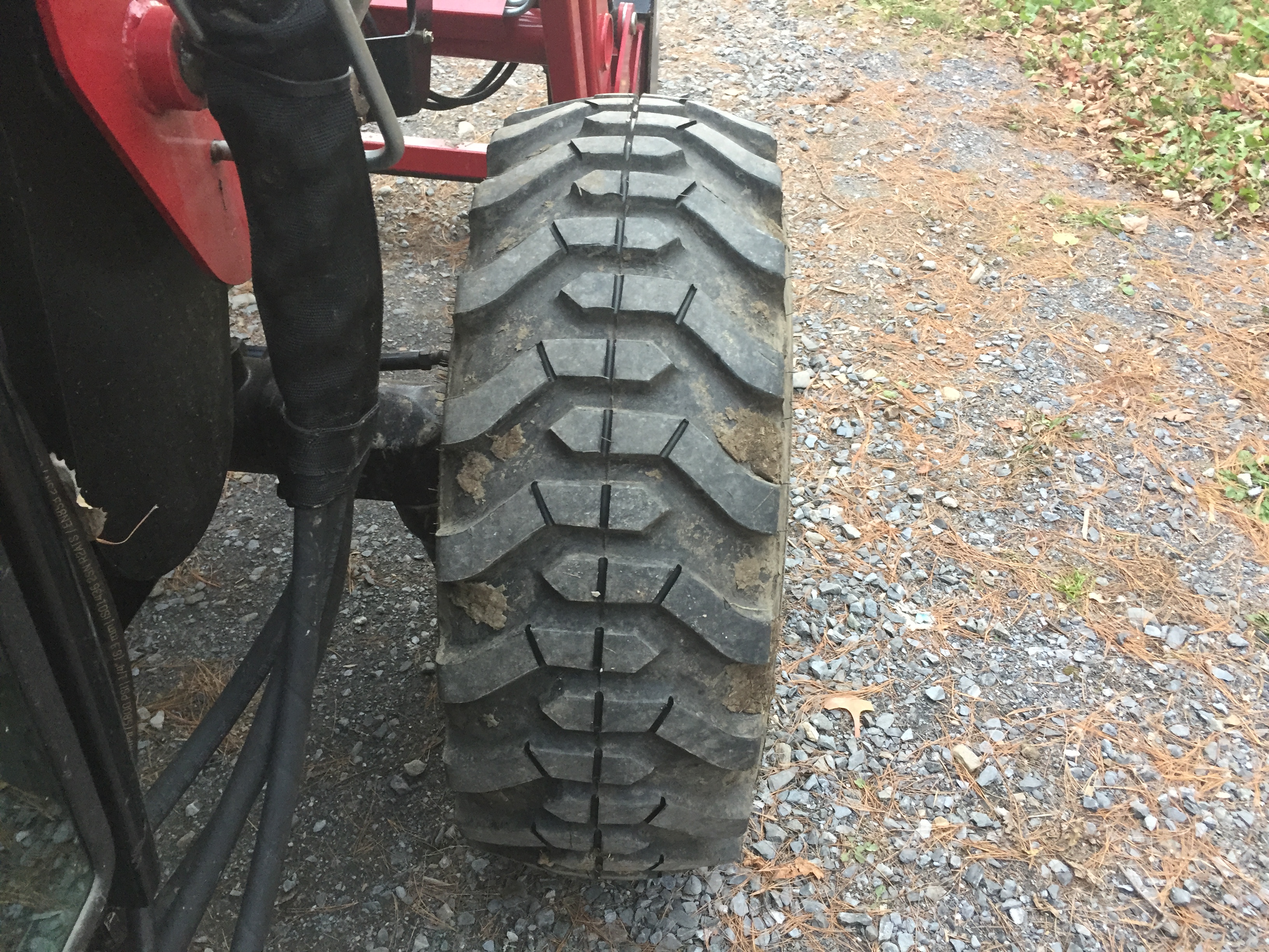

Grooved mine and very happy I did. No issues or extra wear. I.D have to look back and see how many hours I had on the machine and what I’ve put on since. However, the wear (or lack thereof) is if anything minimal. The gain in traction well worth it in asphalt.... (odd part, I think i have a few lugs I didn’t do originally. Maybe I’ll knock that out today).

Checking in after 7 years! Wow, I can't believe it's been that long since I started this thread.
I sold the Kioti LB1914 from Post 1. But it didn't go far. It's now with my cousin with the same tires and there have been no issues with unusual tire wear. I grooved the Kioti DS4510 three years ago and no issues with that one either.
I never had a traction issue with either one after grooving the tires & and have never once regretted grooving them.

This is the second winter on mine and I haven't had any chunking or splits. I'm very satisfied with the results.
   / Cutting / Groving / Siping R-4 for snow #554
What tool was used to make the grooves, depth gauge or stop of some type?

That is the tool I used to groove mine, it works slick.
I have a PORTER-CABLE PCE605K 3-Amp Corded Oscillating Multi-Tool. I think I may try it on one of my lug's tomorrow. It is a great tool for cutting trim and removing grout. It has a built in depth gauge also.
   / Cutting / Groving / Siping R-4 for snow #560
Built in depth gauge should be nice. Please report your results.
