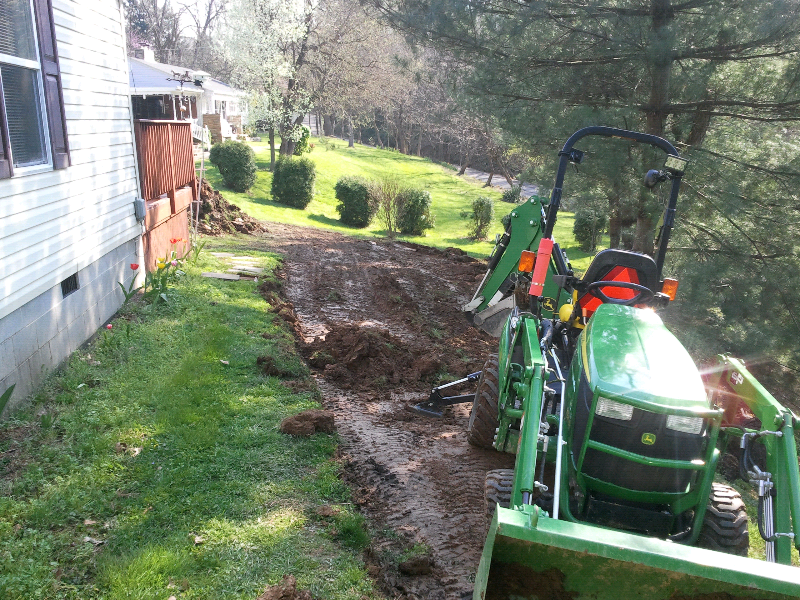

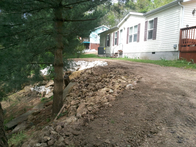

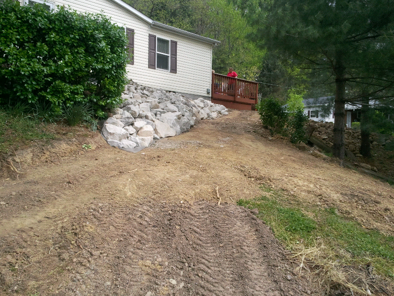

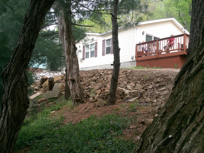

I spent 50 hours digging out and rebuilding a hill with my 1026r it was about 40 yards of material and the pile was far away on a hillside. I've got a nice yard and wall there now!
