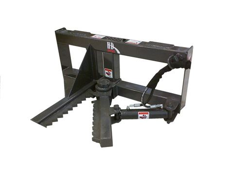

Has anyone used one of the tree shears on a skid steer? If so do they cut clean or do the small branch's get caught between the blades?
   / Cutting Red Willow bushes in pasture with skidsteer, Brush cutter or Scissor cutter? #14
I have been doing the same exact thing you are dealing with for ten years.Red willows;this stuff is very tough and gets thick and strong rooted.Forget the tree shear,built one last year;way too slow and really didn't work well on the small stuff(3/4-1-1/2").

That's what I thought that it might be slow, I will give them a sip of Round-up and 24-D come spring and see if there is anyone somewhat local that will do the cutting, otherwise it is going to be one of these:

I would buy this type tree puller, pull them, then sell the puller.
I built a puller almost identical to that one;painfully slow process using it.I found it much quicker to cut with my shoulder saw and gather with the grapple than use that puller.The red willows are very tough and deep rooted;they do grow back;I just keep them cut down.The hard part is when they have been established for years and are6-12ft. high.

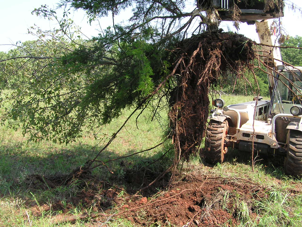

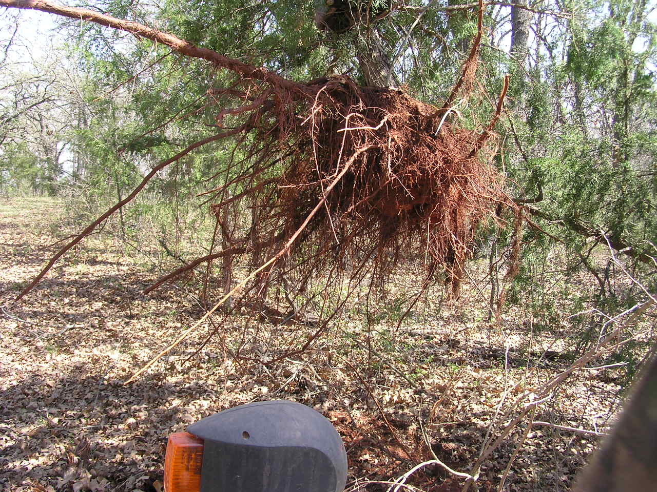

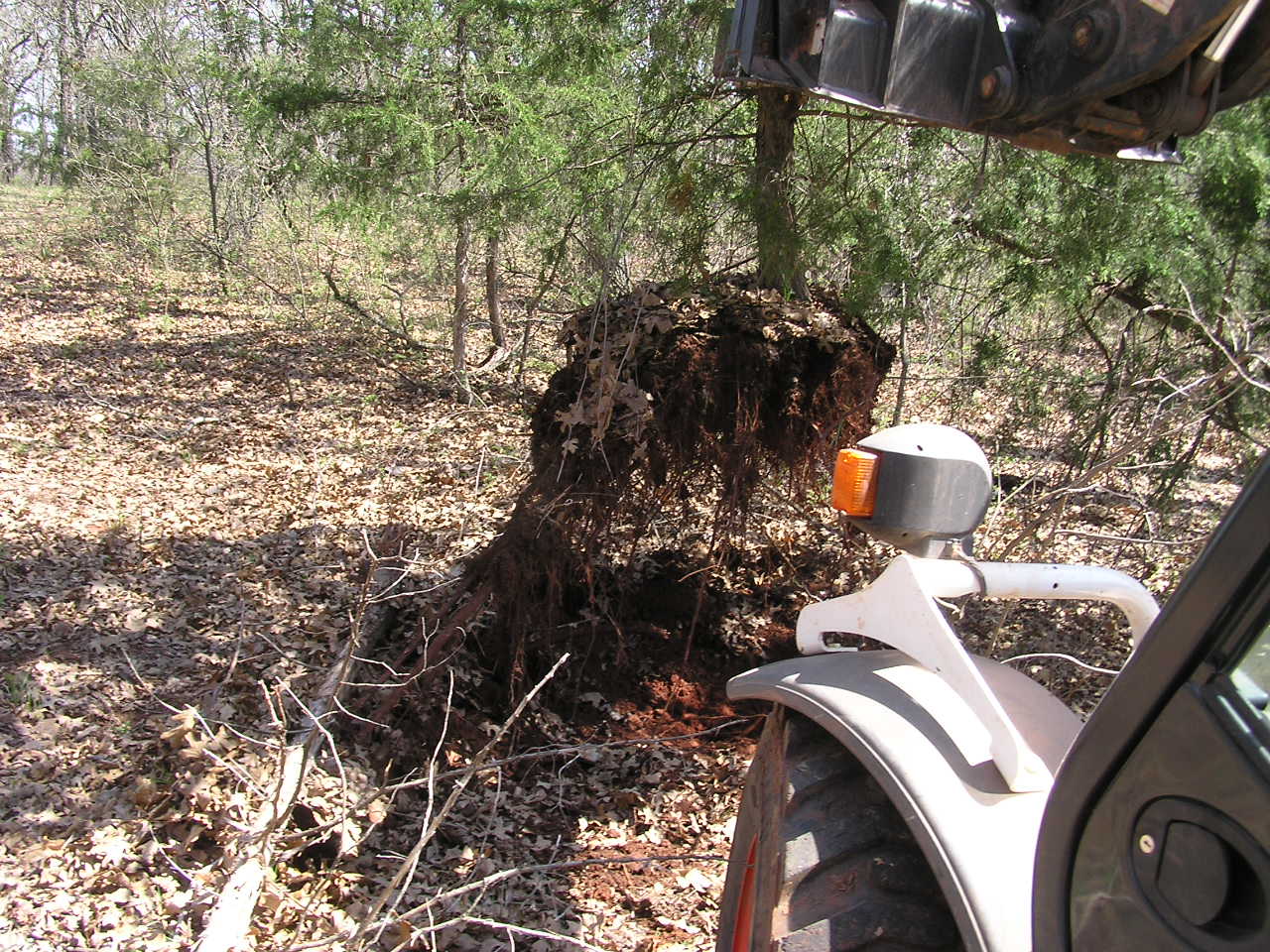

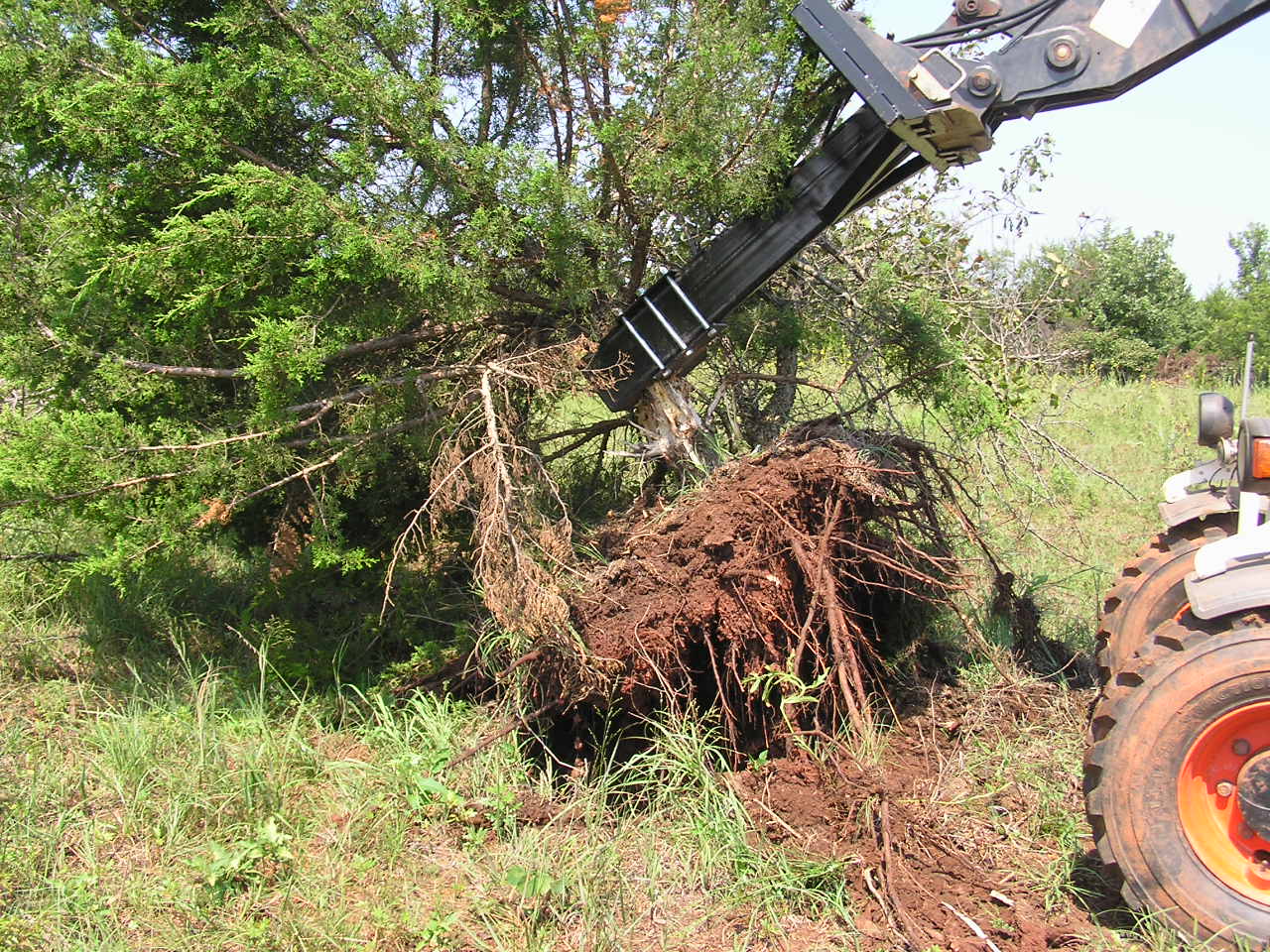

There are skid steers with higher tipping load ratings than my 4400 pound lift rated V417.
Just to give you an idea of what can be pulled, cedars don't have a tap root, but have a lot of lateral roots. This is red clay soil.
