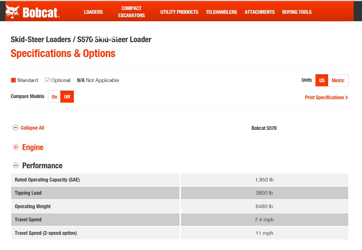

Holy Crap! that is impressive! My Bobcat S570 is only 1950 lbs lift so pretty limited for that kind of work.
That is the ROC (rated operating capacity), a very conservative rating.
The tipping load is 3900 pounds, a better indicator of what it could pull out of the ground.
Your dealer should have a puller that you can rent.

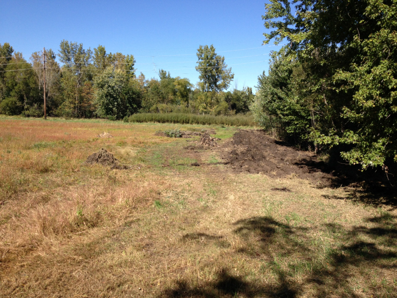

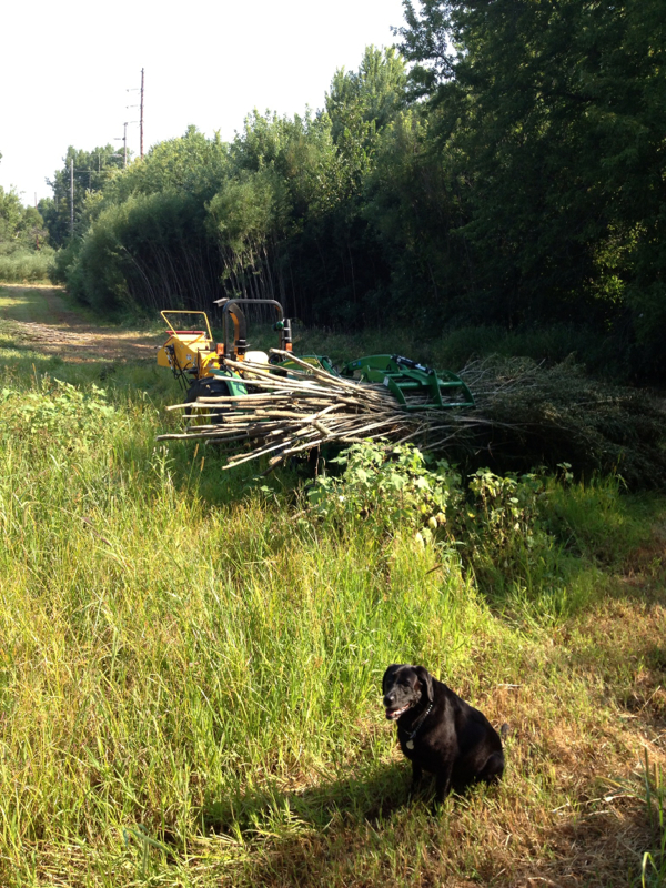

Before and after pictures of my field perimeter. If you don't pull them out, roots and all, the will grow back like the Medusa!

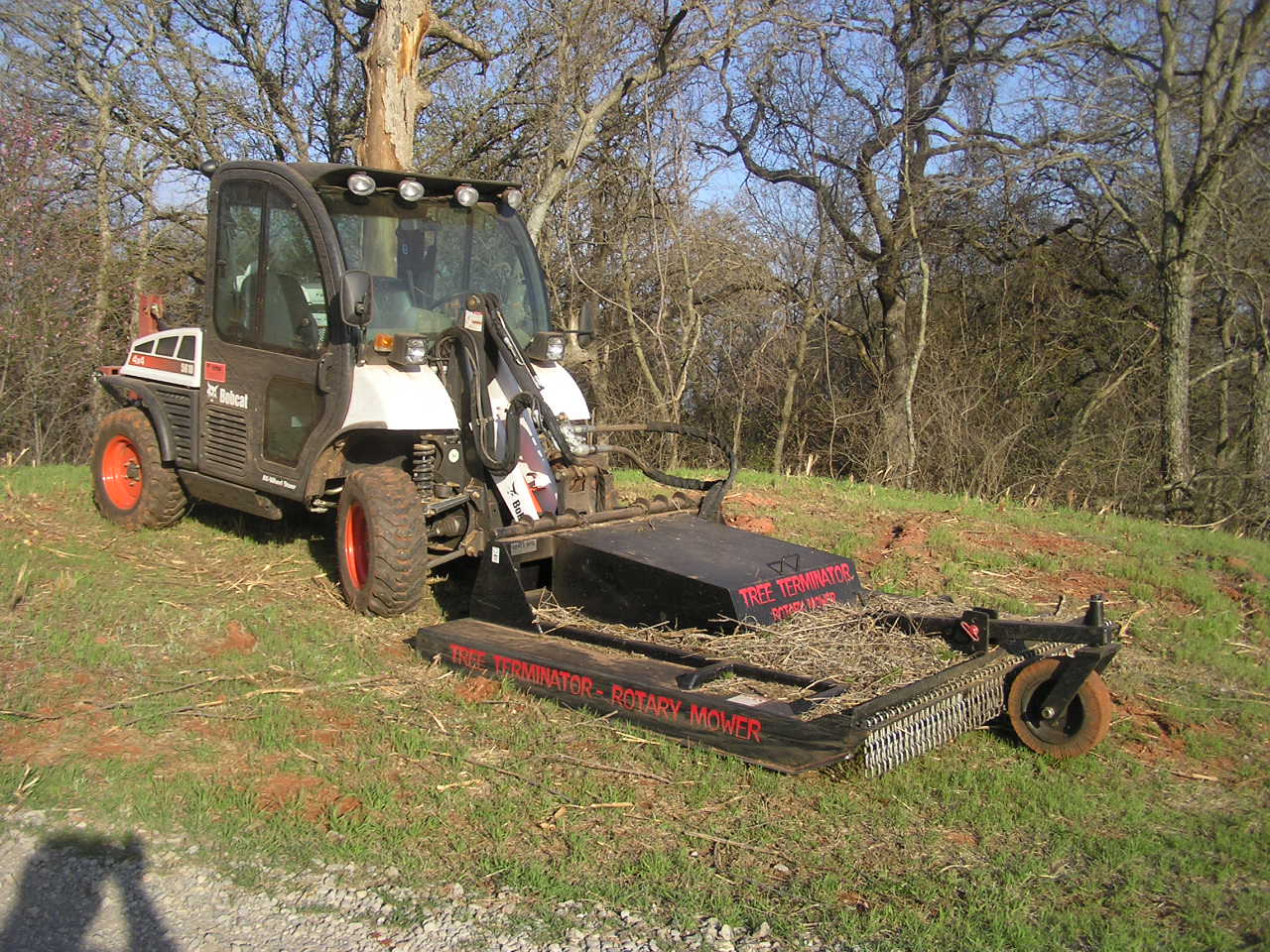

If you haven't closed the deal, check this one: Grace Manufacturing | Home of the Tree Terminator
It is hinged at the top of the SSQA plate and the front wheel carries half the weight when mowing.

The wheel would definitely help in the soft ground, What do they sell for?
