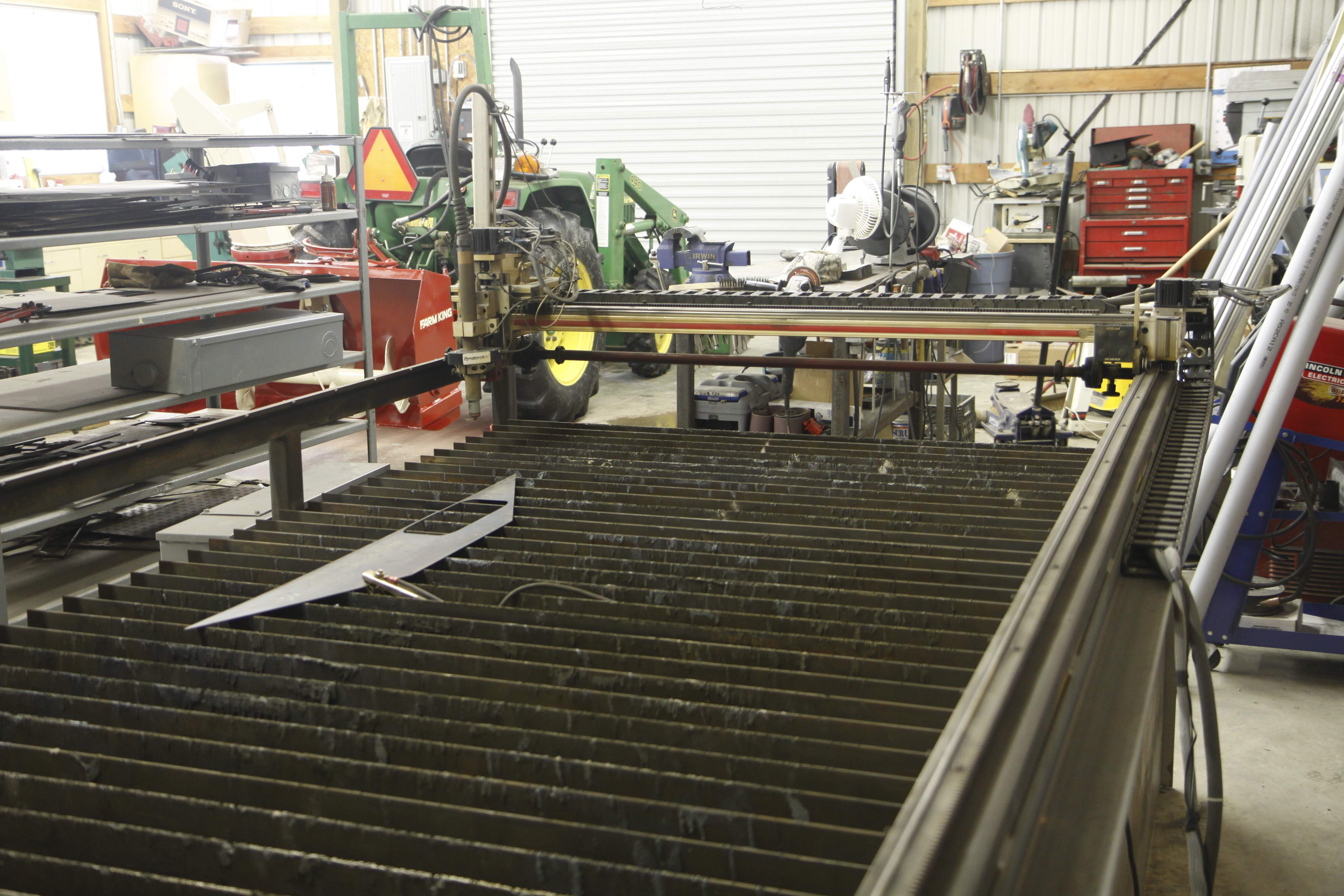

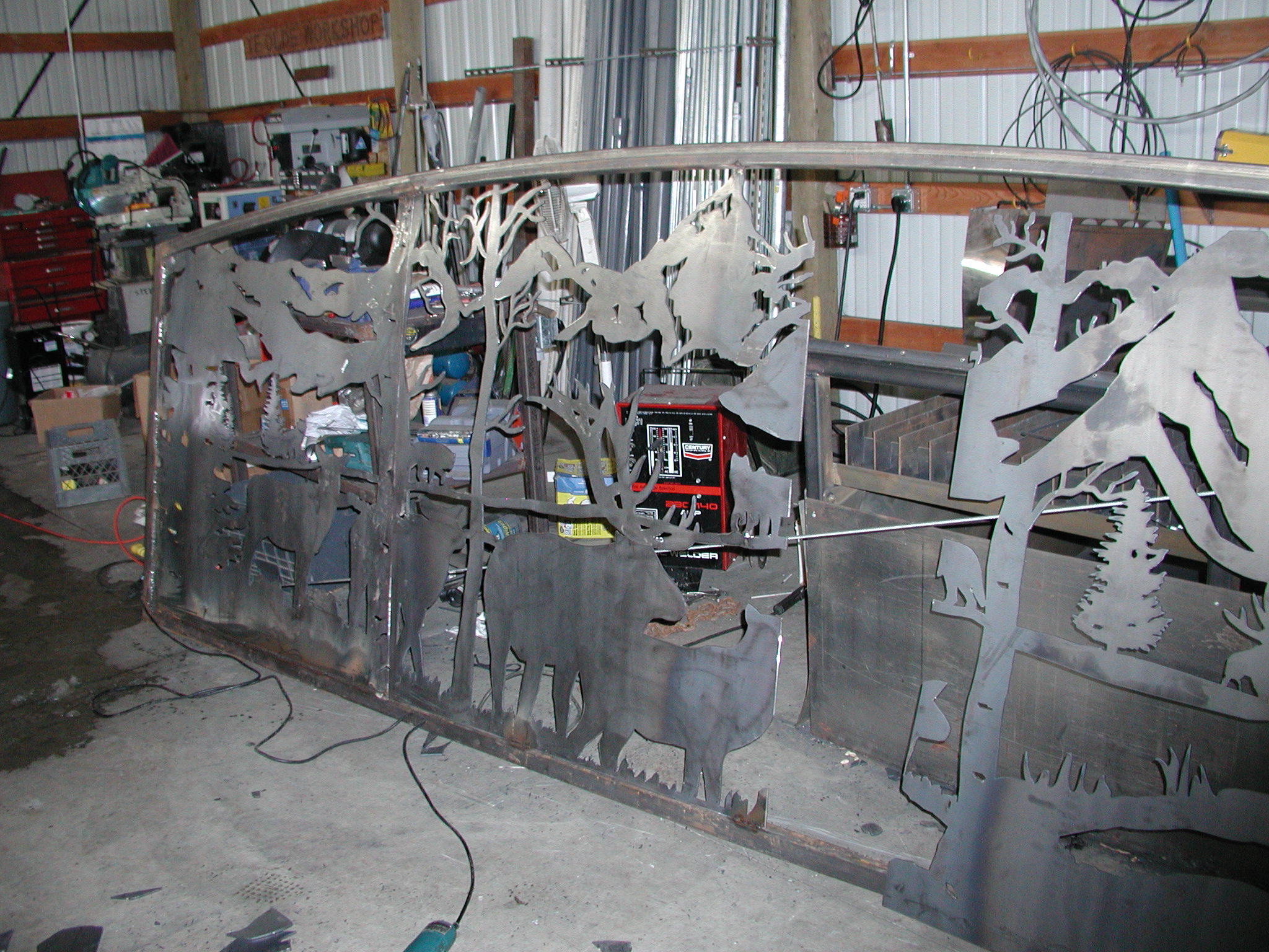

Plasma cutter hands down. Mine is currently limited to a mechanized cutter head, as its on a cnc table. im looking to get a hand held tip for it to increase its usefulness.
i routinely cut thru 1/2" and 3/4" steel. very clean edges.

You can not get a perfect vertical hole, so what is your angle at the bottom. For instance, if cutting a 1 in hole on the top of 3/4 or 1 in, what is the width of the hole on the bottom? I had to ream out the hole for bushings and pins.
there not absolute perfect, that is true, but if the tips are new or near new, they only need a very little deburring (usually with a dremmel tool and stone). I just cut the 1" holed in the 3/8 plate for my bucket, and it only took 20-30 seconds with the dremmel to smooth it out. If i need a 1" finish hole, i set the cnc to cut me a 0.98" hole, then i grind it to fit.
I wish i could afford a laser....but that will never happen.
Straight cuts are usually better than full circles, but id rather have to use a dremmel than a drill press.
