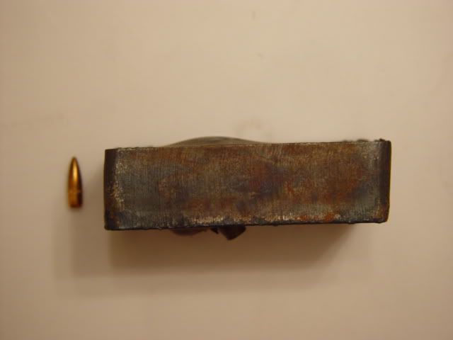

This is an untouched cut in 1" plate steel with the 101 torch with correct tip and pressure.
That is a real nice cut, I never seen a smoother cut. Are you saying you did that cut with a O-A Victor torch, what was the pressure settings and how long is the torch?
1" is probably as thick as I will ever cut, most of my cuts will be 1/8>1/2" and/also for heating/straightening/cutting 1/2>1-1/2" round stock, but I want to stay around 16>18" long for getting in and around motor compartments.
Do you mean 101 series tips? Actually a cut like that isn't all that difficult but you have to have everything set up right and good clean tip. I like to clamp the straight edge guide for torch so it can't move. I have a Contour marker aluminum magnetic straight edge that lets the tip guide along it with less drag than a piece of steel. A little preheat and then a nice steady even travel speed and you're set. A lot of people have jumped on the plasma bandwagon but I find it much easier to do nice cuts with a cutting torch.

The torch in my previous post was a victor 100, about 16" OAL. The tip used for 1" was a 1-101 #2 size with 40-45 psi oxy and 4-8 act.
I use different tips, pressures and speeds depending on what the book/results are (note the copied chart taped to the top by the speed control).
That cut was made on my homemade pantograph machine, that by the way uses either a hand torch or plasma cutter (note the bolts that remove the torch holders and cup/hose clamp for plasma torch) depending on what I am cutting.

Made the above template to cut out 50 BMG hits on 1" plate.
The soft tape is just so it didn't scratch the desk top once I milled a slot to hold business cards in the top of it.
