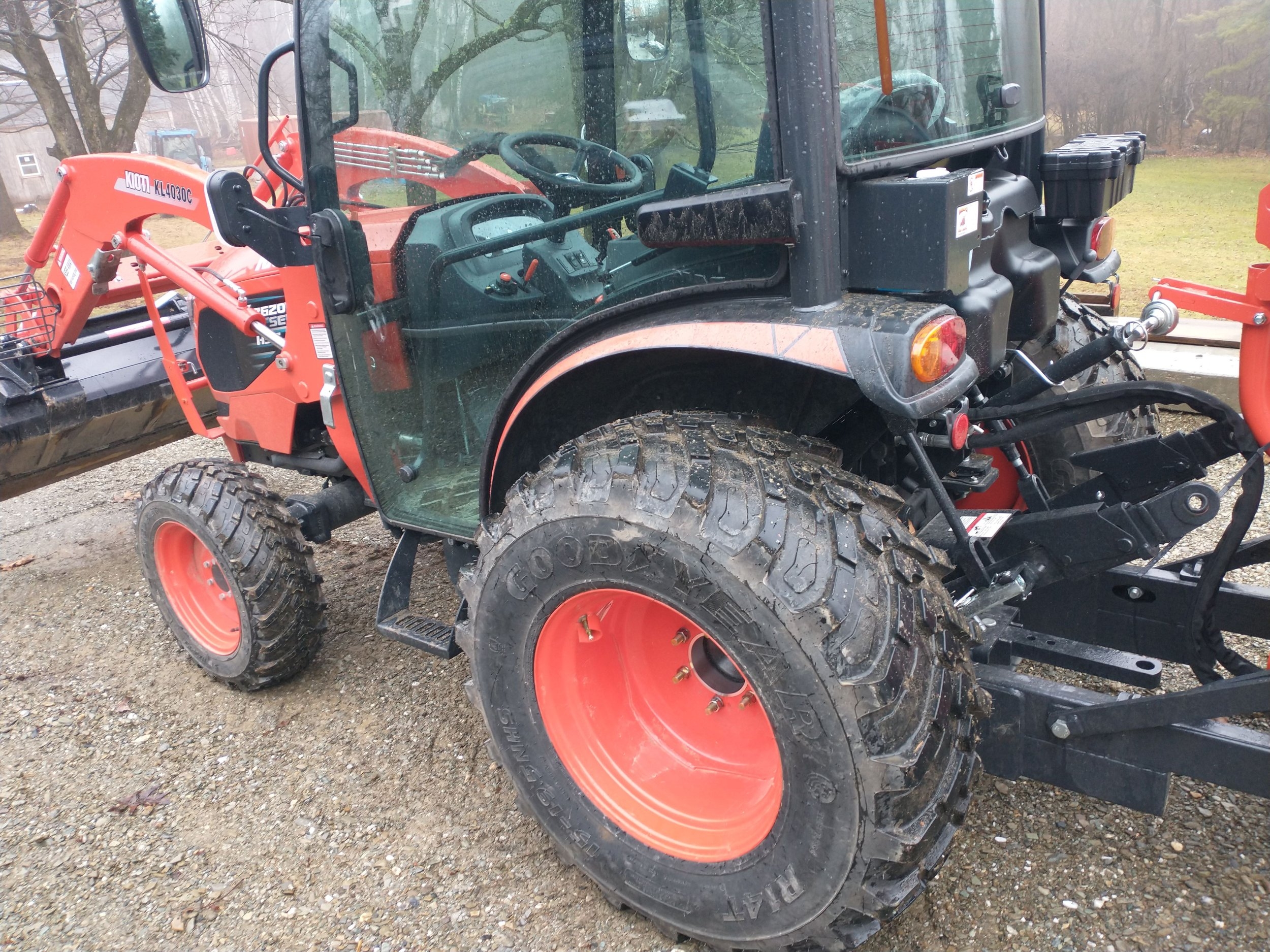

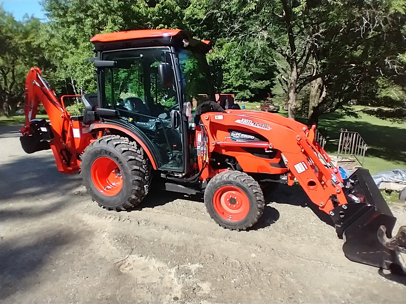

Mine has the R14 tires on it and even with the loaded tires and the backhoe hanging off the rear it hasn't been as rough on the lawn as my larger tractors with R1 tires.

Nice looking CK. Cabin does look more airy/spacious than CX's.
