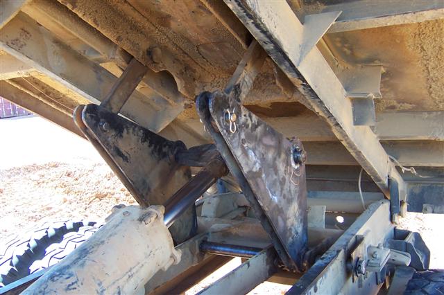

Why would I want to use 80deg instead of 10. The cyl. is 10deg up from horizontal.
Here is another dump setup being worked on by rdbrumfield
/ Cyl. force #15
I understand your problem with the 10 degree starting angle. Can you lower the front of the ram a bit? With only a 3 inch ram it isn't going to lift much very high. If you move it forward to lighten the ram load it won't pick as high. Tradeoffs are a bummer.
Lowering the ram on the subframe will give you better angle for lift and still keep the same height pretty much full extended.
