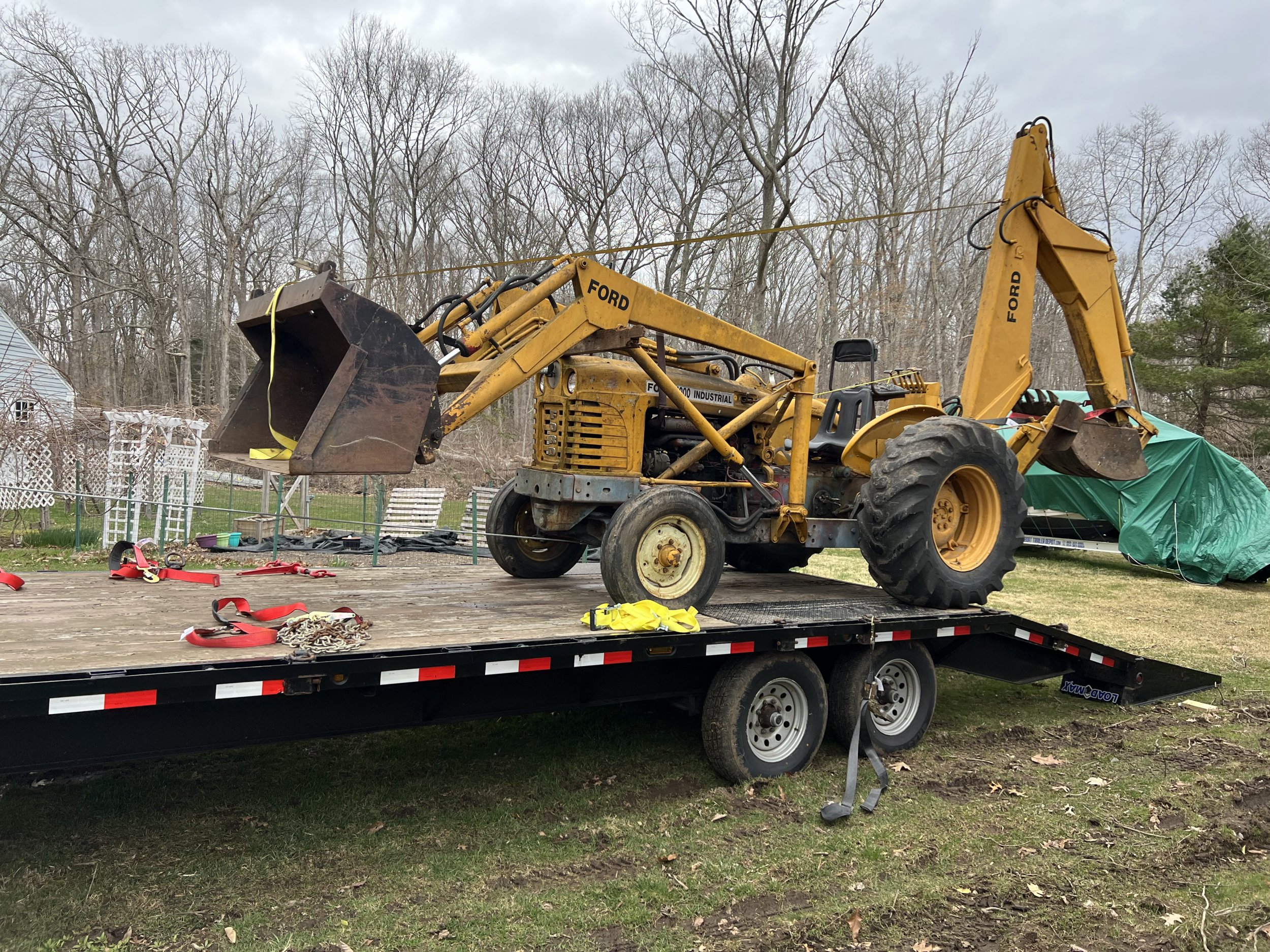

Interesting. Regardless of age and your experience with other machines, it may not be what you have experienced on newer machines, but it should curl and scoop dirt.
What model is the backhoe or do you have some pictures of it?

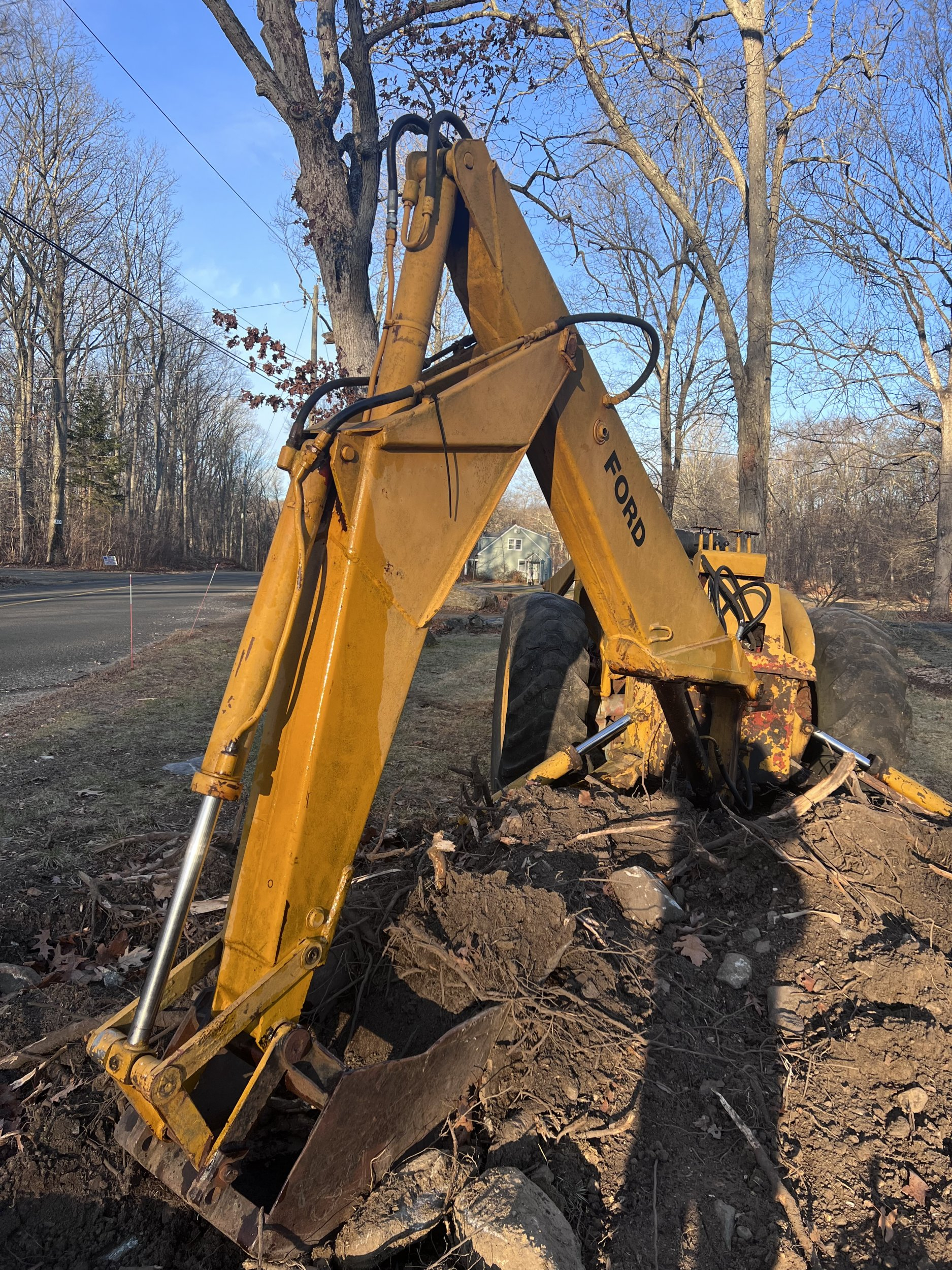

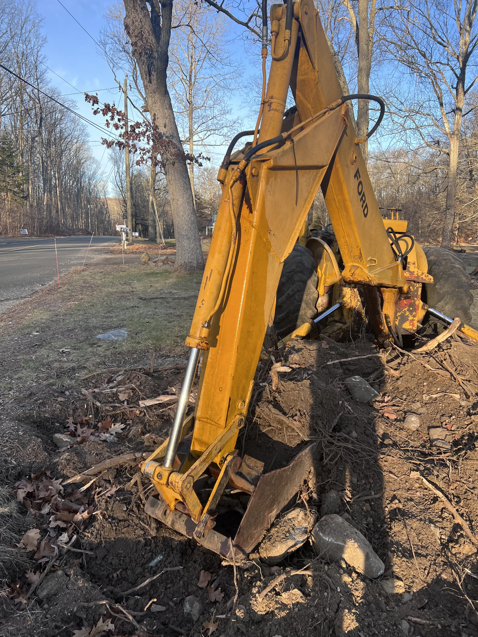

It’s a 1964 ford 4000 (4140) with the 20 gpm front hydraulic pump. New loader valve with power beyond to the hoe. Ford 712 loader and 723 hoe

Thanks for the pictures. As LD1 said, there are different holes for different reasons.
Have you tried to to pin the dogbone link onto the bucket back hole? This would give you more leverage.

I'd try the other pin hole. But Im guessing is a combination of hard ground (I see alot of roots and rocks in one pic), and improper technique.
Keep practicing

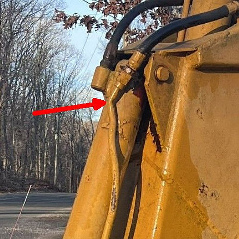

You have a kink in the curl return metal line. When pressure is applied to the extend side, the oil on the rod side has to move freely through that tube. Could be that kink is costing you power.

I tested that cylinder by taking the line off at the metal hose that is kinked, I actually didn't even notice that. I went out and looked at it, and it is a little kinked so I will see what I can do to straighten it out. When working that piston at full lock it did not really squirt any fluid like I thought it would. I did try putting the bucket in dirt without it bottomed out and doing the same thing with the same results of not really anything coming out.
I do question the hose integrity, but I don't know if that would cause my issues. The adapters are strange for this, but someone really cobbled the hoses and fittings together. My plan is to get some adapters and new hoses just to be sure. Some have 2-3 adapters.

A restriction in the hose....should effect its power as long as its at least flowing
Obviously a total blockage would be no power at all....but also no movement.
As long as the bucket moves....a restriction is only gonna slow it down. NOT make it have less power.

The kink in the line would cause it to be slower, but you should still be able to dig through. As LD1 pointed out, it is the angle of attack and using the dipper/crowd that is the intent with the Ford backhoes. It is shaped with a long bottom for that reason, not shaped like an ice cream scoop.
