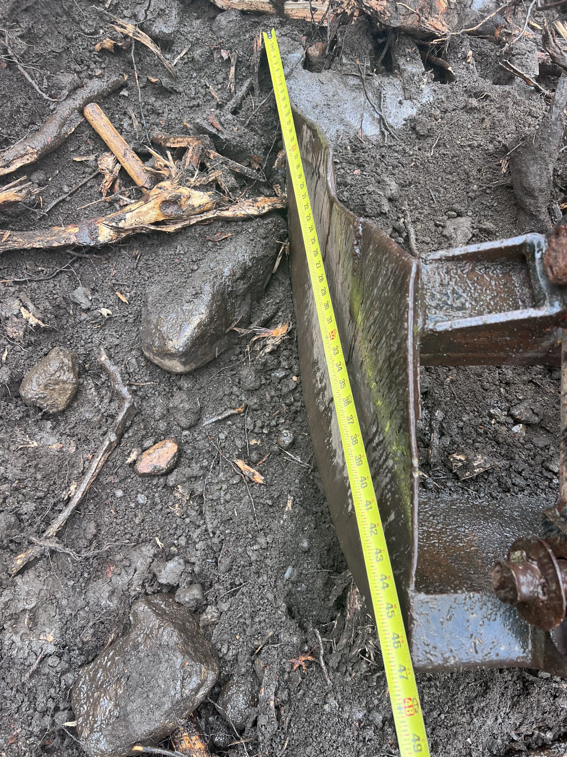

/ Cylinder internal leak? #27
I went and took my measurements on my bucket. Couldn't get any decent pics because it's wadded into the corner of the machine shed.
Tip of tooth to center of pivot pin, mine is 42". Tip of tooth to center of pin where the cylinder power is applied is 47" Would be 50" of I moved the pin to the outer hole on the bucket.
I didn't take any cylinder pin measurements so can't help with that.
His bucket "appears" to have a lot better leverage than mine. But since I can't accurately measure my linkage to the cylinder I can't tell for sure.
And I don't know his cylinder size. And forgot to measure mine.
I don't have any problems with bucket curl. But I totally agree with technique. I depend on boom curl as much or more than bucket curl to fill the bucket. Sometimes you find yourself in a situation where you have to rely on bucket curl more. You just learn to deal with it.

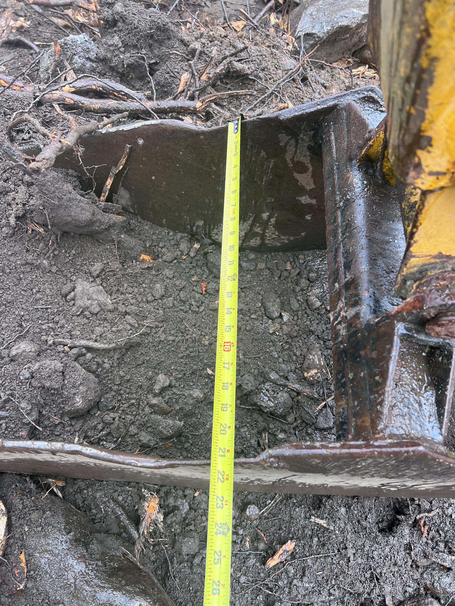

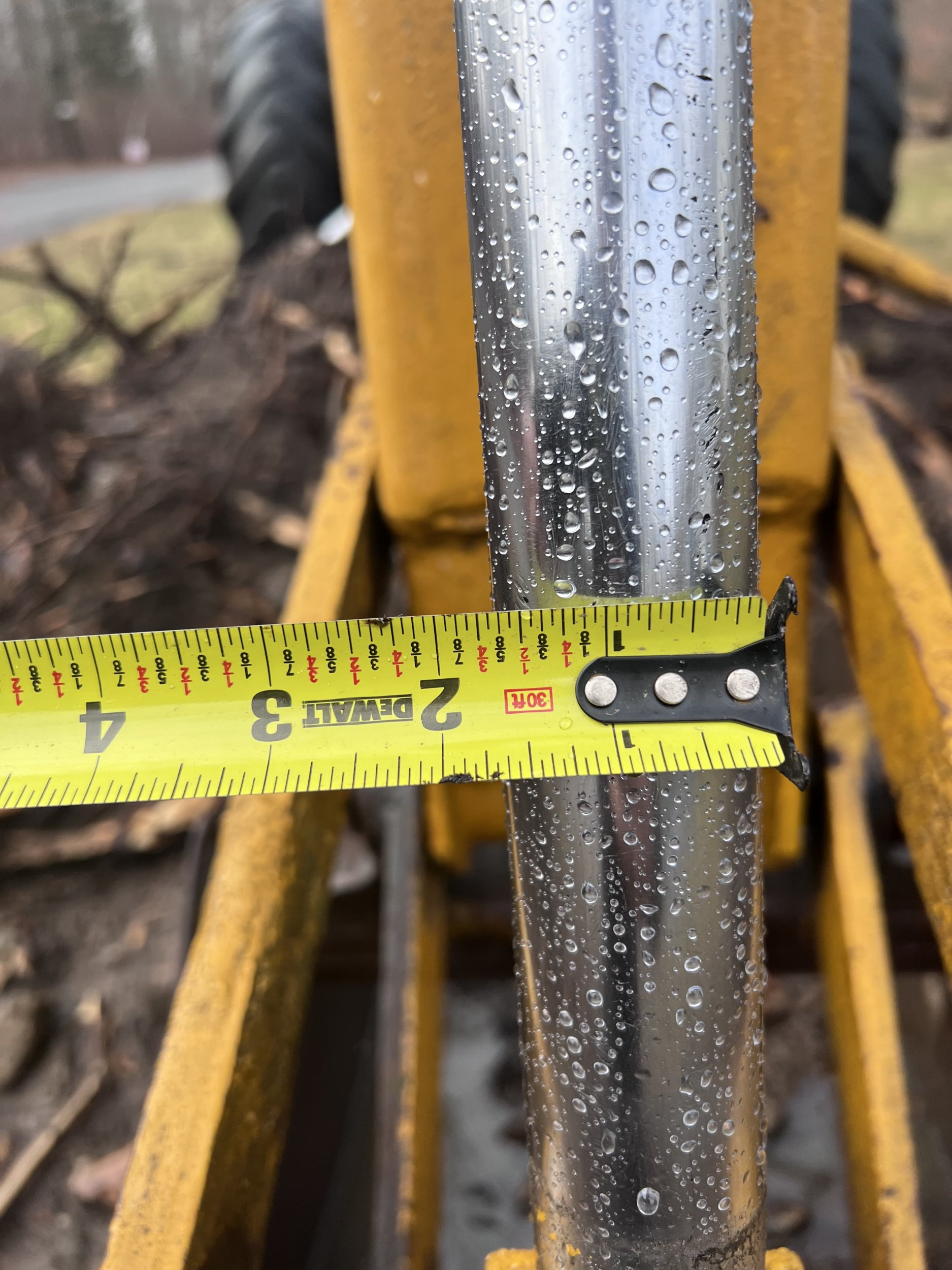

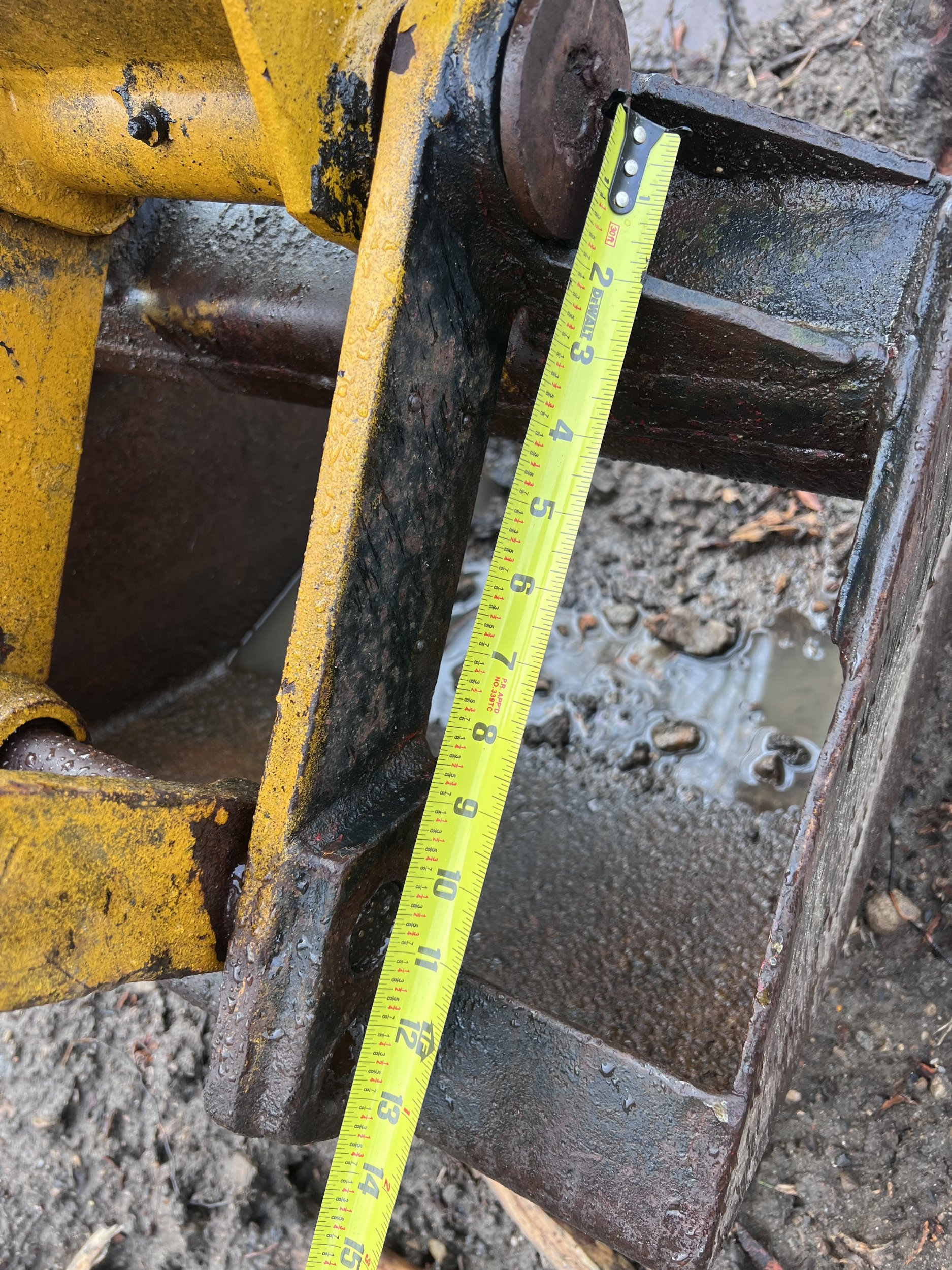

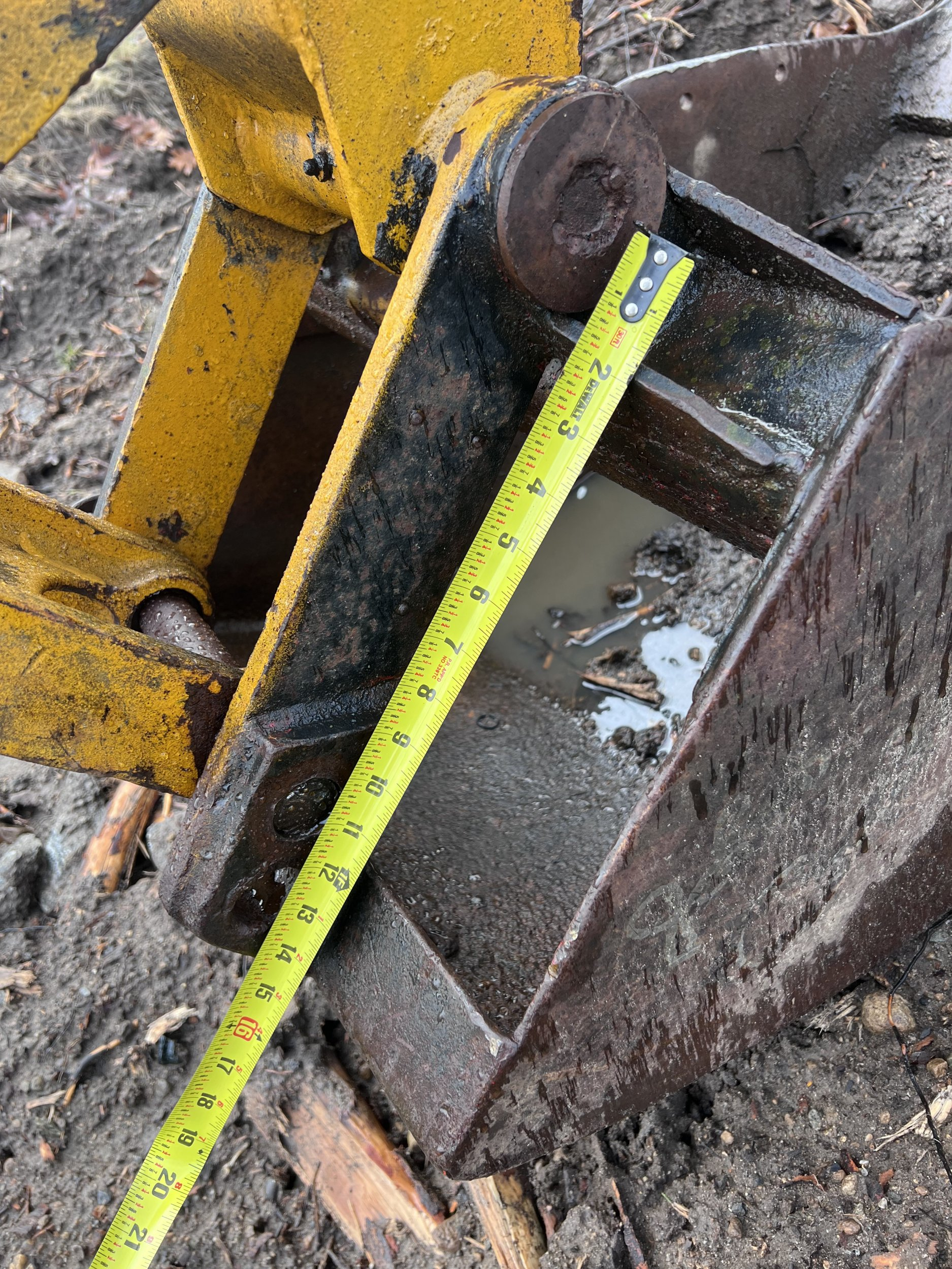

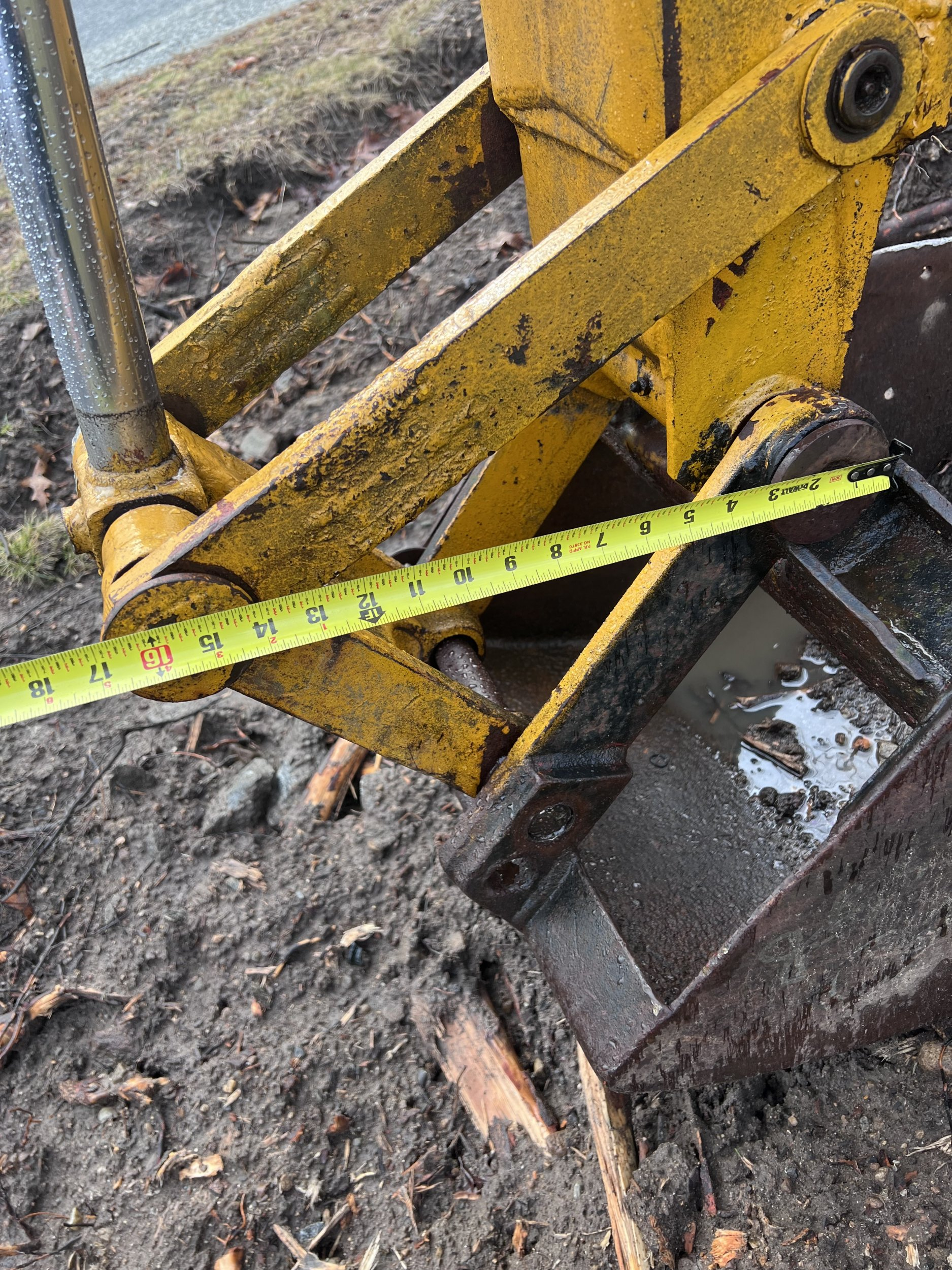

I took some more measurements- hopefully this makes more sense. I also ordered some new hoses and adapters, I hope to get them in soon and try learning more

/ Cylinder internal leak? #30
Still strictly a guess, cause reading a tapemeasure via picture isnt real accurate.
But it looks like the bucket pin holes are @ 11" and 13" and you do have a 3" cylinder it appears.
So simply moving pin holes should be ~18% power increase.
In the current hole you should have ~4800lbs of bucket curl. And swapping holes should be ~5700#
But when the bucket is fully extended and the pins are nearly inline....there is not nearly as much power avaliable. These numbers would roughly be mid-stroke of the bucket.
I still think its a technique and inexperience issue and would encourage you to post a video of you working the hoe, and showing us the scenario/situations in which the bucket wont curl.
