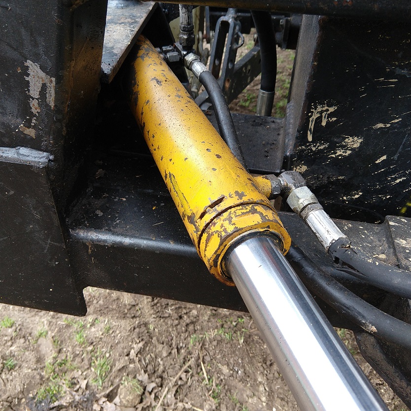

So I recently acquired this backhoe in a less then cared for condition. I found a few issues and have fixed them for current stable use. (other pictures of it posted in the BH use thread and another thread as well, IIRC)
This question is should I try door #1 or door #2? Or do you have a Door#3 suggestion?

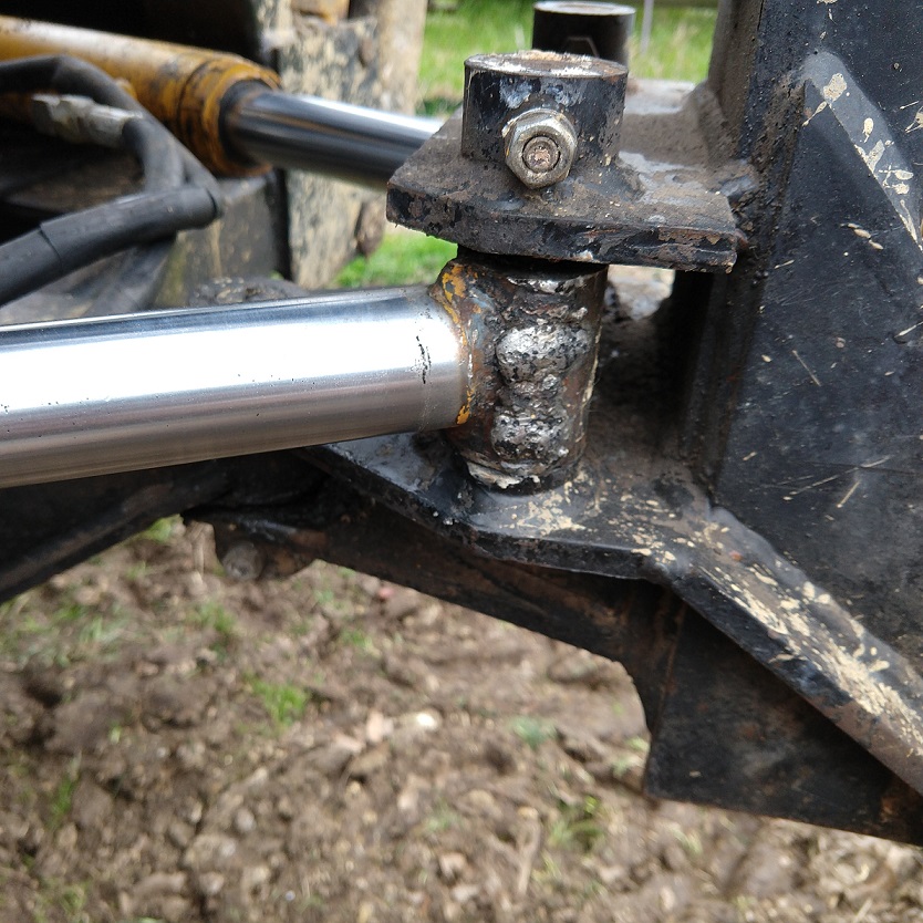

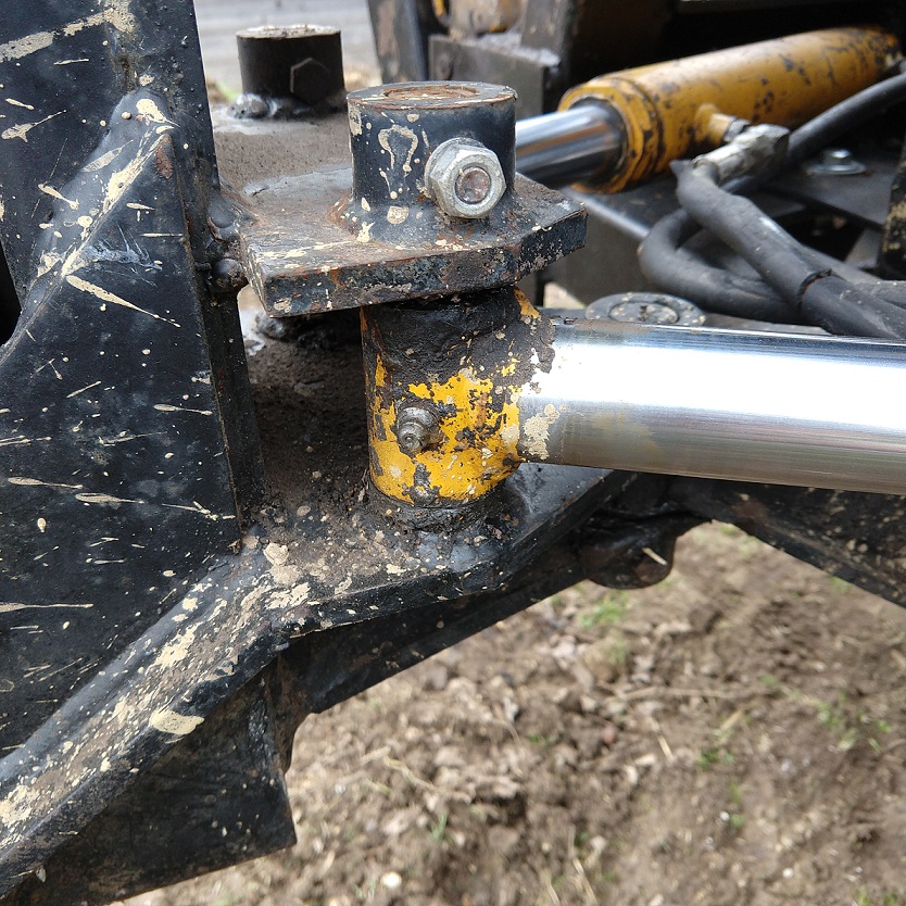

Previous owners decided to just weld the cracked end of the cylinder up and not replace the zerk fitting. I have no clue the condition of the pin or the inside of the surfaces but, it currently functions smoothly with no issue and no return of the crack so far.
I have the PDF downloaded of the manual and a parts list is in it, just don't know (off hand) if its super detailed yet.
Door #1: should I clean the area. Remove pin and swing cylinder out to drill a small hole to be tapped for a replacement zerk fitting? Obviously I want to also make sure I file/sand down the drill sides for safety before reassembly.
Door#2: should I just prepare to replace the piston OR whole cylinder(depending on what is replaceable and available from Manufacturer)?
Door#3: __?__

Door 3... Take it off and, clean it up and drill and tap it for a new zerk. Fugly weld.
   / Cylinder repair suggestions? #3
Agreed. You need some grease in there
   / Cylinder repair suggestions? #4
I agree with above. I wouldn’t try to drill over the weld. Maybe you can get an angled zerk in a new spot. Maybe some cleanup while it’s apart too.
   / Cylinder repair suggestions? #5
Drill, tap and grease.
Possible on the inside or use a 90 fitting on the end.
I wouldn't bother trying to grind the welds down and make it pretty,
not breaking again is more important.
   / Cylinder repair suggestions? #6
Is the back side original? I would turn the shaft 180 degrees and drill a zerk hole on that side and put the weld to the back.
   / Cylinder repair suggestions? #7
That might be possible on the 180 turn, but I would still grind off all that old crappy weld to get rid of the porosity and other defects. Groove out the cracks to at least half to 2/3 of the depth of the parent metal, heat it up a bit to burn out the grease (make sure the cylinder rod is extended completely so as to keep any heat from the oil seals,reweld it. After welding, grind off the weld where the zerk is and tap it to install a new zerk. Do it right and it will never be a problem again.
   / Cylinder repair suggestions? #8
Did you look around for a used one? Do you know if there are bushing in there? You might be replacing the bushings and pins depending on how sloppy it is. Otherwise like said above, pull it off, spin the rod and drill and tap. Cleaning up the weld is up to you and if you are a better welder than the previous guy. If it's holding, sometimes just left better off alone.
   / Cylinder repair suggestions? #9
Since there "was" a zerk, the pin is stationary and the rod end pivots. The pin is likely already scored. Use it until it leaks or breaks. Then take it to a hydraulic shop for an inspection, a new proper rod end, seals and replace the pin.

Regarding the idea of a 180* rotation of the end of the piston; I really like it. IF y'all look at the 2 pics of the zerk and no-zerk, you will see a nut (directly above the zerk/"fugly weld") on a stud that holds the vertical pin in place for the piston to swivel on. This weekend, when it drys out I want to; at the very least loosen that nut, pull the pin out and inspect/test/ triage the area.
If I can get the pin out, I will take pics and seriously clean the surfaces. I will check for cracks, scoring, damage to the inside surface of the welded area of the piston too.
I will also *TEST* to see if a 180* flip is possible too! If not then I will try to take a picture or two to show mock-up locations of possible new zerk or angled zerk site(s)? Sound reasonable?
And as a band-aid to the situation, I will also give all metal surfaces a fresh slather of the either the Moly-B &/OR marine grease i have on hand when i stick it back together while figuring out the best and safest course of action with y'all input.
A side note. I would like to gently grind down some of that slag-looking crud too. Welding skills are really rusty. I've only done a couple little repair jobs with a wire feeder over the last few months... prior to that it was almost a decade ago when I last "scratched an arc."
And obviously I will update more after this weekends inspection/triage effort. Thanks y'all.
