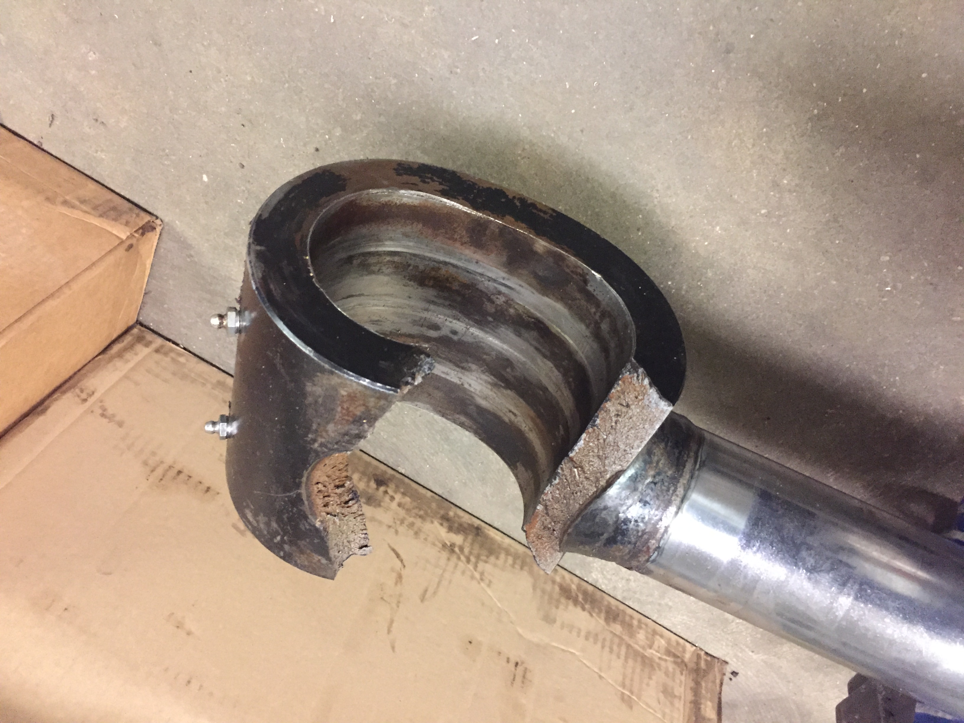

Is the back side original? I would turn the shaft 180 degrees and drill a zerk hole on that side and put the weld to the back.
This ^^^. There are no awards given for pretty welds. The reward for a successful weld is a useful part.
   / Cylinder repair suggestions? #12
I was primarily thinking that it would be easier to drill and tap there, less chance of hitting a hardened weld pocket and breaking a bit or tap, which would be a big problem in its own right.
I will quickly admit that i a$$umed that the idea of flipping it was for a much more flat/uniform surface for the drill/tap & installing a replacement zerk..... IF the inspection shows it can happen. (fingers crossed)

I would cut off the old rod end and make a new one out of scrap steel, bore it .010”-.012” over the pin size, weld it and go digging.

More than likely this is what happened.....and they smashed it back together and welded it.

And just a few moments ago, a call to CSR... Worst case pricing is -> The piston/Rod itself is ~$80+ & the seal kit is ~$36 so if I have to order replacement it'll be about $150+ with shipping included via UPS.
1) Rod Assembly Part Number: SCY10006
2) 2” x 1 3/8” Rod Polypack Seal Kit Part Number: 99-001-093
On the best case pricing -> The piston is supposed to be spin-able to have access to other side for drill/tap for a zerk.
So All I'd be looking at is a Zerk fitting?
As I have drill bits and Tap kit that "should be small enough."
