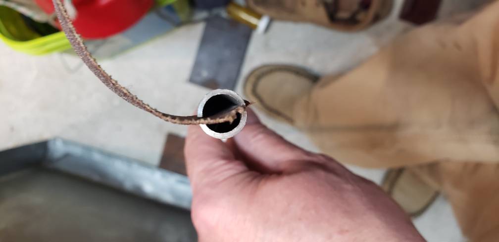

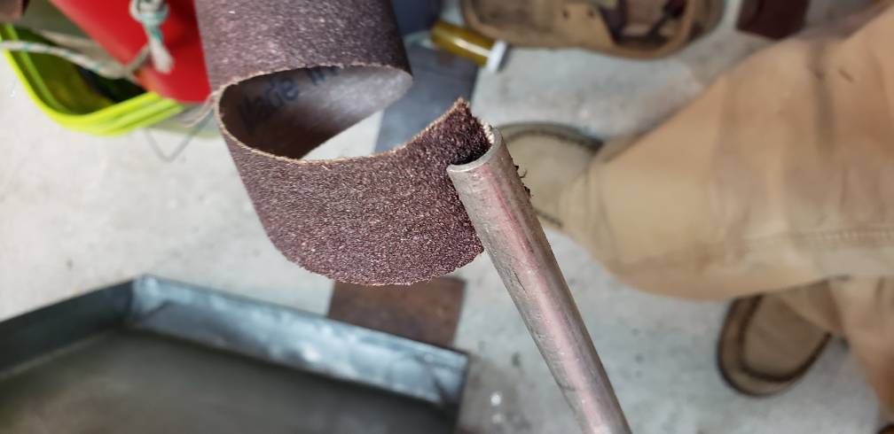

If you can turn the rod end so you can stand right over it and drill down, there is less likelihood of breaking a bit. When it does punch through, it will probably leave a nasty burr inside, I'd remove it with a small sanding drum on a Dremel but am curious to how others would deal with it, if they didn't have that available.
   / Cylinder repair suggestions? #25
No dermal tool needed.
Take a piece of rod, slot in end, add sandpaper, chuck into drill. Instant rotary flapper! Have used this trick to smooth out internal problems.

Yes, I planned on trying that method & that angle of attack too, for drilling. It's easier on my knee.
As for cleaning up any Burr's etal....
My initial go-to is a set of mini files. Very gentle files. About 4-5 inches long and at most 1/4 inch wide surface. Some are flat some are rounded. All are very fine teeth. Then I was looking at using some sand paper and steel wool to finish it off?
All this I have on hand.
BTW Topzide's idea is very cool too! I can visualize it. But.... Maybe he can post a pic of his own? I'm very curious about the dia and the depth of the slot.
Nite nite y'all. We have almost 2 full weeks of rain forecast where it's 40% or greater each and every day. Sheesh.
   / Cylinder repair suggestions? #27

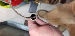

This is what I had fashioned for my fix. Can be solid or tube. Image%20(1).jpegImage%20(2).jpeg
