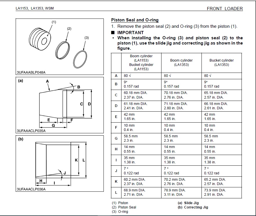

Have you read the loader WSM on hydraulic cylinder seal replacement?
Properly done Kubota would have you make two special jigs. They do not sell these special tools.
The slide jig is to stretch the seals over the piston in a smooth uniform manner.
The correction jig is to compress the newly installed seals so they will fit inside the cylinder.
Anyone can stretch the seals and get them into position. The downside to this is a much shorter life expectancy.
Big Kubota dealers like Messicks have acknowledged that their techs do not use the special jigs but instead use the following procedure:
Here is an email from Messick's re the LA463 loader hydraulics.
Good afternoon.
I apologize, it does state to use special tools(slide jig and correcting jig) to install the expander and piston seal.
However, it instructs you or us as a dealer to make the tools.
We do not have these tools.
Our technician informs me that he would heat the expander in water or oil and install it manually into the piston groove.
He would then install the piston seal over the expander.
And then he would put the piston with seals in a refrigerator for a few minutes, which will shrink the piston seal over
the expander
and allow the installation into the cylinder barrel.
I hope this helps, if you need more information, please let me know.
Thanks, Tim
Tim R. Marholz
Messick's Technical Support
Whatever you decide to do, just go into the job fully informed.
Dave M7040

I'd be giving it a go with a pin spanner or a pipe wrench. Yes I know it's not the correct tool but you gotta do what you gotta do. I'd make sure the gland nut was loose before removing the cylinder from the machine, it's be a far sight easier to loosen the nut with the cylinder held firm with the pin...provided you can get at it that is.
As for warming the seals in oil or water, use oil. An old timer told me if you use water to warm up a seal. make a cup of tea with the water when you're done and use the seal as a coaster because you just ruined it.....................Mike
