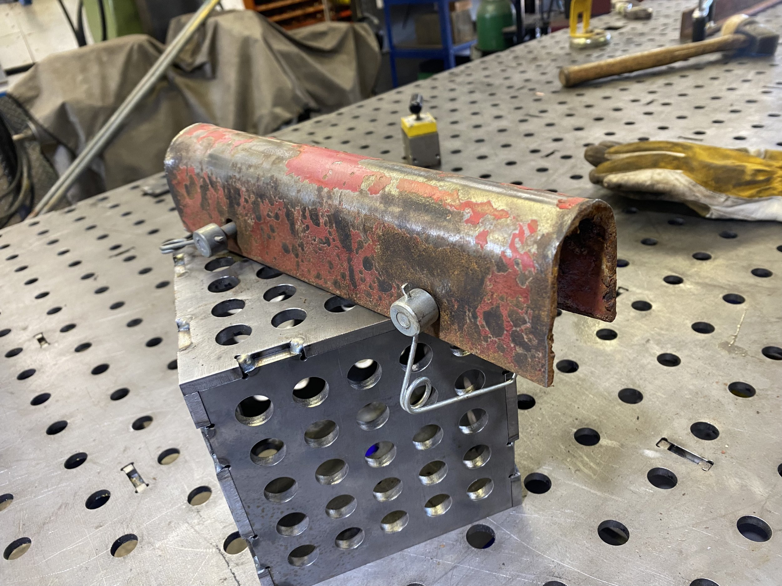

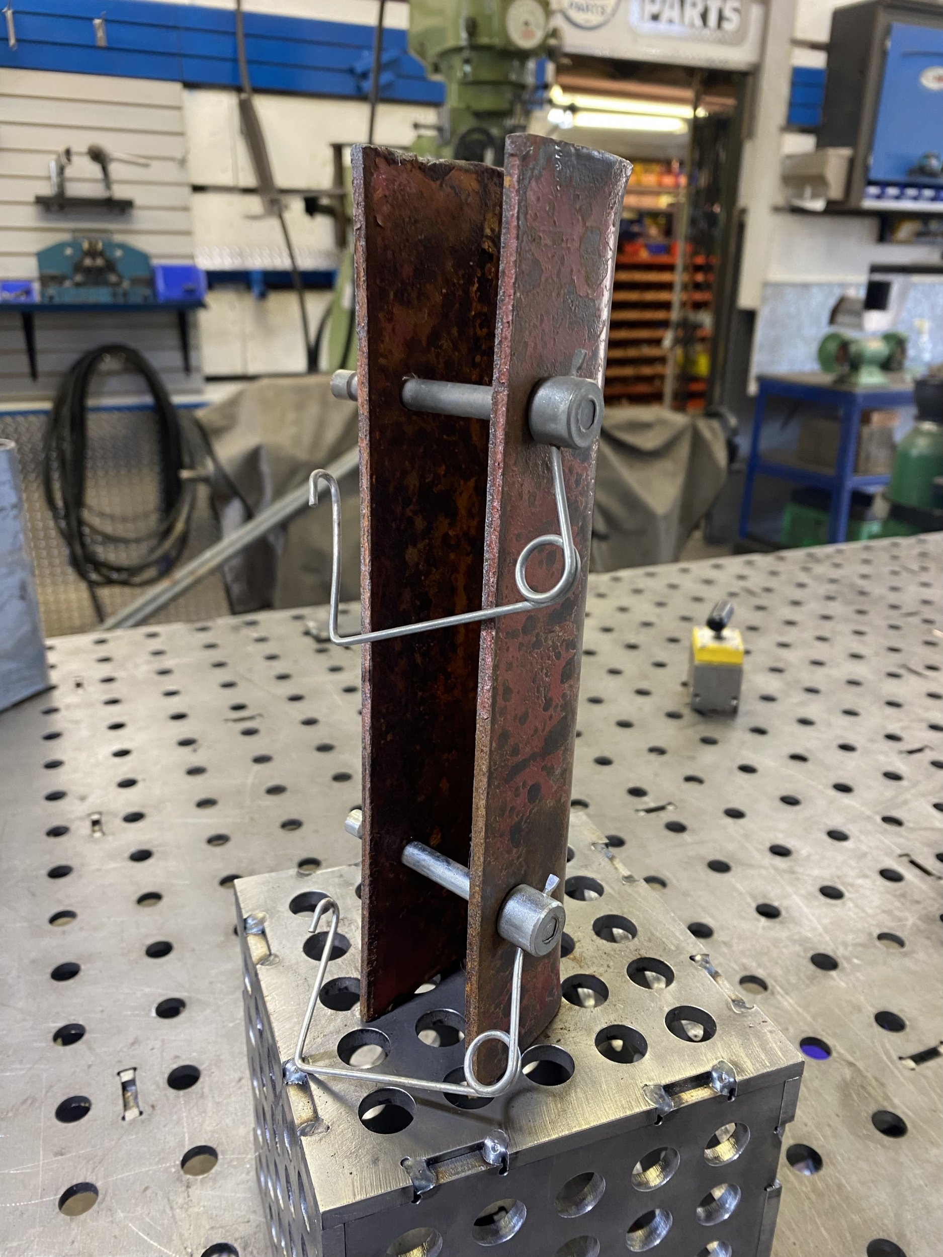

I make my own...
For FEL have something like that welded on each end of an appropriate length of angle iron.
