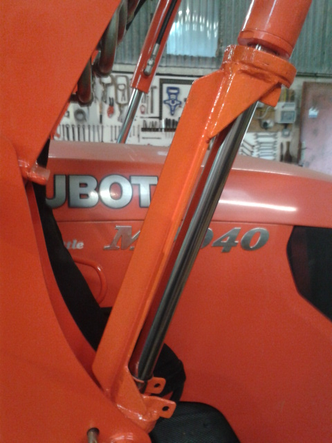

This is the prop that I made when first I bought my Kubota M7040 with a
LA1153 loader. The prop also fits the MX loader that I now have on my 50 hp Kubota. I cut a couple of washers into horse shoe shapes and welded them to some T section scrap that I had. Some half inch plywood was glued onto each end to provide protection for the ram end and the pin tube. I only made the one, as it's only ever fitted for short periods of time.
