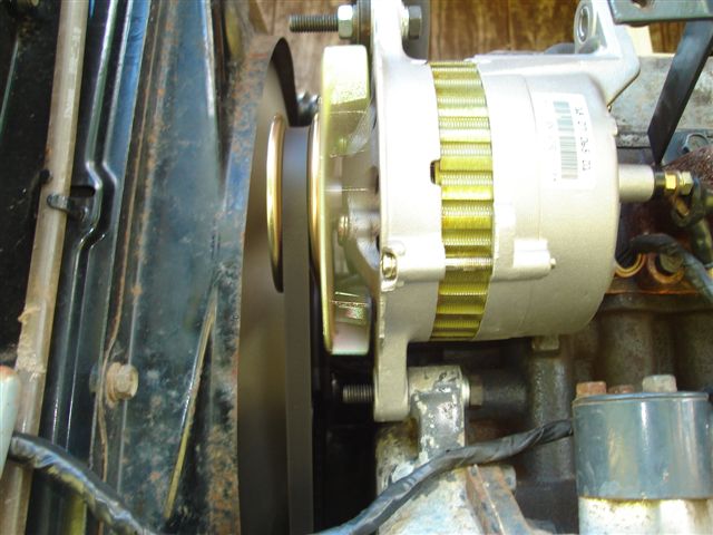

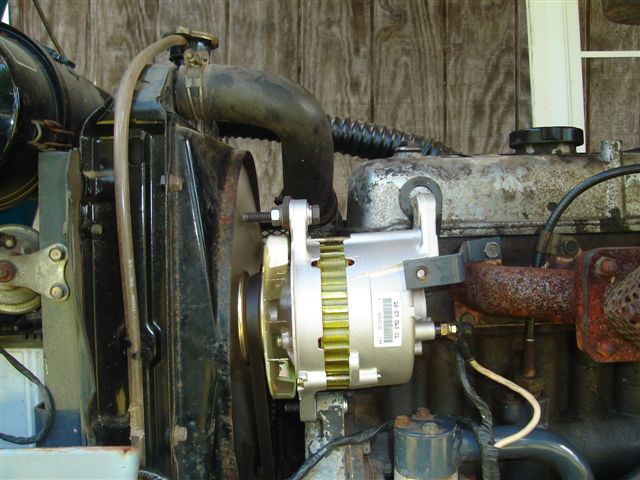

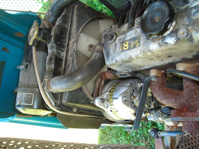

i looked into the alternator for the ford courier 1972 it is such a close match that i bought one. the bolts do not match up to get it to fit normal with the existing bracket. the connections match up perfectly.well what do i do?here is what i did: i went out and got two, two inches metric bolts with washers. then i hooked up the wires ,flipped the alternator around and bolt on the adjusting hole on the bottom. then i put the other bolt through the hole on top and use a nut to bolt it on.the bolts sticks out a little.it does not look pretty but it puts out 13.5 volts. the cost about 60 bucks.i took some pics :

managed to put up the images. the adjustment on the alternator is maxed out. this could be a good temporary fix i think. any one care to make a comment? the pics were taken with the enging running.
/ d 1850fd charging #11
Hey, that looks fairly permanent to me. Good job and thanks for sharing.
/ d 1850fd charging #13
Now all you need is a smaller belt, that will give you some of your adjustment back. Good job.
