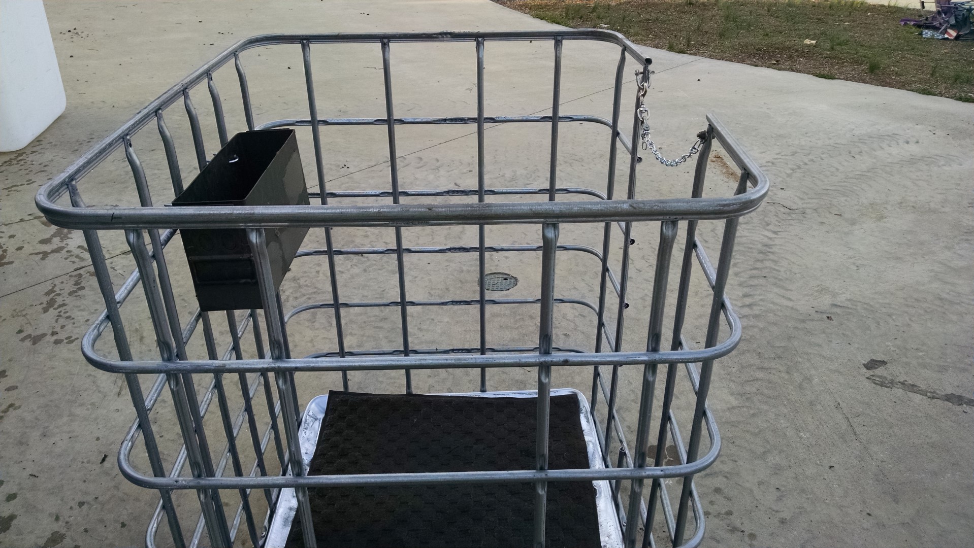

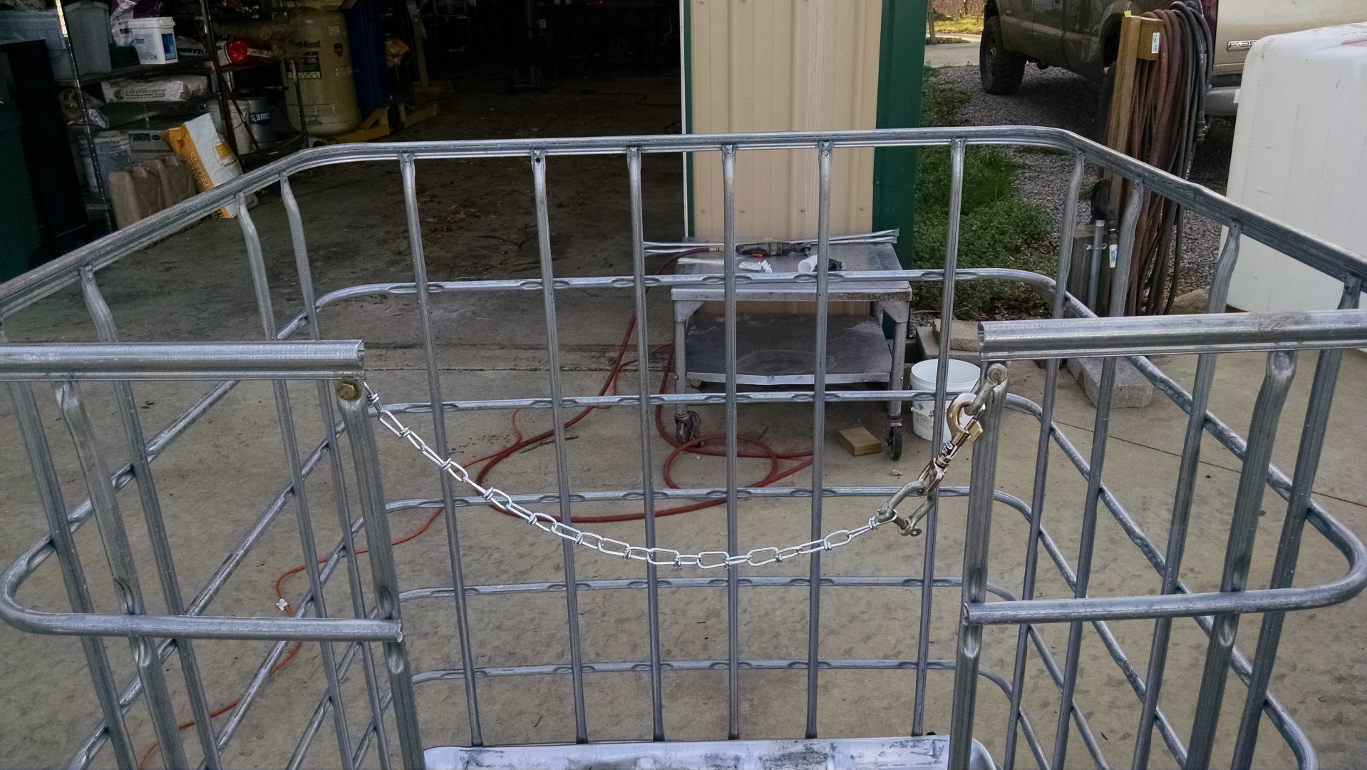

Daddy has a new bag!!! Tractor Work Platform

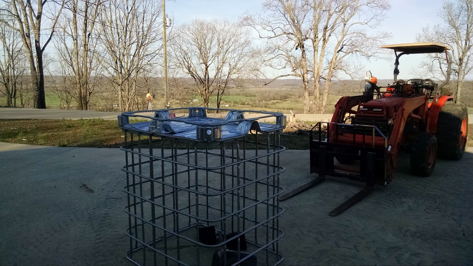

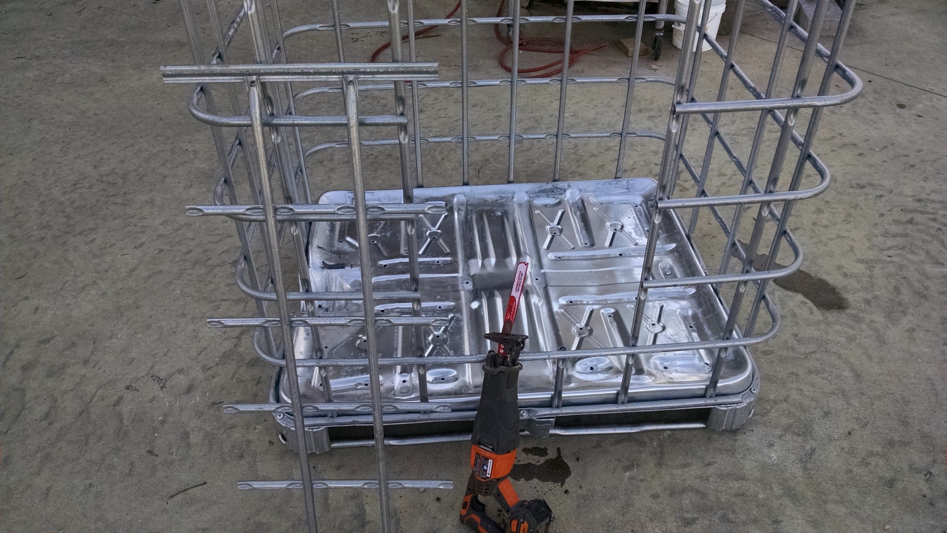

I have been needing a platform also I may have to try this. did you fix a way to secure it to the tractor, if it skids off the forks it will hurt.

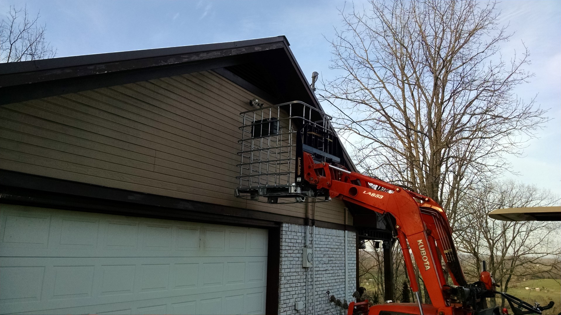

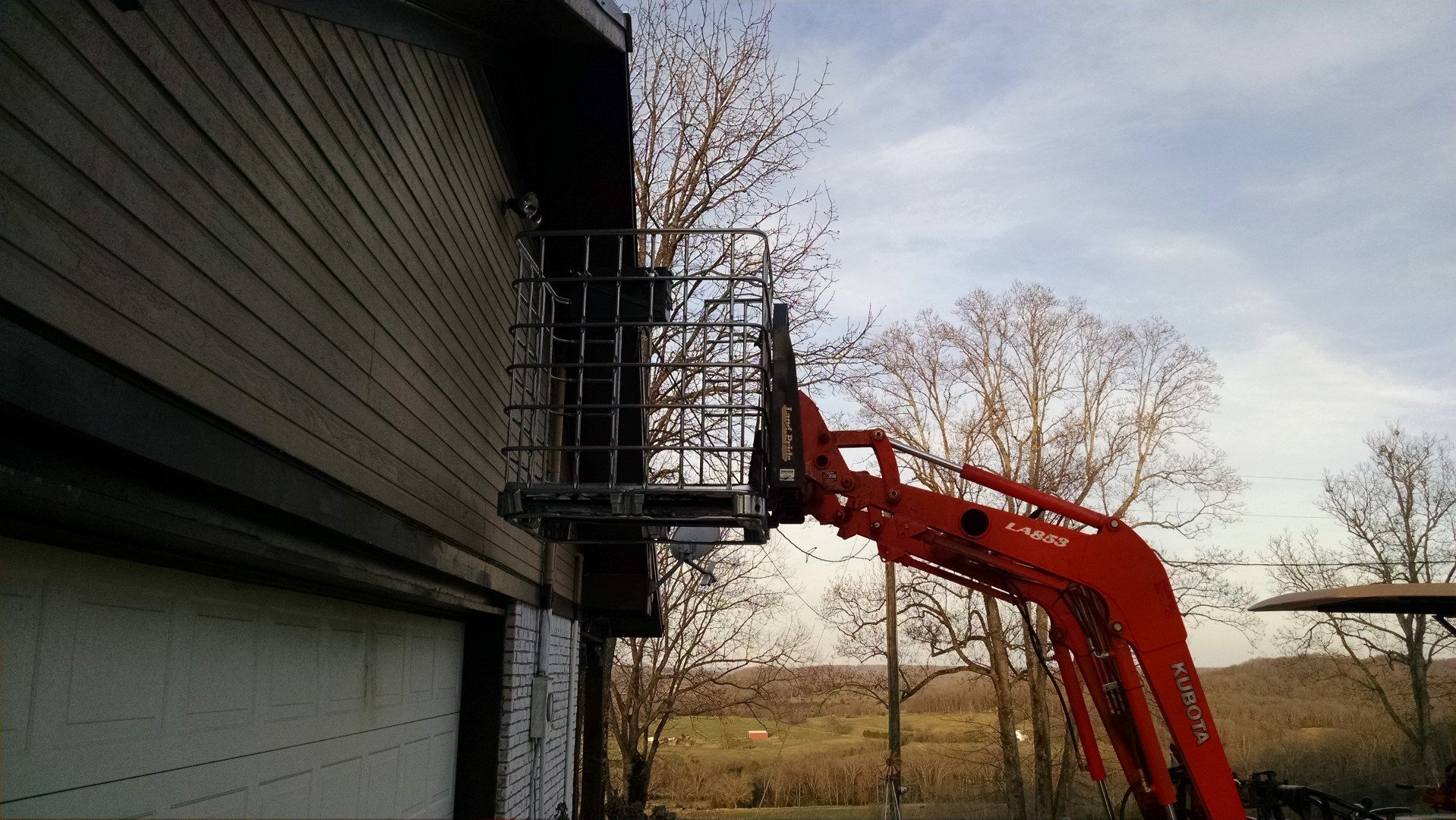

How do you get up there? Rely on another driver or from a ladder?
In the last pic, you can see the 1" ratchet I used to secure it to the tractor forks for just posing for the pics. When I use the platform at height, I'll use a 2" 3K lb WLL ratchet strap to keep it tight against the fork body.
The last paragraph: "The bottom of the tote is just above 8', so I could reach it using my 8' ladder. However, I'm really hoping I can teach my wife enough to use the tractor to lift me up while she's in the seat."
I haven't used it yet for real, just had it in the air for pics. I gotta feeling that +99% of the time I'll be using the ladder. Training my wife to use/drive the tractor may be a hill too hard to climb.......

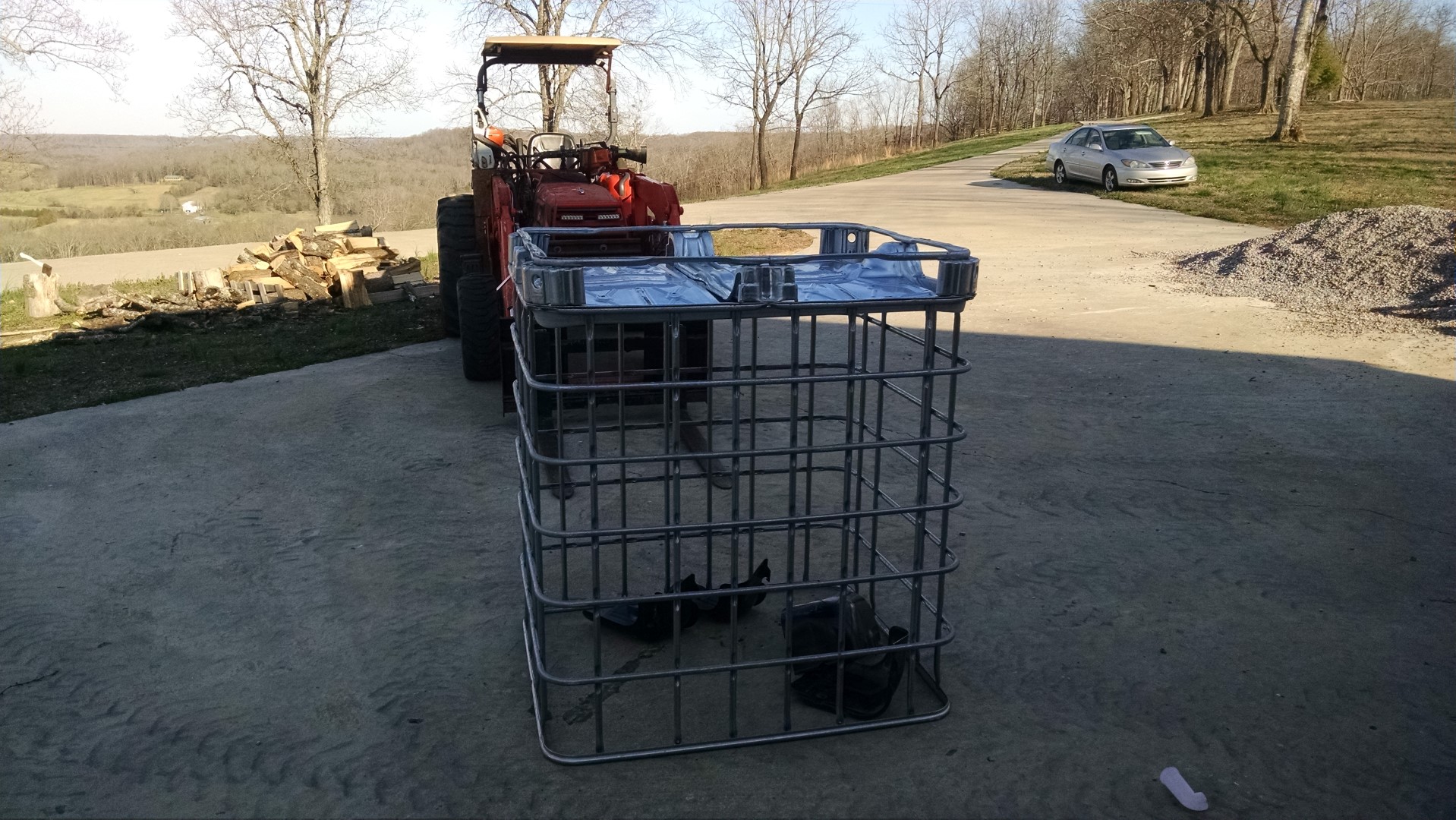

If you do go the wife route, I would advise spending about a day having her operate the basket/tractor with some weight in it (not you) It will react differently with and without weight, and I hope your tractor has an hydrostatic transmission, that will make creeping toward the building much easier especially for an operator without years of experience.
I would also suggest that you do the absolute minimum of travel with the basket. In other words, get it set up on level ground right next to the building so the operation will just consist of raising and tilt, not much ground travel.
She will have to get used to the idea of moving up a bit and adjusting the tilt, and repeating that motion. It also depends, on the person. Some people have steady nerves and a steady head. Some don't. I would trust my life to some people and have, and others, meh, not so much.

Thanks. I've always relied on a ladder because I'm too scared to rely on somebody at the controls not dumping me. I know a guy that had is son in law, who is an Air Force fighter pilot, run his tractor while he stood in the bucket trimming branches. It worked great until his son in law got too close to a branch that flipped him out of the bucket and onto his back on the ground!!!!
That pretty much kills that idea right there. There's no way she'll spend a day learning a tractor.
Absolutely agree on the minimum travel bit while in the platform.

Got to use the work platform several times over the last couple of days.
I replaced incandescent flood lights with LEDs in two light fixtures. One of them could have been done with a ladder, the other was too tall for my 8' step ladder. I'm not pleased with "flood" aspect of the lights, too "spotty" but I can live with it especially since now I won't be having to replace them all the time like I did with the incans.
Then I installed the 7280 lumen LED outdoor light about 16-18' up in the air yesterday: Holy Cow is that a bright light!!!
So far it's been very easy to use and far more convenient to use than climbing a ladder all the time with tools, fasteners etc. Load up the platform, lift it up and position it, put ladder up then go to work, easy peasey.

/ Daddy has a new bag!!! Tractor Work Platform #11
Very nice, FTG-05. Put a safely harness in there, and OSHA might even approve. :laughing:
I really like the rubber mat addition.

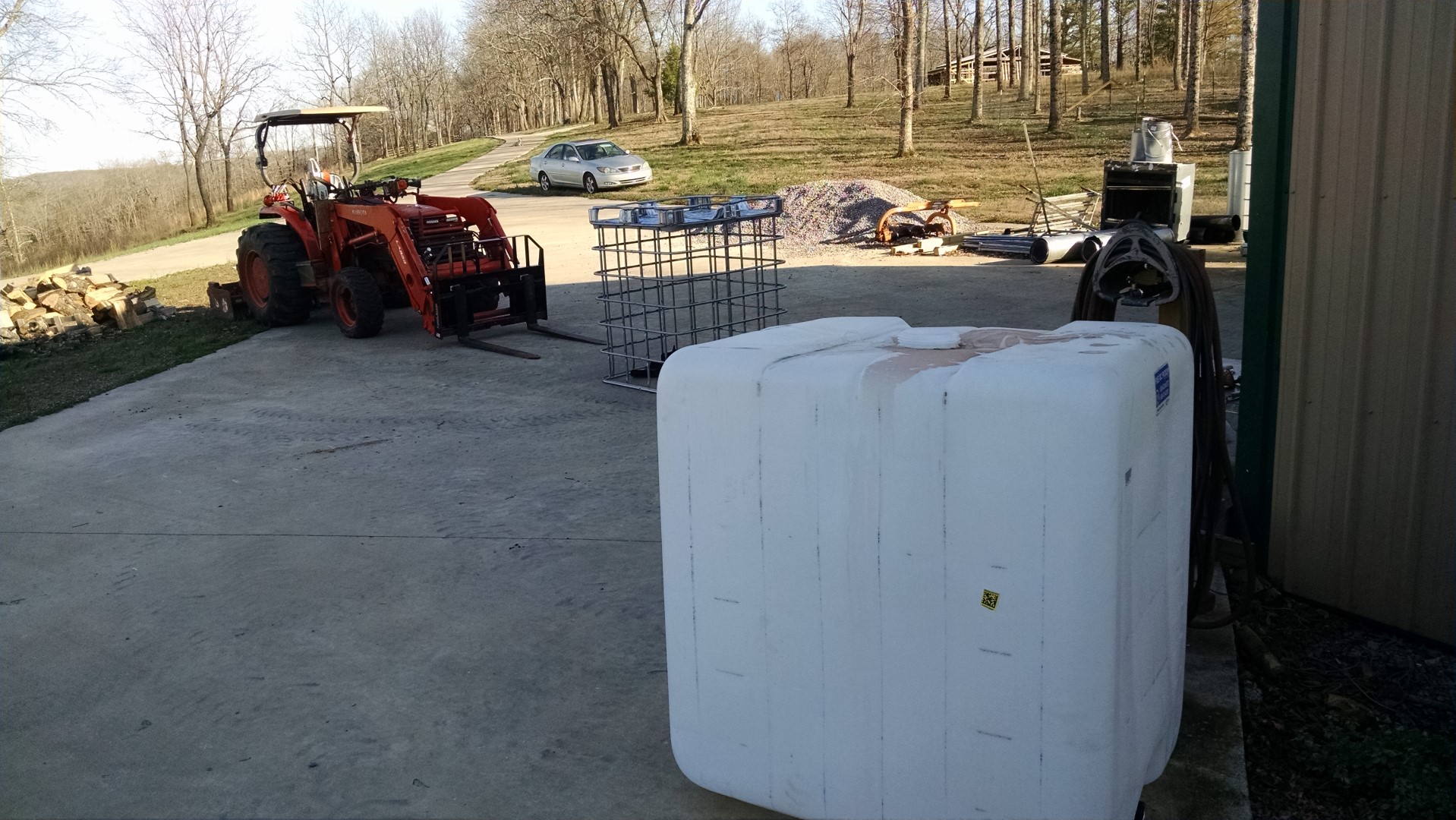

I wouldn't mind making one of those FTG. Which Craiglist edition was that in? I live in middle TN so if it is in the Nashville edition, it might be handy for me to pick one up.
#13
It was in the Hsv CL, but it might have been in the Nashville one as well.
Here's the ad: 33 gal totes

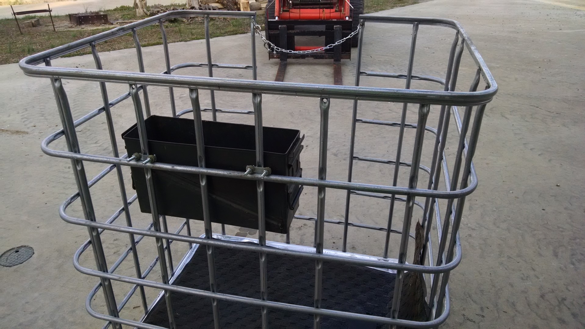

/ Daddy has a new bag!!! Tractor Work Platform #17
I really like the man-lift cage you made. I fabricated my own many moons ago and a couple of safety recommendations.
1)Try to get your better half to operate the tractor when you need to load, move, transport stuff that makes for a safer two person project. As an example whenever I need to back the tractor out of the shop I ask her to do it while I check for clearance. Over time she has become a safer operator than me, albeit my pickup took a pretty good hit when she was unloading garden fertilizer.
2) Always double check your quick attach locks. I tilt the cage all the way forward to check the locks from the driver's seat and check the reliability of the two safety straps. Now that I'm in my golden years and no longer bounce well I also use an independent safety harness with fall stop protection.
3) We use two way radios when working at max height because a cab restricts line of sight for the driver.
4) The tractor is never moved with the FEL up, we always re-position first and then raise the bucket. In the past twenty years I'm guessing around 40 plus hours spent safely 'in-the-cage'
5) Last, but most important, don't stand in a standard compact bucket at height, there is nothing to hold on to, and even if you bounce well, it could be a very bad day
