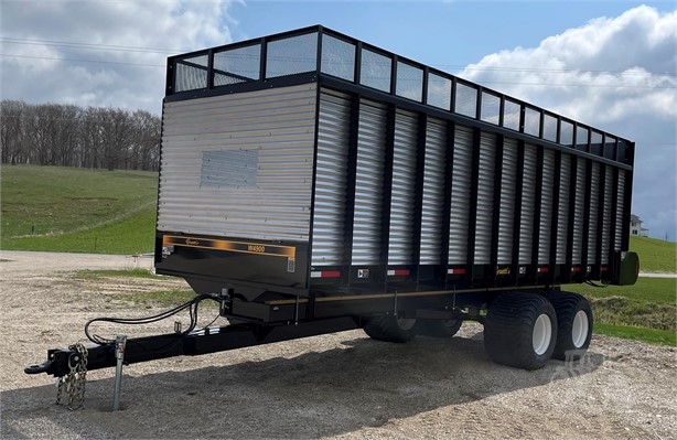

Here's mine getting it done!

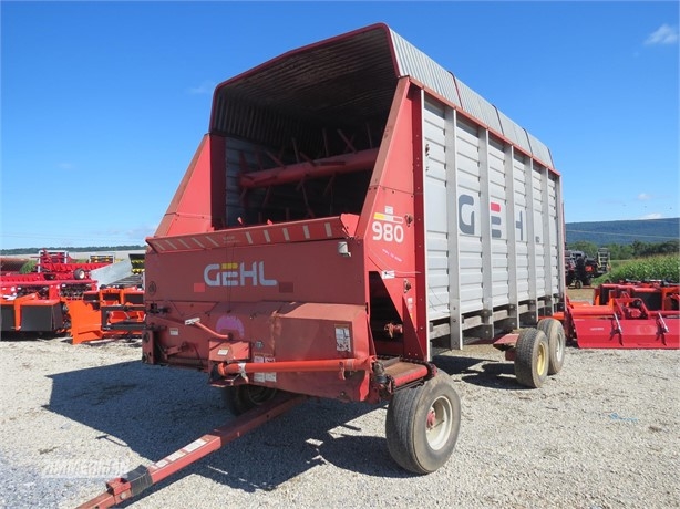

Never had that issue and I've pulled my fully loaded (overloaded) GN numerous times with either of my M9's in the past. Top speed in 12th gear is 22 mph, not warp factor one by a long shot. 27 4x5 densely packed round bales is a gob of weight.
Heck, back when I ran idiot cubes, I've pulled a fully loaded tandem axle hay rack with my quad as well.

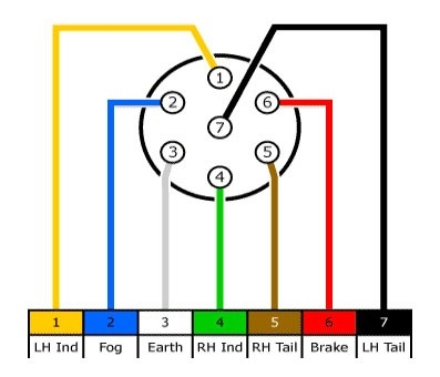

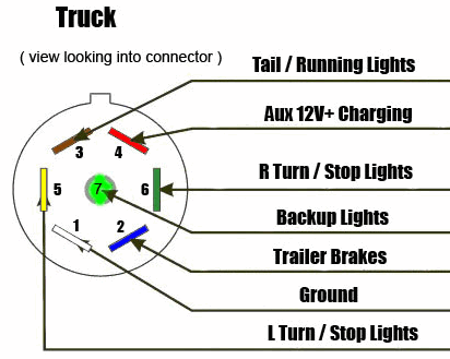

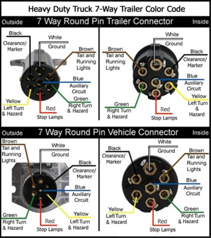

The tractor has a 7-pin trailer connection. 6 around the circle, and one in the middle. The pins themselves are round, not flat blades. Unfortunately, none of this means much to me. I just don't know enough about trailers, but I'm trying to fix that.
You have what is called an Industial connecter on the tractor, if the trailer has the 7 wire rv plug you will need to make or buy an adapter. Most of the industrial connectors have separate turn and brake light feeds.
