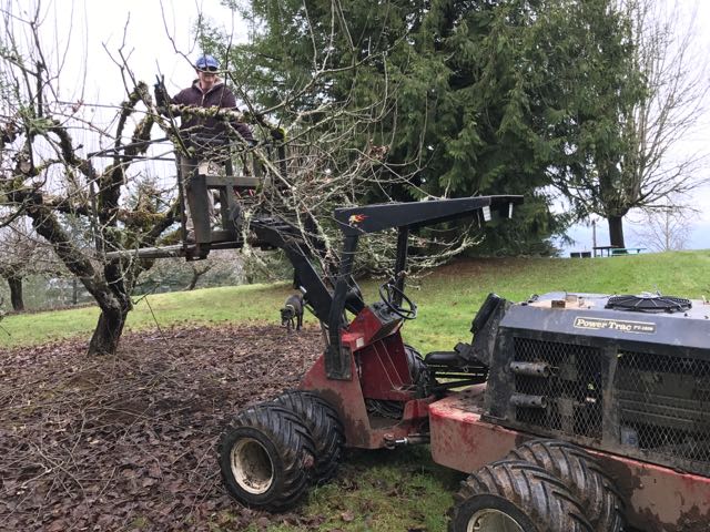

I made my own lift basket for my machine. We use it a lot, especially in the orchard.
A few notes... The flooring is super important, getting a mat is crtical IMO, My first version was made of a plastic pallet bottom. It proved slick in the rain (which is constant here) THe second incarnation is some scrap floor grate metal (metal tread my neignbor had). Not fun to kneel on but not slick at all and debris just falls through.
Highly recommend the wife learning to operate. As these machines are not really designed for this, whenever you are moved my rule is you kneel down and hold on. But having someone able to move you around is far safer IMO than the ladder method.
Likewise, If I have to operate on my own, I climb up the lift arms. Now this is easy on my machine, but I feel going up the lift arms is a lot safer than a ladder propped against the basket.
Oh, I rigged up a metal strap system that goes over the top of my pickle fork back to hold the basket in place. IMG_3315.jpg
Oh, I rigged up a metal strap system that goes over the top of my pickle fork back to hold the basket in place. View attachment 502707
Just so you know (sorry no pics) I don't prop the ladder on the basket. I use an 8' step ladder and the ladder is always independent of the basket.
