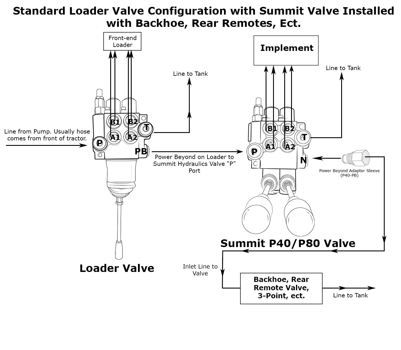

I bought a second loader valve for my tractor to operate the top and float on the 3-Pt.
I have the mounting and hydraulic connections figured out, pretty much just follow thee picture from the Summit Site
The only question I have, is: Can I run the tank line on the first valve into one of the tank ports on the second valve, and then run from the second tank port to the tank?

Are you saying your 2nd valve has more than one tank port? IF that's the case you probably could do that, but i'd verify the port you're thinking of is actually a '2nd/alternate tank port' vs something that is plugged for a reason!
Or, the 'safe' option would just be to Tee the tank lines together outside the valves.

Yes you can. The only oil that flows thru them is the return oil from the opposite, non pressurized end of the hydraulic cylinder or the return from a motoring spool. The actual flow from the pump runs thru the PB port that's why you need the PB plug so you don't pressurize the return circuit when using a downstream valve.

Yes you can TEE the tank/return lines but thats it. Cannot tee the pressure or PB lines

So im trying to work this out in my head having never actually worked with a closed center system at all.. But in open center the pressure and tank ports are connected until you shift a spool (or install a power beyond sleeve). In closed center the pressure and tank ports are NOT directly interconnected. So if both tank ports were connected internally, there would still be a path from the pressure inlet, to the 'open center' tank port, over to the 'closed center' tank port. So they are likely not interconnected internally UNLESS the plug in the closed center tank port is not a simple short plug but actually extends in further and intercepts/blocks a passage, sort of like a power beyond fitting with no way out.
I guess you will know as soon as you unscrew that plug and look!
