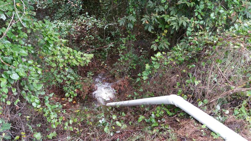

Well we were able to get the over flow pipe unplugged, which is helping quite a bit. I also got a 4 inch pvc siphon going. I'll probably end up putting together another one this afternoon. Hopefully we can get the pond safely drained in a few days.

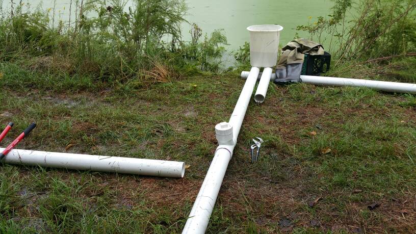

Here is the siphon pump that I built - it took about four trys, but it finally started working - quite well I might add!
