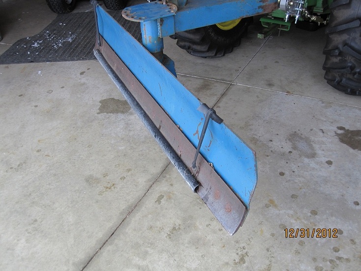

I used a piece of polyethelene 2" pipe split first to see how it worked and it did a great job though I did have trouble keeping it from slipping off(some have suggested using abs pipe). Then I took a piece of 2" piece of galvanized and split it along its length and wedged it over the cutting edge of the bucket and welded tabs onto the ends and bolted it through the holes where my tooth bar goes. If we ever get enough snow to push I will install it and put to good use. I use the rear scraper blade in conjunction with the FEL.

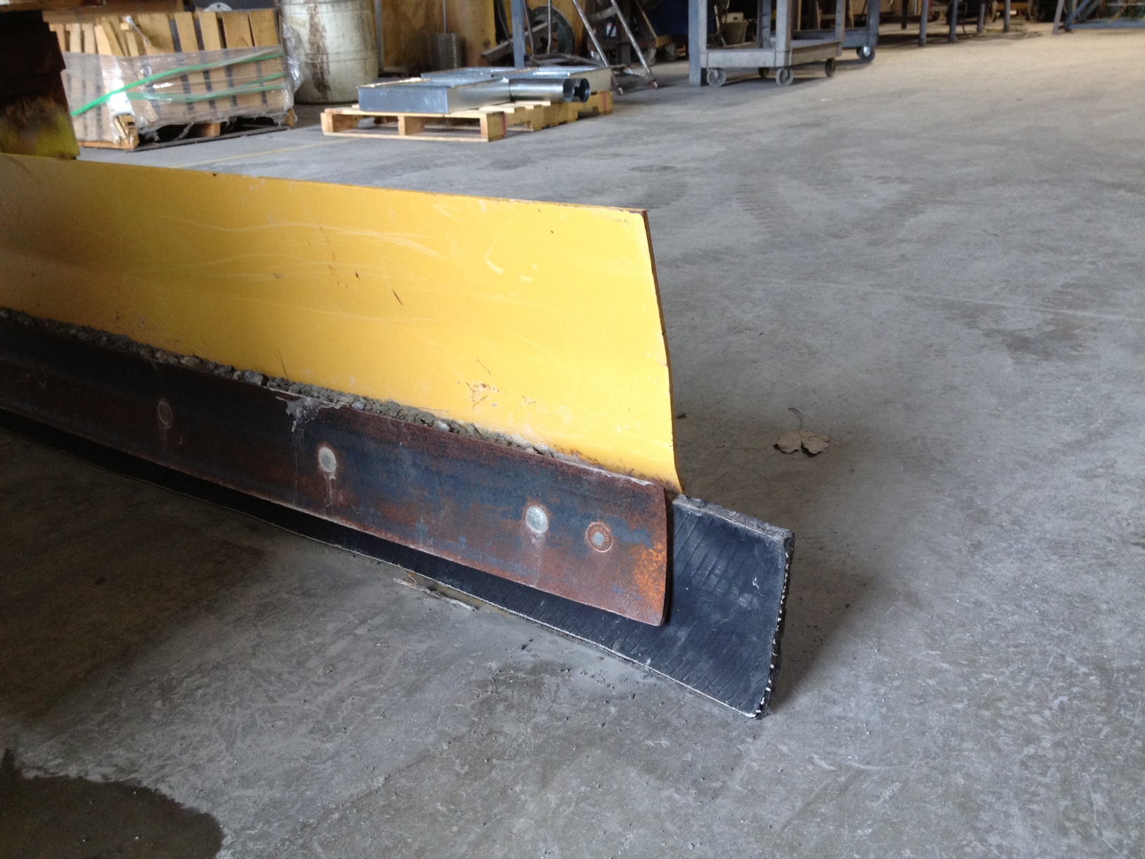

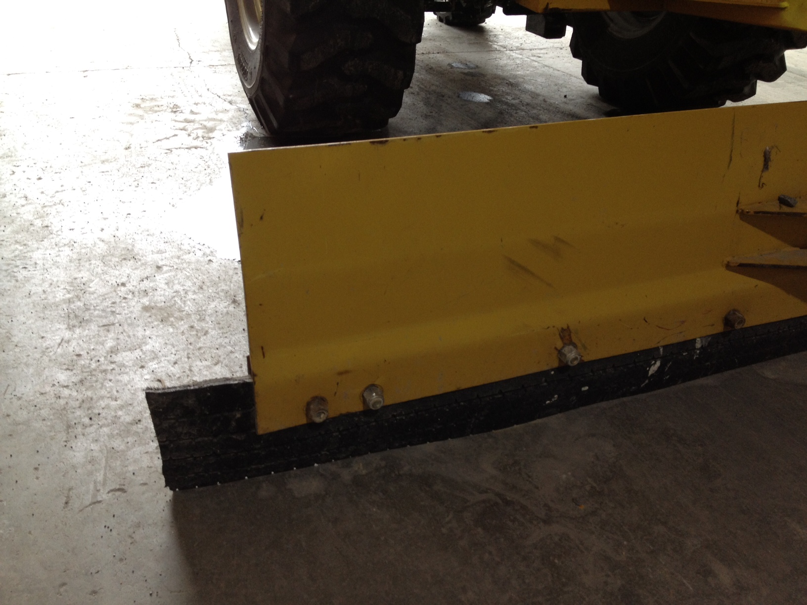

Here's what I came up with for the tractor at work. It's the tread portion of a tire sandwiched between the blade and the cutting edge. Bumped into the maintenance guy today and he said it worked great. On the stoned areas it deflects itself enough to allow it to roll over the stones. On blacktop it acts like a big squeegee.
Edit to add - Today our maintenance guy sprayed the finish paint on the cab I'm building and now he wants one for the company tractor. He smiled when I told him I already ordered and received the material.
