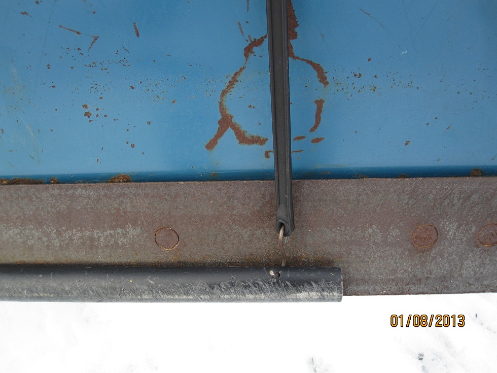

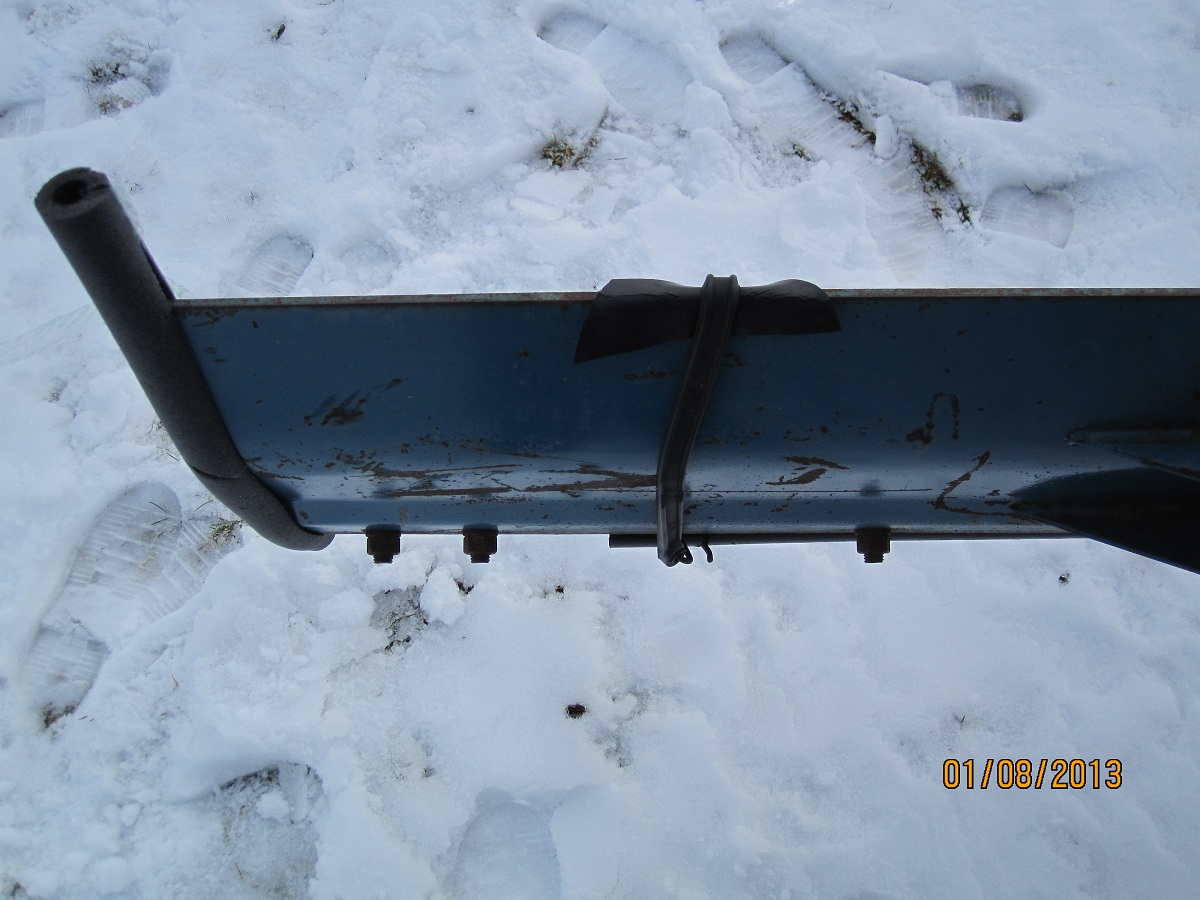

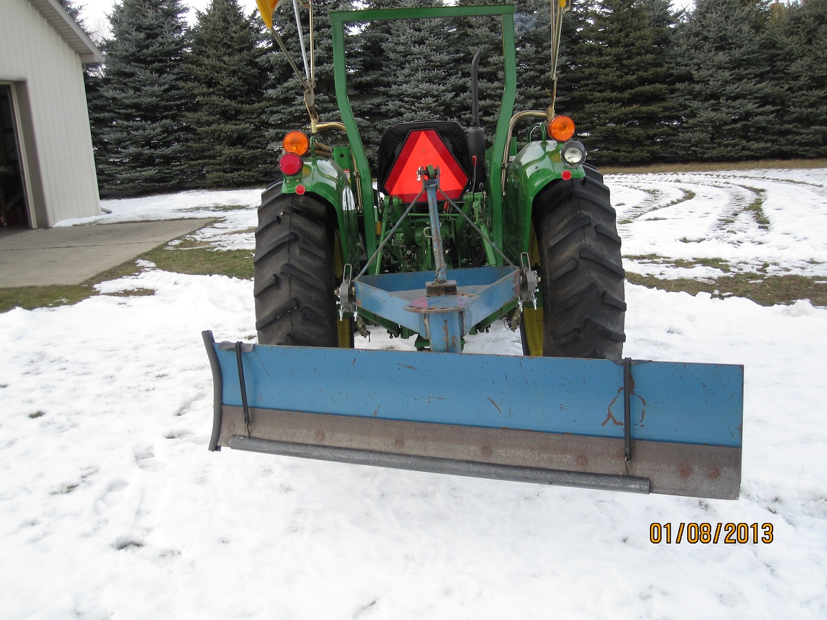

It is 1.5" black PVC pipe slit down the length and two holes drilled on each end. The bungee strap hooks in one hole goes over the blade and hooks in the other hole. You can plow in either direction and it does not come off. IMG_0276.JPGIMG_0273.JPGIMG_0275.JPG
