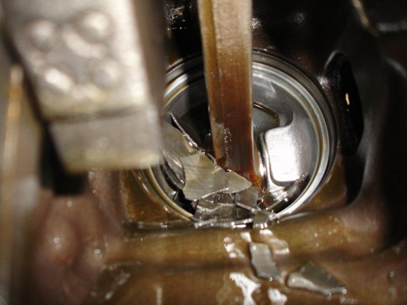

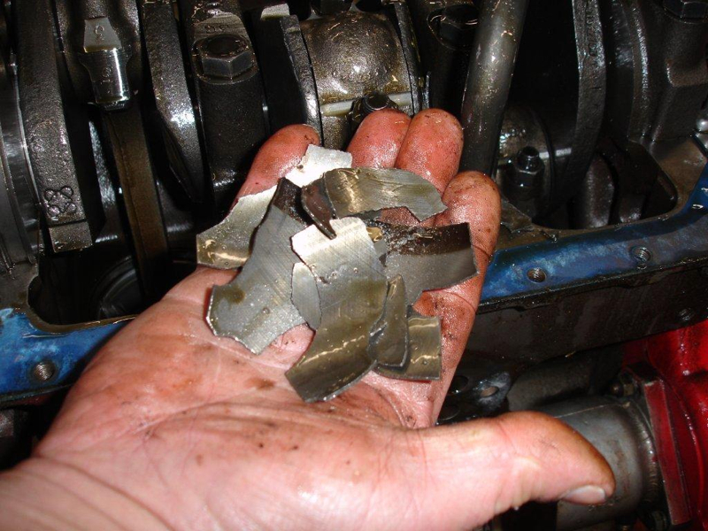

This would be a decision I would leave in the diesel shop's hands. This is what can happen with a improperly sized sleeve
it work itself loose?
   / Damaged block installing block heater L5240 #224
I am not sure since the rebuild was done by the previous owner. I bought the tractor used for a prayer so no big deal. After the rebuild I had about what it was worth into it. That picture was from #1 cylinder, #2 was snug at best, almost could push the liner out by hand and #3 was fairly tight. Redid all three cylinders about 5 years ago and pressed new liners in solid. No issues to date, runs like a new tractor. (Perkins engine)
The guy I bought the tractor from said, and had paperwork from, a reputable diesel shop who "did the rebuild". But after calling the shop subsequent to the sleeve failing I found out they only did a repair to a broken flange bolt mount. The guy I bought it from must have done the liner work. The liner gave away and about 10% of it ended up crunched on top of the piston and the rest below. I figured it was "working" (moving) with each stroke and fatigued. The head and block checked out after a magneflux as okay. So properly relining a cylinder should be done by qualified professionals in my book.

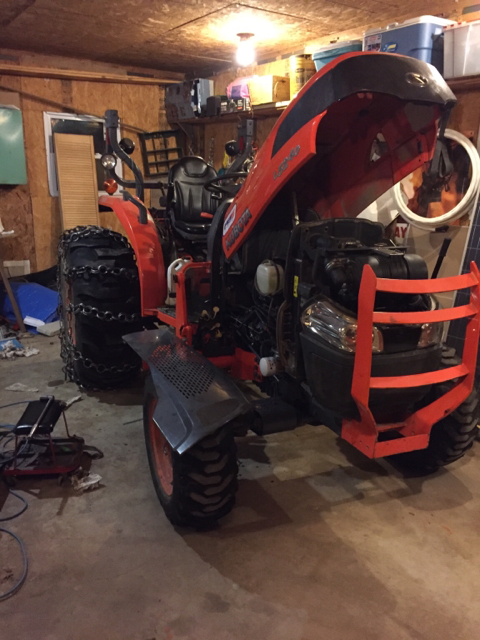

I had two things to take care of tonight.
1). Install a block heater.
2) replace the rubber suction hose that connects to the hydraulic pump. It's cracked and sucking air, causing power steering problems.
Instructions on the block heater call for removing the hydraulic pump to access the frost plug closest to the flywheel. No problem. Area is very tight with the remaining hydraulic lines (steel) surrounding the area of the frost plug. I had the loader removed, but the quick connects were also in my way.
I then took a long Phillips screwdriver and tapped against the edge of the frost plug. It went in maybe 1/8" and stopped. Took my cordless drill and drilled a hole to see if I could pry it off with a pole barn nail or something. Drilled a couple more holes. Finally got the frost plug to spin and was able to grab it with some needle nose pliers. Looked and saw what I had done and freaked out for a minute. The water jacket was maybe 5/16 deep and there is metal right there!
Freak out time over, I collected my thoughts and took a small nail and felt around in the small holes I had drilled.. They are maybe 1/8" deep, 3 of them. Around 5/32" in diameter. No way I could have damaged Anything I tell myself. Block is likely very thick.
Cleaned up the block, installed block heater, re-assembled hydraulic pump, filled with coolant. No leaks. Good deal.
Start up the tractor. Power steering is acting right. Then I notice oil coming out of the exhaust. Rev it up a little, more oil. Shut it down, Freak out again and check the engine oil. $&@k!. Oil is white. Sick to my stomach. 9:30 at night, call dad to explain the symptoms. "Not good". He says.
I'm at a loss for words now. I'll take everything back apart tomorrow and get the exact depths with my caliper. Maybe the only saving grace may be that that the holes are only down in area just below the cylinder sleeve. Seems like it would not have drilled so easily. I couldn't put much pressure on the drill because of everything in my way.
Just sickening...
Any suggestions on how or if there is a fix for this would be greatly appreciated. Maybe it could be accessed from the inside by removing the crank? Does anyone know on this engine what is directly behind the 1st frost plug on the right side?
Luckily I still have my L3400, so I'm not without a tractor.
