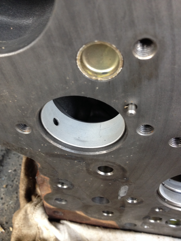

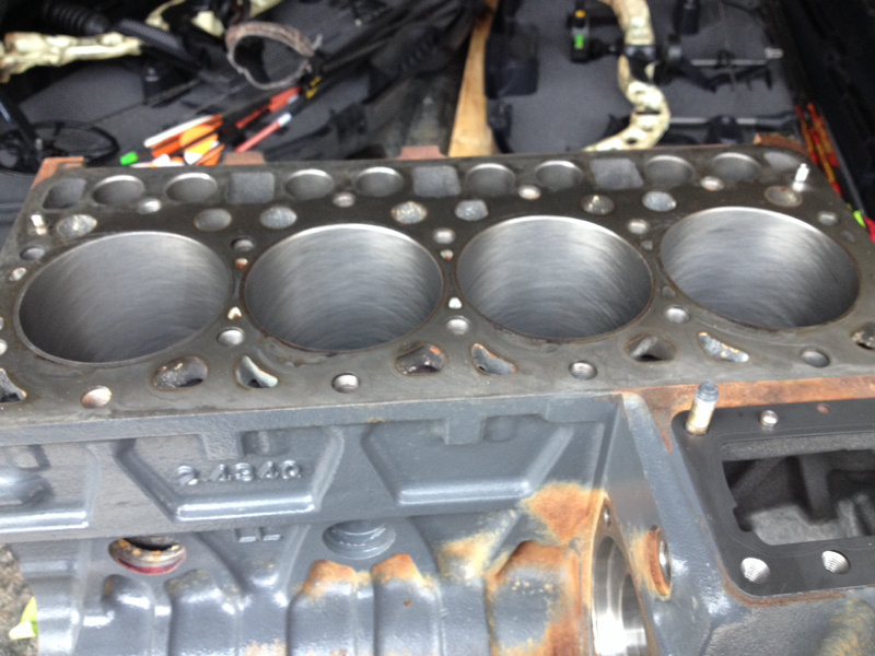

Picked up the repaired block tonight. Looks great.
   / Damaged block installing block heater L5240
#296

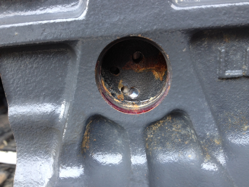

Just one problem that I can see. I might need new a new cam bearing and balancer bearings. They are almost white. I've come too far to let this slide.

Sleeve looks like it belongs there!!! :)

As far as I can tell, just the bearings on the end are this way. Not sure why. The main bearing that stayed in the block looks ok, just a gouge on it that I am not happy about.

Couple more pics..
