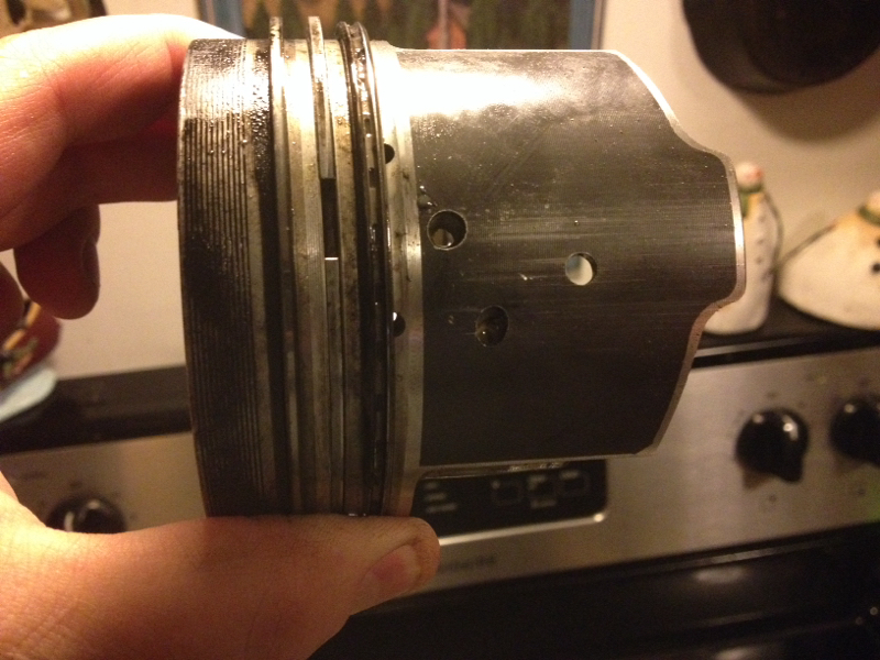

We pulled the pan tonight, along with the pistons, rods oil pump, filter bracket.. The 46mm socket I bought is too shallow to go on the nut on the crank pulley. My neighbor replaced the seal on his L3450 several years ago and I remembered he bought the socket.
We finish stripping the block tomorrow.. I will be replacing piston #4 and all 4 Rod bearings. The antifreeze had shined up the rod bearings on #4 cylinder.
We'll see how the main bearings look in the morning.

You must be he-man to have punched through the plug, jacket, and piston skirt without noticing.
I say that in jest. I easily could be in your shoes. Not that I am he-man or anything, just the occasional **** luck.
Usually when I do something like this it is because I was dumb enough to answer the phone instead of paying attention.

Those are just extra lube holes in the piston skirt. (a high performance modification)
