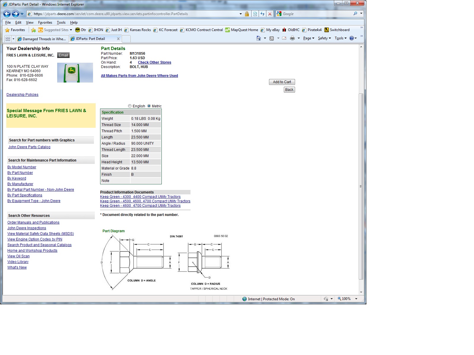

   / Damaged Threads in Wheel Hub - Thread Chaser or Tap - Or Call For Help #13
I bought the bolts from the JD dealer for that $1.63 each. But as hard as I looked online at the JD site and others, I could not find the specs on the bolt. Could you tell me where you found the dimensions?
And thanks for the info.

Thanks for all the ideas. I had not thought of running the bolt in from the back. I did. It tore up the bolt some and left the threads in the hub a bit shallow in places. But I took a new bolt and then ran it in from the front normally. It went in fairly smoothly and took the proper torque. So I think it's good.
But I have learned to check mundane things like bolts and taps from now on. Making it a routine part of my pre-use check. I do learn from mistakes.

A Fastenal place only recently opened in town and I did visit. It is amazing all the stuff they have. Wish they were here when I was fishing for bolts for my old JD and some equipment. They have it all, and know what they're talking about. However, this time I just trotted down to the JD place and bought 6 wheel bolts for about $1.60 each, as I recall. I ran one in from the back to clean out the threads. The threads were visibly damaged, but enough left to hold. So I then ran a bolt in the normal way and it took normal torque... So all is good. Thanks.
