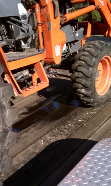

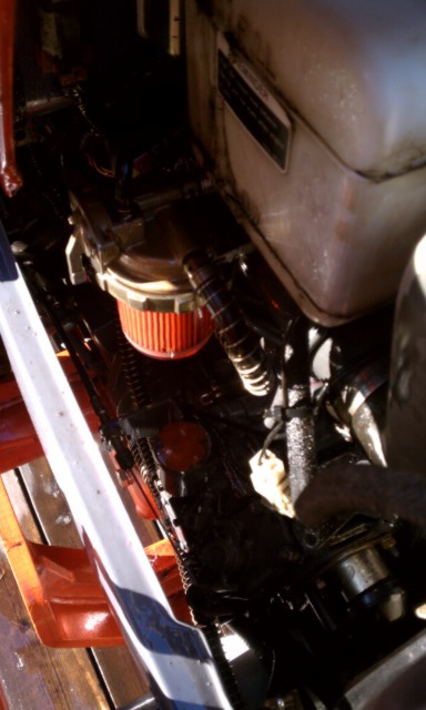

Couple of pics, pretty big leak and you couldn't see the crack until the bowl was removed.

Whoa! I forgot it had been so long. I ran that JB welded fuel bowl until two days ago when it blew out again while mowing the pasture. Good thing I have the part sitting at home on the shelf!
Cut my mowing day down to only 6 hours instead of the required 12.
I now have lttle choice but to install the new milky bowl.
