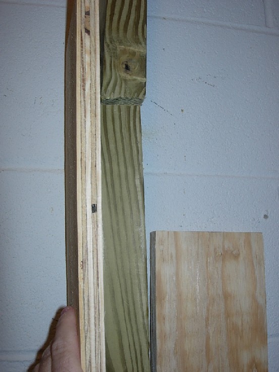

Re: Darn wall isn\'t \"flat\", rip out? other ideas?
Here's what I did, first I uninstalled all the braces & shelf. I then cut the offending stud above where the shelf line is (I preferred cutting it in the middle of the stud but SWMBO has to have a shelf)
   / Darn wall isn't "flat", rip out? other ideas?
#37
Lined up some 3/4" plywood braces

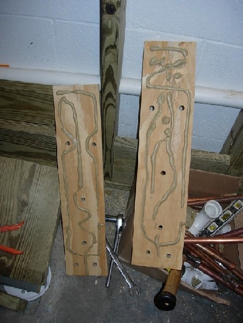

slapped some glue on them...
Interesting note: I didn't think I'd need a LOT of glue so went to by a squeezable tube for about $2.50. Checked the regular isle for the caulk tubes and bought a caulk tube of liquid nails with about TWICE the volume for about $1.80! Probably first time in my life I've been a "shopper". My wife would be proud!
/forums/images/graemlins/grin.gif

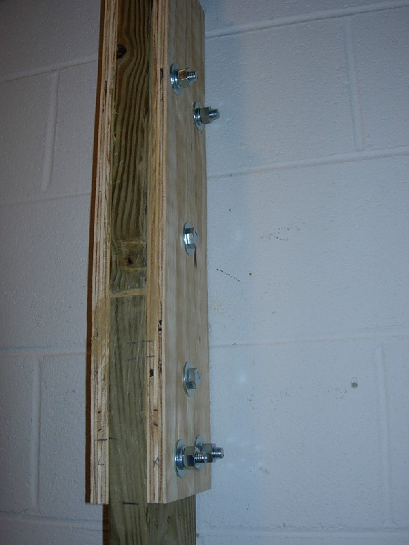

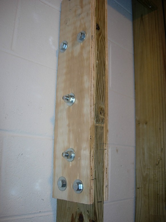

Wife asked if I used enough bolts (1/2")
#40
Of course, I said NO /forums/images/graemlins/laugh.gif
