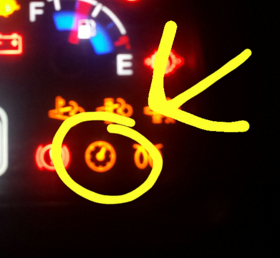

   / Dash Light #16
Anyone know what this one is? It blinks during operation
   / Dash Light #17
<img src="http://www.tractorbynet.com/forums/attachment.php?attachmentid=522868"/>
Maybe RPM too slow or too high? Not sure.
