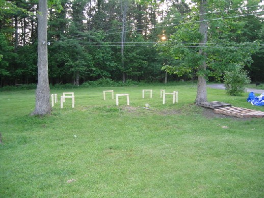

Here's some pics of my progress as promised.
The first is my new site with batter boards set up.

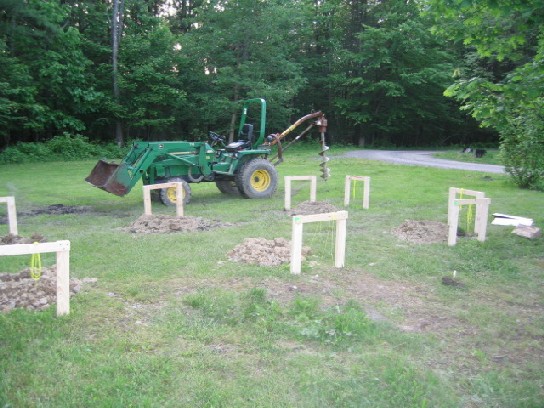

Re: Dave\'s Wood Shelter
This is after post hole digging with my 855 (posing in the back) /forums/images/graemlins/cool.gif

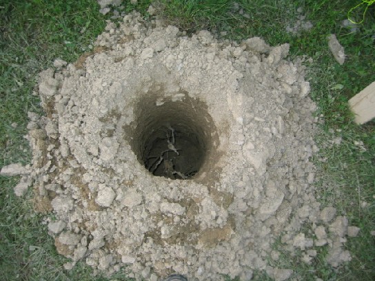

Here is one of maybe two nice holes I was able to dig. Of course, it took me 4-5 holes to figure out the right way to dig.
